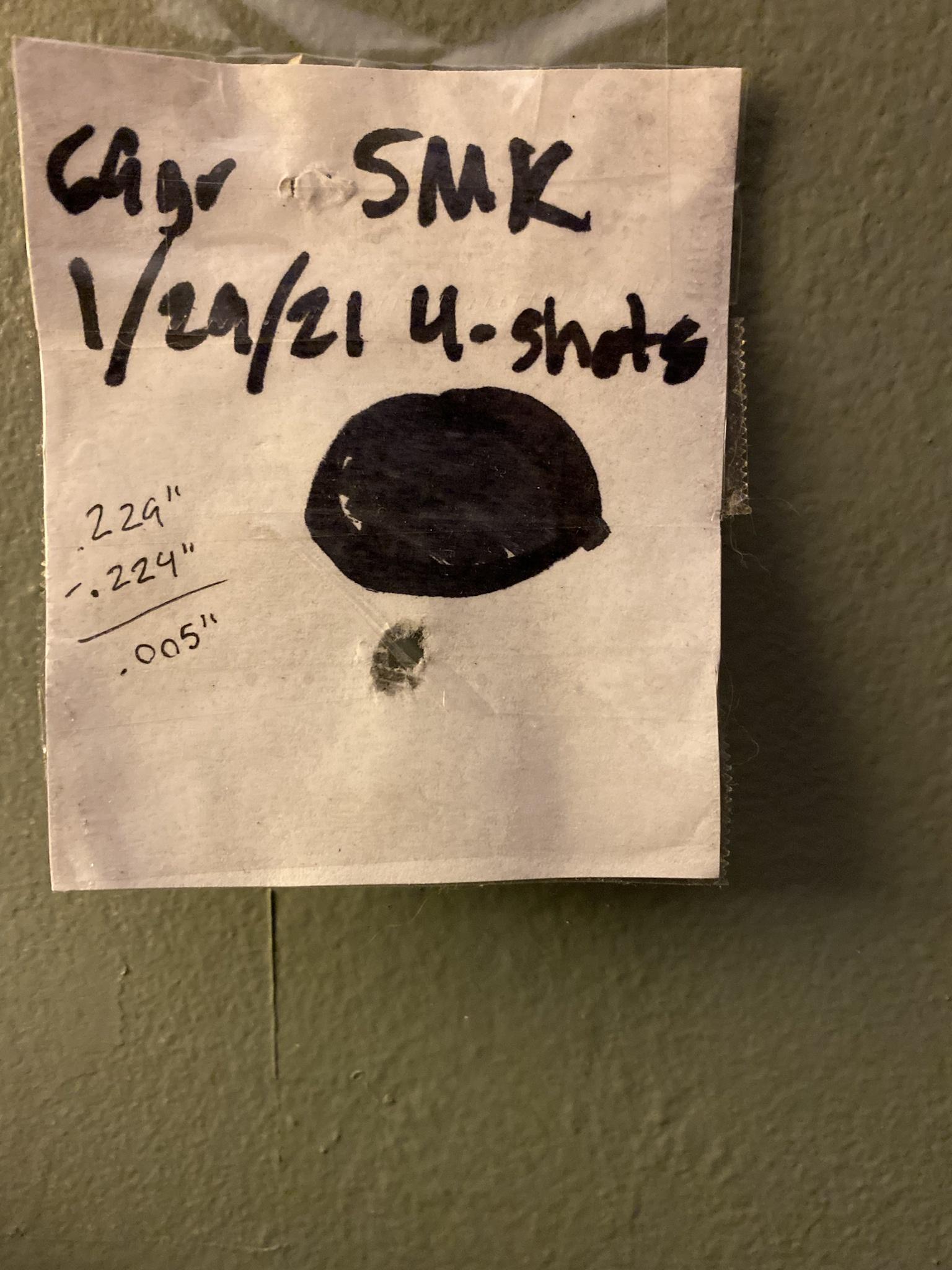

    Best group I ever shot was with the 69gr SMK stuff through a Proof SS prefit. Was the last 4 shots of the box into .005". It's a consistent sub 1/2 MOA shooter and it has around 20 ES under the chrono. The brass is nice as well.
