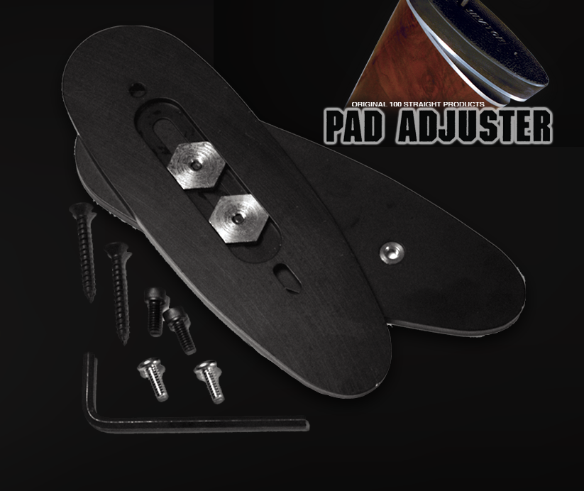

    I know you shoot clays also. Have you considered an adjustable butt, like the 100 Straight one (which I like for thinness if the plates and hard steel inserts where needed).

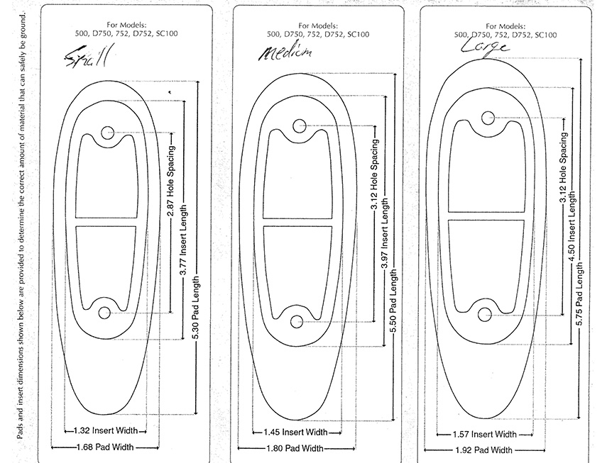

    do you know what the existing hole spacing is in the stock? If it uses a commercial pad like a kick-eze or similar, they are all the same hole spacing and any of the shotgun adjusters should work fine.
    Take care, my friend.
    Well, Pachmayr medium pads have a 3.12" hole pattern so using available commercial adjusters like 100 straight and Jones may well work fine.
    Kick-eeze is also 3.12" pattern so again, standard adjustable butt hardware should fit as the mounting

    And note, on this 100 straight, the bottom "hole" is actually a slot to allow for some variation in mounting hole pattern. I love the 100 straight product because its not two fucking 1/4" plates. They are thinner plates with hard steel inserts and I have run one on a skeet gun for well over 50k rounds and never had an issue.
