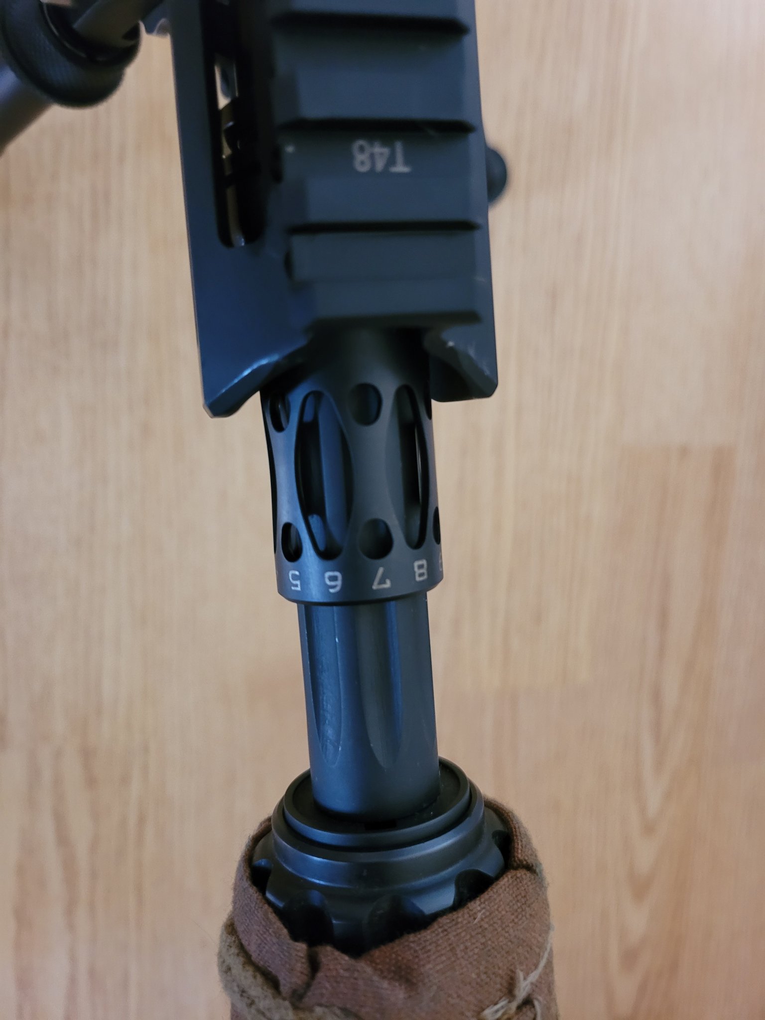

    Another vote here for the Riflespeed. I had the SA on a 20” barrel with a long hand guard. Was incredibly difficult getting the hex key into the adjustment screw with a hot can on the end. It worked great once adjusted though and as long as I used the same ammo, it would have been fine. But I wanted the ability to adjust to other ammo so I switched to the Riflespeed and am very happy.

    Im not sure I understand your question... There is no modified bolt... Your removing the gas key from your existing "carrier" and installing the RCA Adjustable Gas Key in its place on your "carrier.".....
    You could surely move the entire BCG from one rifle to the next... but the gas settings is not going to be the same, you would most likely have to re-adjust the gas key setting when you move it to another rifle..... You could just buy a $39.99 RCA adjustable gas key for each of your rifles so you can set gas for each rifle and not swap between them and have to keep re-tuning...
    That's what I meant. Moving the carrier, not bolt. :giggle:
