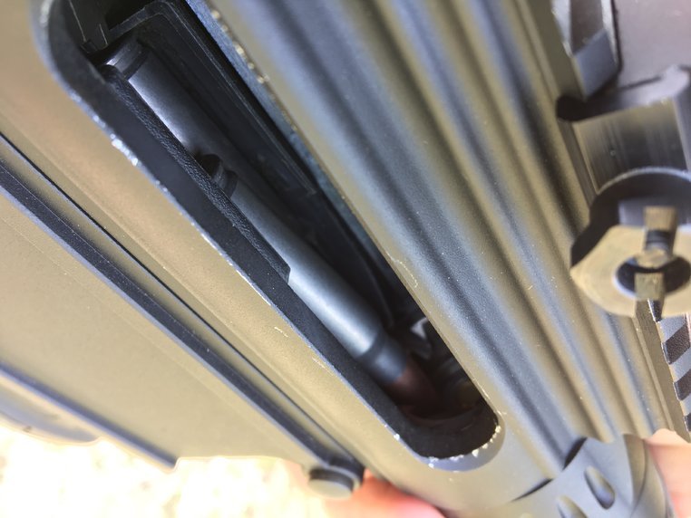

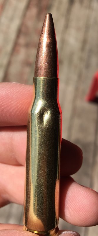

Is your rifle malfunctioning as it is now? If so, what's it doing? What are you trying to fix with an AGB? Can you give more details about your setup?
Scott
Here'a what happens almost every time the rifle tries to feed another round. I have also purchased a Sprinco Orange heavy buffer spring because of my suspicion of my setup being undergassed. My setup: Dpms .308 Sportical, 18 inch mid length .875 ballistic advantage Hanson barrel, stock BCG, .875 low profile gas block that came with the barrel, Stock buffer carbine spring and buffer.

A heavy buffer spring is the opposite of what you want if it's under gassed. Which, I can almost guarantee you is not the case now that you say it's an AR10 in 308 with a mid length system. Its much more likely that it's severely over gassed. An adjustable gas block will help with that situation, unlike an under gassed situation.
Ok haha half of the forum is telling me it's undergassed and the other half is saying over gassed. So I bought both, will see which works and which doesn't. I'll update this post incase others have a similar problem.
