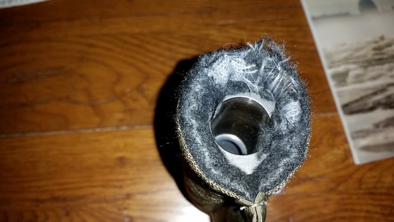

Just a heads up .... I have 2 SUperlatives and they work very well on my MK12 and AR10 ... but ....
If you are using a suppressor cover you will want to run the Superlative as a restriction (adjusted more to shut off gas) rather than as a vent. I found it out the hard way as the venting gas tore up the back end of 2 TAB Gear covers. Now for clarification, I am using Ops Inc suppressors that come back over the barrel a few inches, so the can sits closer to the gas block.
