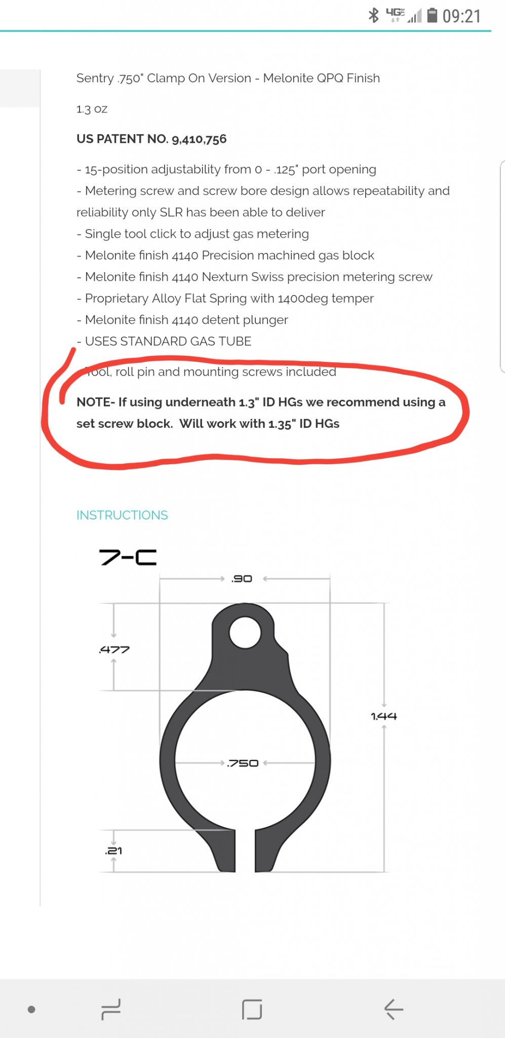

Im not sure what I have, I think its a Syrac on 3 rifles. I need another one now, but I need to make sure whatever I get is going to fit under a KMR or Midwest Ind rail.
1.) There is a huge difference between the older set-screw style adjustable gas blocks (AGBs) like JP's and the newer detent style like SLR and Superlative Arms (SA). The newer detent versions are massively more reliable and easy to use than the set screw versions.
2.) Superlative Arms and SLR Rifleworks are the two kings and really the only ones I'd buy as of now. The major difference is the bleed off of the SA. The bleed off doesn't cake barrels. It is a touch quieter with a suppressor. It doesn't gum up (although my SLR blocks don't either if I just click them one up one down every few thousand rounds). But on the flip side, if you are using a very high gas situation like a 14.5in carbine gas .308 barrel, or a 7.5in pistol gas 5.56 barrel, then the SA block will not be able to bleed enough gas to function properly. So in those edge cases, go SLR hands down. Otherwise, the SA block gets the nod, but really you cannot go wrong with either.
3.) Syrac--->SA basically. But SA has an improved design now with their bleed off blocks.
