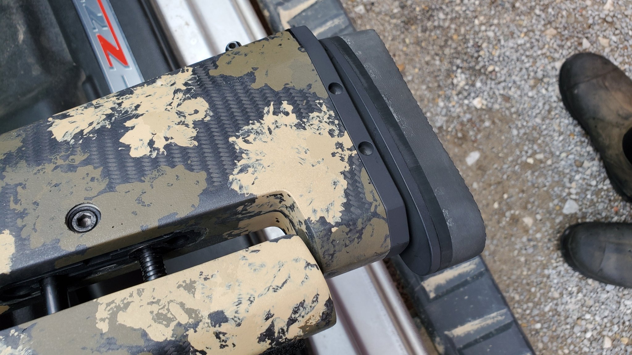

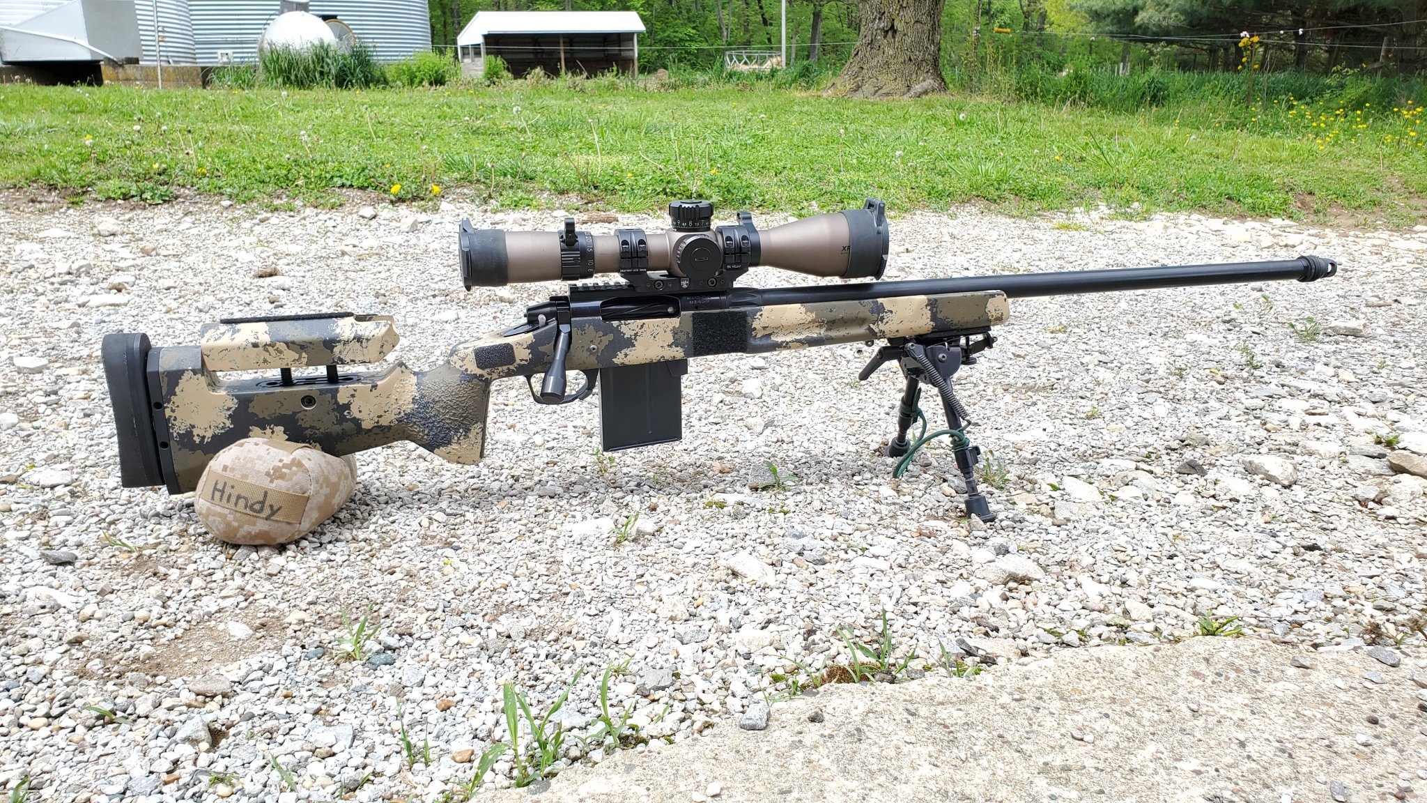

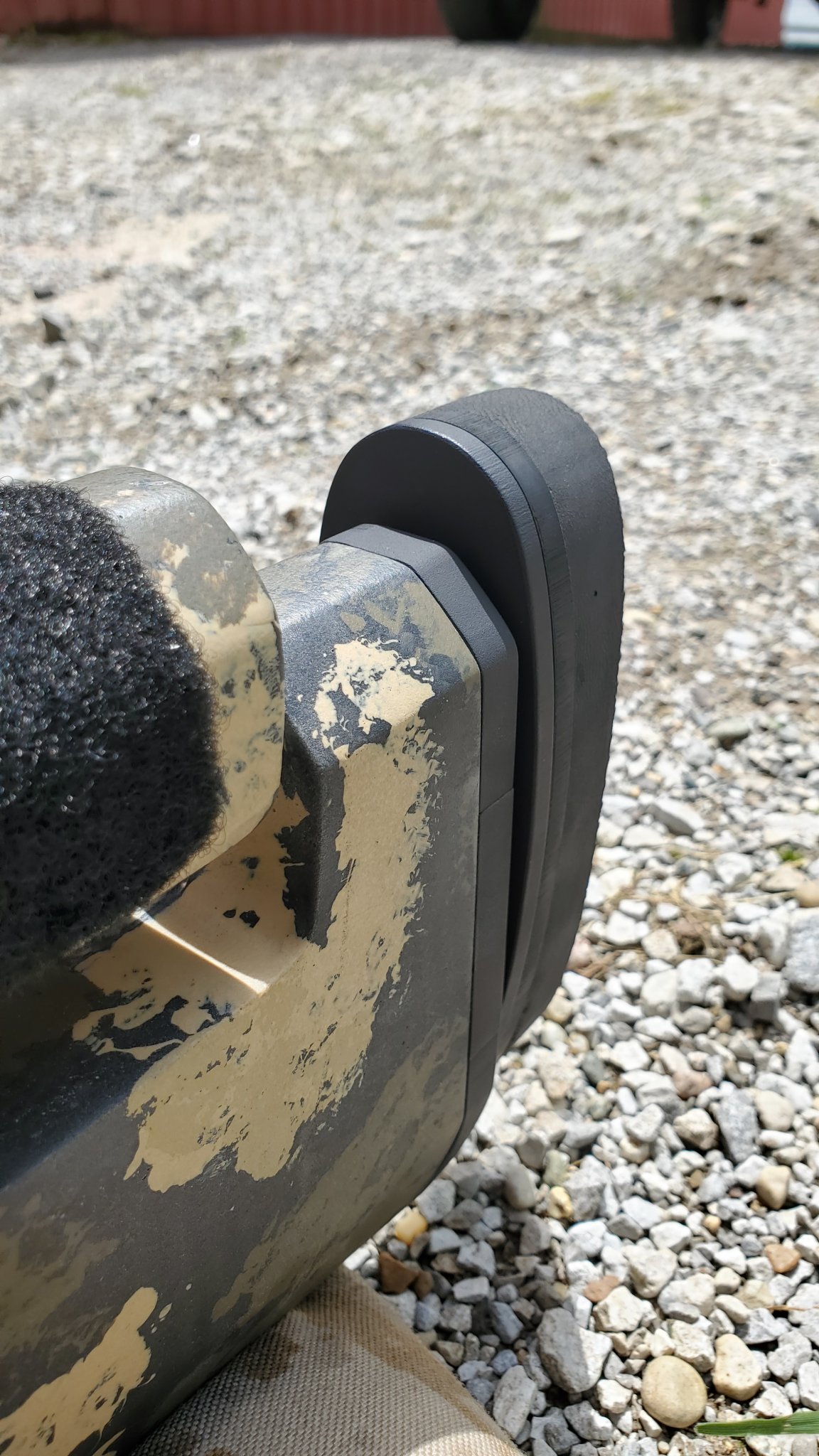

I did it. Yes it had to be shaped to stock profile. I located where the screws needed to be, drilled and then glued/screwed brass threaded inserts in place. Once cured I mounted plate and scribed a line to grind up to. Then just took my time and fit it, alot of putting on and finding high spot and grinding. I did not grind aluminum with it on the stock, it gets too hot. I used a belt/drum sander with 60grit. A med pachmayr decelerator pad had perfect hole spacing for rear plate. Since it wasn't going to be aligned with stock plate, I wasnt worried about matching shape. I just belt sanded rear plate to match pad, as it was out of the box.
Thanks! I'm doing it.
