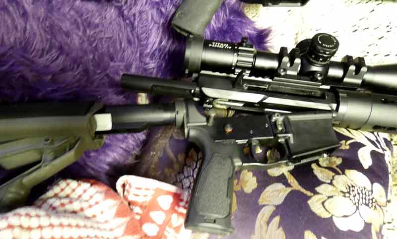

    So I have abandoned bolt guns cause I just wanna go fast now, and I am just not into PRS matches anymore I been wanting to do field matches as a second shooter. Cause I wanna go fast.
    So I have built 2 gas guns one in 223 and 6 ARC.
    Seekins DMRs is in 6 ARC it’s waiting on final assembly
    223 Lego build with a bunch of parts.
    But I have noticed that the buttstock on the 223 have a good bit on side to side play in it. So I am debating on switching to a fixed stock.
    Wanted to ask anyone perspectives on a loose buttstock for a fixed one and if it had issues on POI shifts from zero?

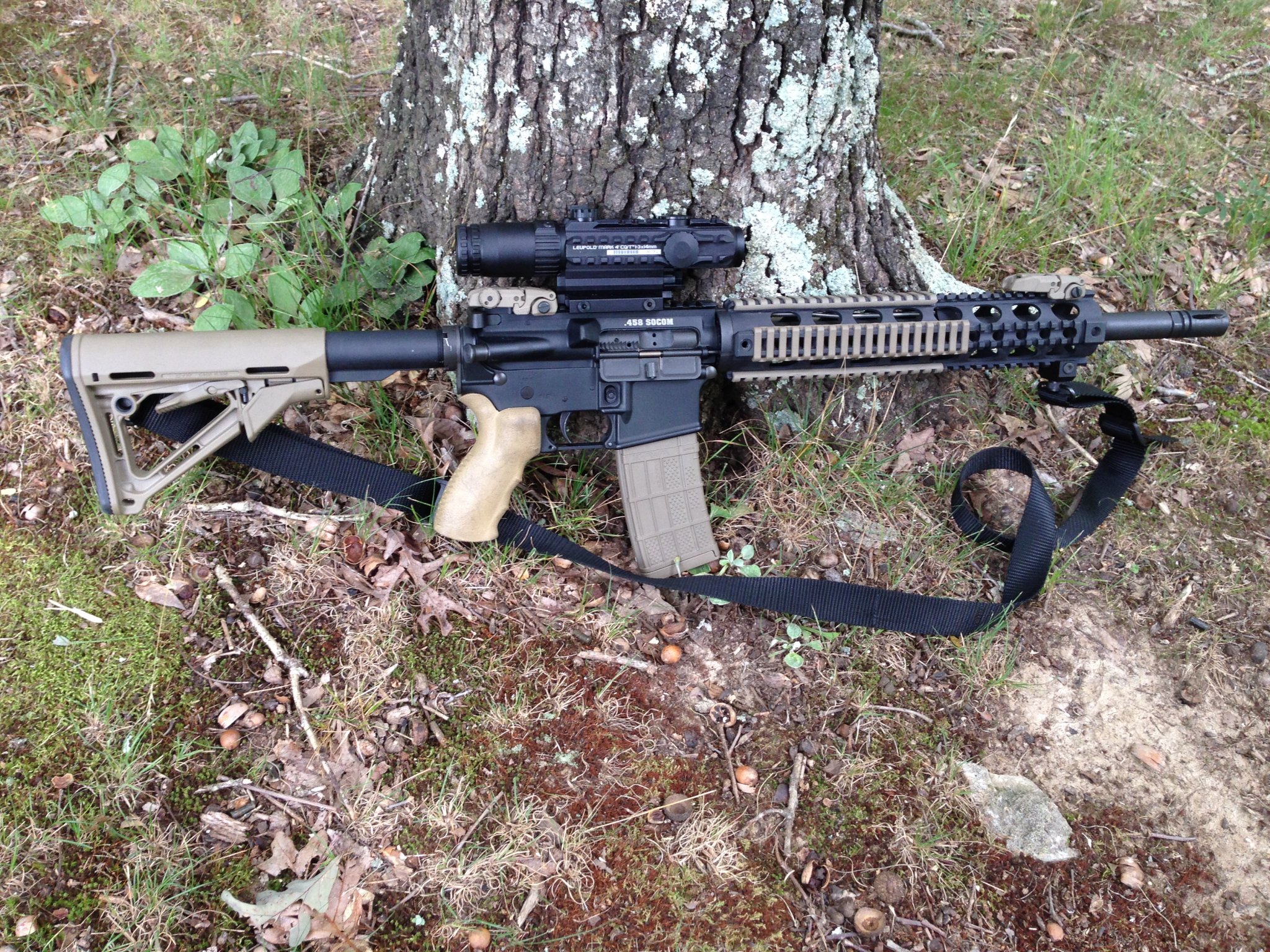

    Mag-pul ctr stock . it will lock up tighter than a drum plus you can get a cheek riser if needed . I have run one on a 458 socom for 14 years .

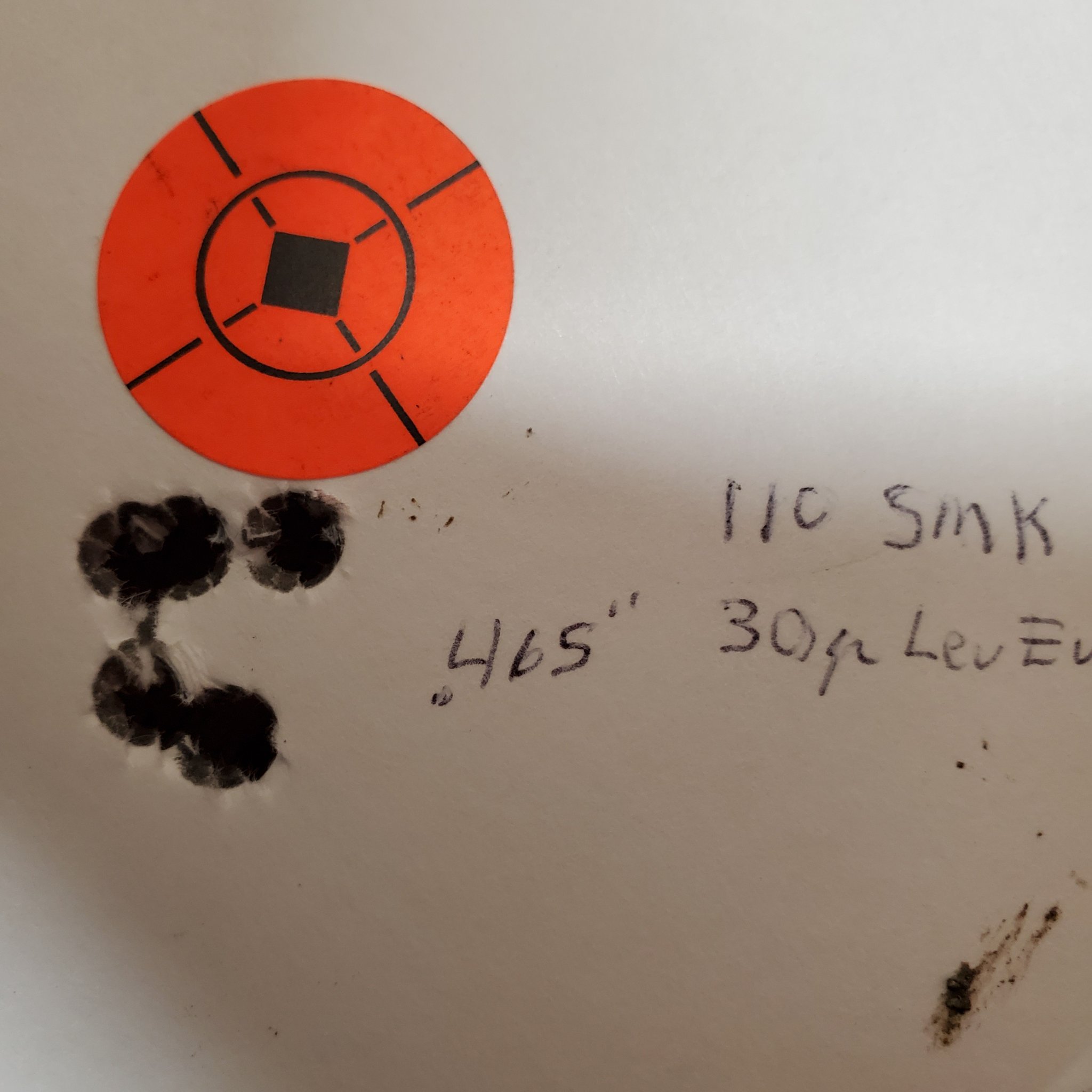

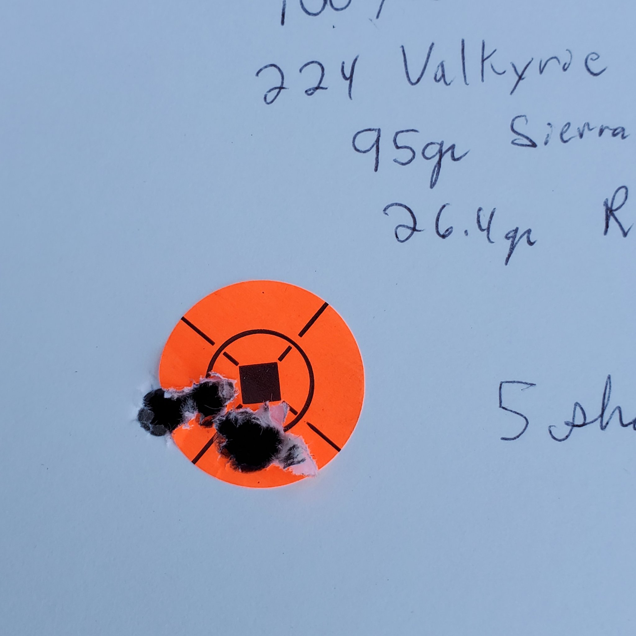

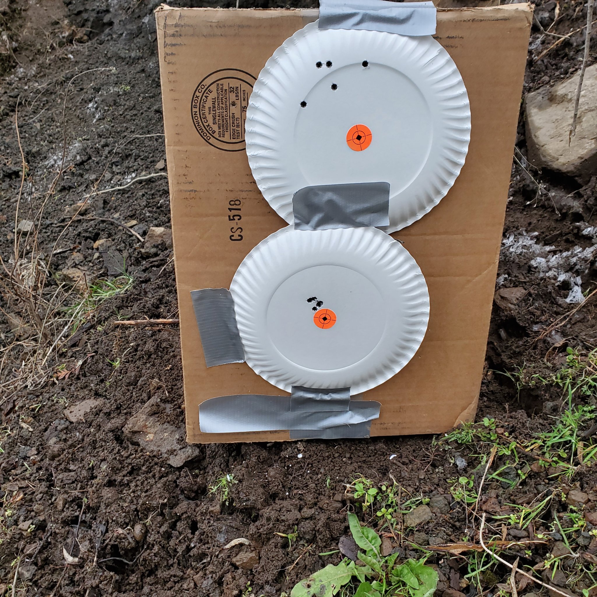

    I have both adjustable and fixed stocks in the same Proof Research 18" barrels, both chambered in 6 mm ARC.
    The adjustable stock rifle has little play in the stock, a bit lighter maybe a pound, And slightly More Accurate than the fixed stock.
    My preference is the lighter adjustable stock...and it's slighty more accurate of the two.
    The stock will make little to no difference in accuracy .... it's the shooter.
    So choose the one you like and don't worry about it.
    I only have 2 fixed stocks and one is not in use....all tbe rest are adjustable.
    Most are capable shoot 1/2" 5 shot groups, and sometimes less.
    Notice one target labeled adjustable stock, which slightly out shot the fixed stock with a higher power more expensive scope.
    The last photo is why I have 2 Proof barrels, never buy a complete upper to get into a new caliber.
    This was a mediocre barrel in a complete Areo upper, 2.5" 5 shot groups, with the same match ammo on the same day.
    Get a quality match barrel, and don't sweat the stock...get what you like, the stock fixed or adjustable make literally no difference in accuracy, when I shoot them. My adjustable was slightly more accurate in 6mm ARC ....but it's probably the barrel.
