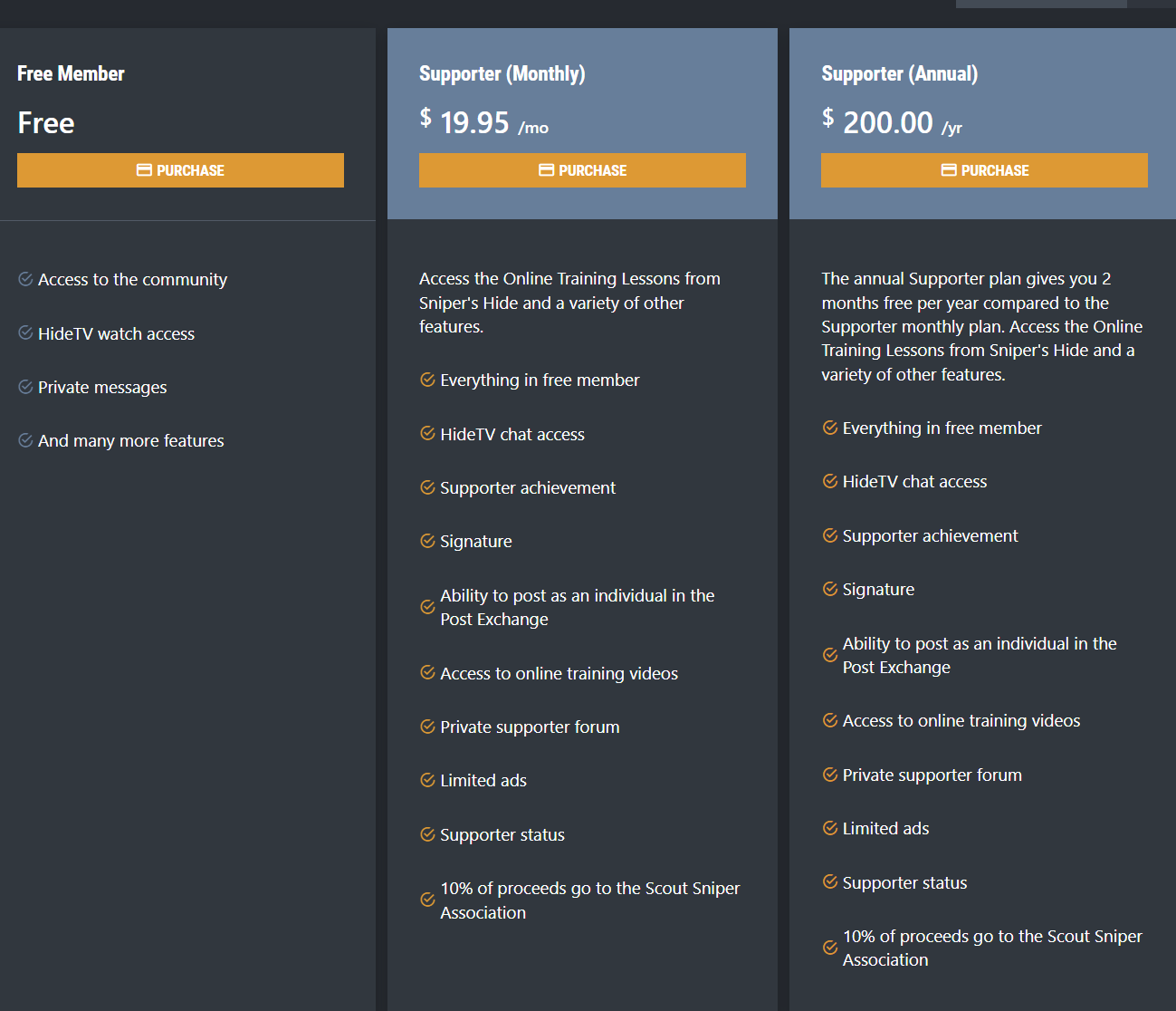

@javierortega72 https://www.snipershide.com/shooting/account/upgrades/

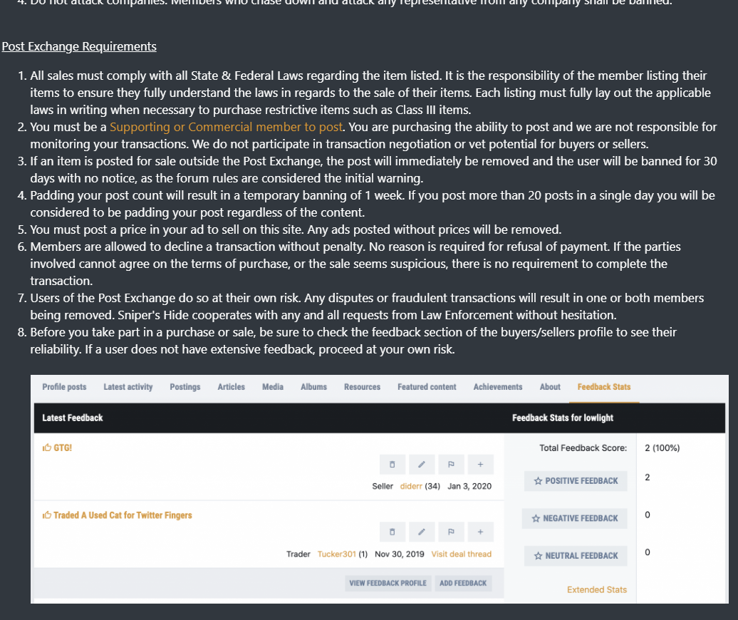

https://www.snipershide.com/shooting/threads/2021-snipers-hide-forum-rules.6920466/
https://www.snipershide.com/shooting/#post-exchange.20
