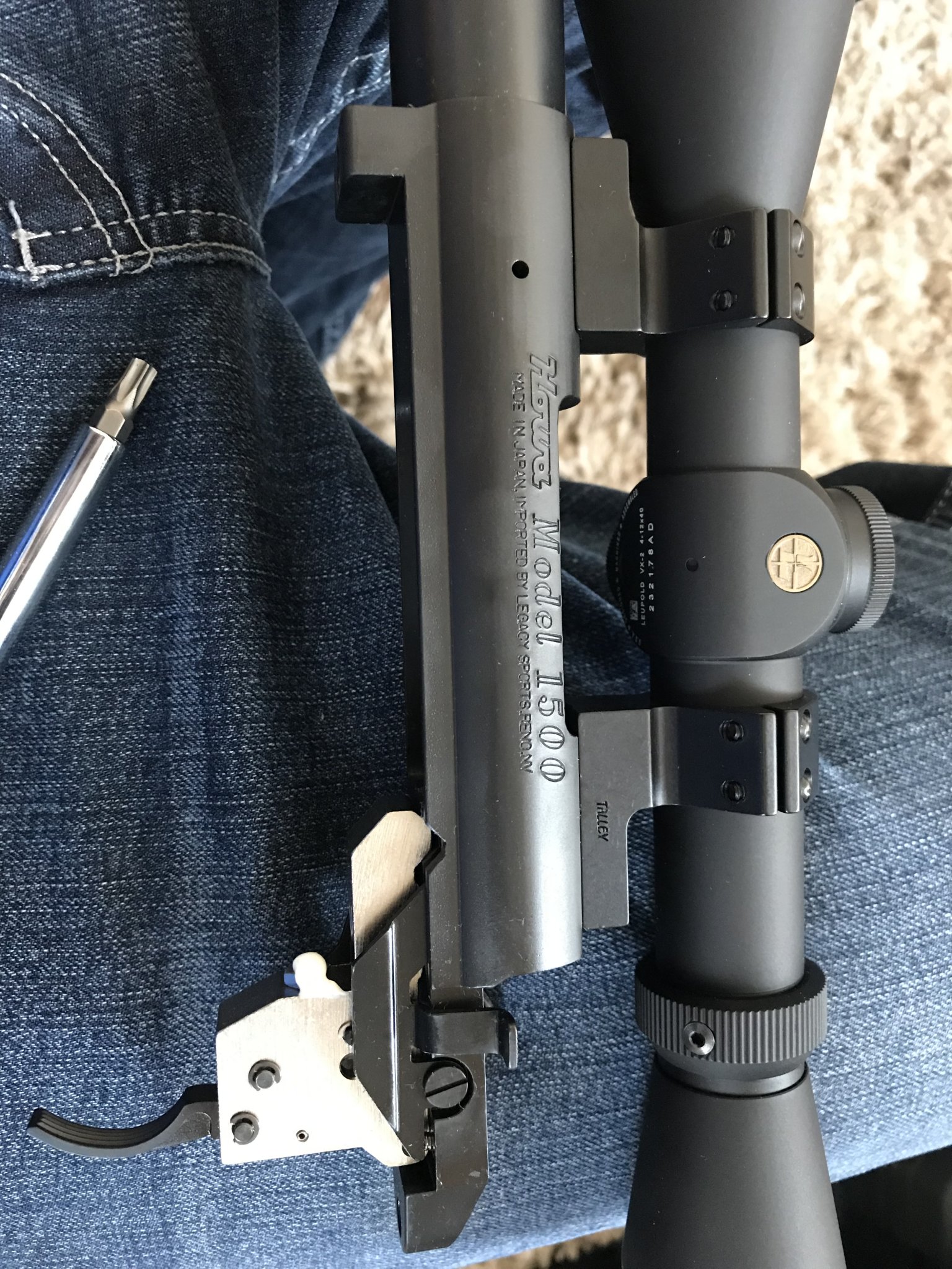

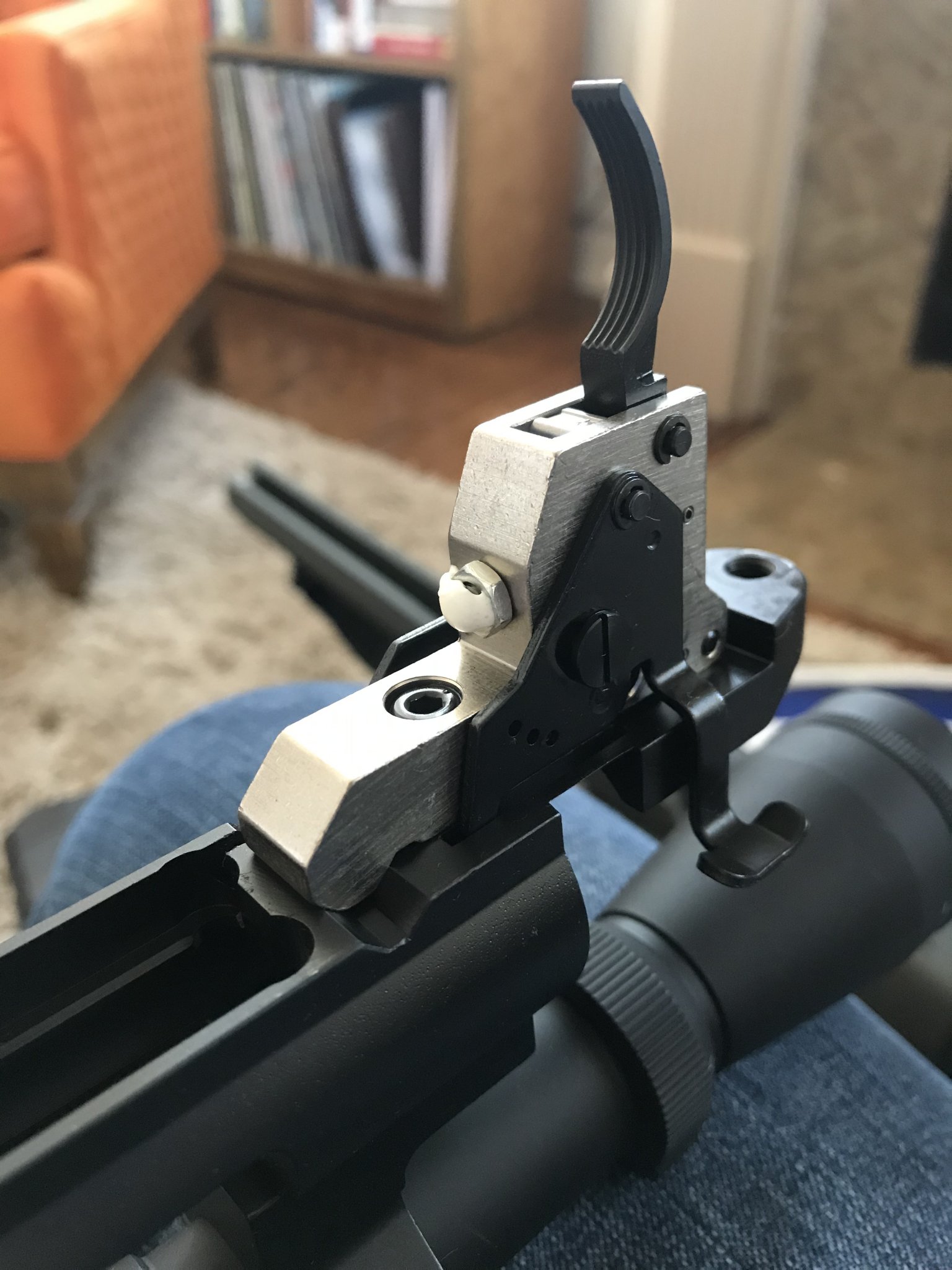

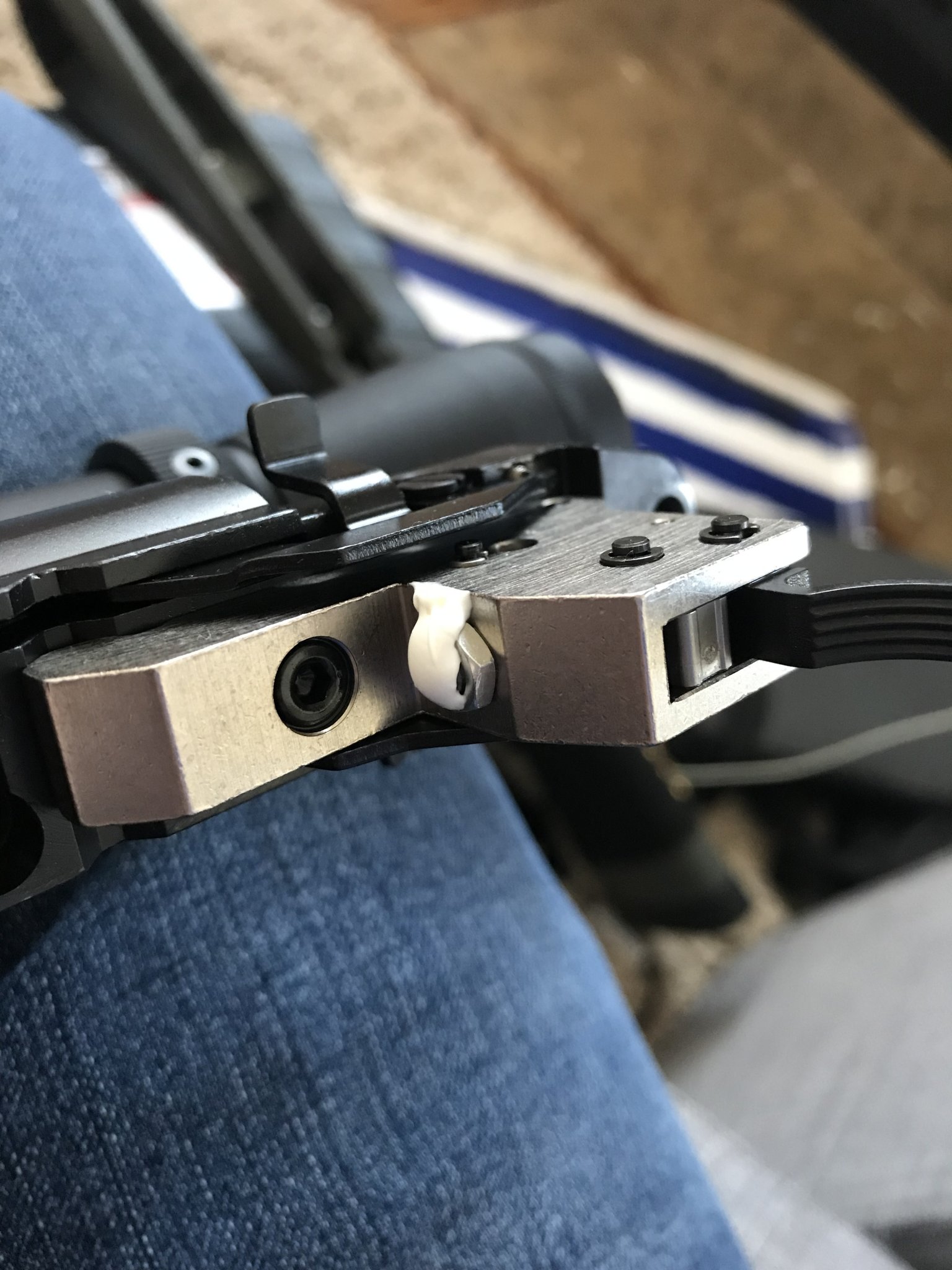

Just did some trigger work on my lightweight Howa Mini in 6.5 Grendel (really handy deer rifle). Trigger from the factory was EXCELLENT in all ways except for pull weight; while I want something in pounds rather than ounces for a field gun, mine was pulling over 5lbs and I wanted to trim one or two off that.
Didn’t do anything fancy/major, but it couldn’t have been any easier. Removed the white goop, backed off the nut, backed the screw out all the way then got two full rotations into the threads, locked down the nut and sealed it all back up. Average of 5 pulls put me at 3.25lbs (about 200rnds and maybe 300 trigger pulls on the rifle since it’s pretty new). Perfect.
Pics of the goop. This really couldn’t have been easier and it retains that excellent factory break:

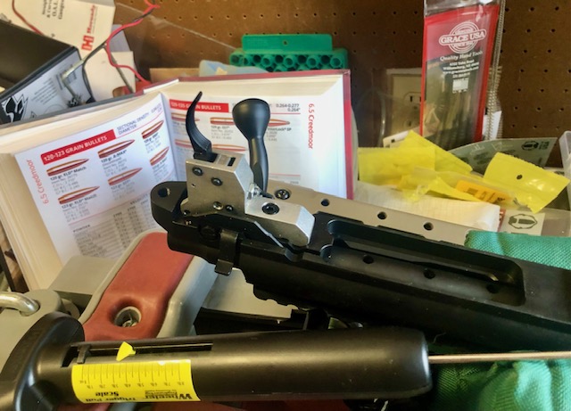

What is the trigger weight from the factory? No mention of it in the instructions.
My heavy barrel action build 6.5 scaled 3.3- 3.8. My .06 Vanguard is 4. Planning to adjust both Or replace the Creedmore. I ran the adjustment screw in and out several turns and did not change the weight much.

Try cutting half a coil off. Did mine, then another quarter or so coil after than. It's a sweet trigger now. I would only do a half coil at a time though.
Reactions: kodak45
I got the lighter spring from AUS for the -06, dropped it in ( Not) it took me several times reviewing some youtube how tos to get the angle right.
Breaks nicely at 1.9# same as the Timney in the 6.5. The HACT still has 2 stage take up while the Timney one stage moves very little before the break.
