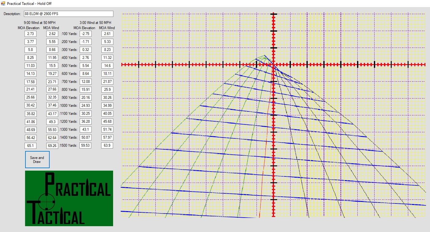

I started noodling around writing a program to help visualize the W and E hold offs for pretty much any distance.
This is just an early development concept of the program.
Each blue line is 100 yards
Each green line represents 10 MPH of wind.
The red line represents the zero wind spin drift line.
This obviously does not compensate to the minute for weather but wind holds should transfer nicely as well as the elevation offset for wind speed changes.
The values can be populated according to expected local weather parameters, to make it more accurate.
A zoomed in version can be printed for each stage and the targets drawn in to scale using the current wind call.
I started noodling around with a program to help quantify the W and E hold offs.
This obviously does not compensate to the minute for weather but wind holds should transfer nicely as well as the elevation factor for wind speed changes.
My vision is that a zoomed in version can be printed for each stage and the target drawn in to scale using the current wind call.
More of a visual aid than anything.
1 mil of spin drift at 1200 yards?
1/2 mil of Aerodynamic jump with 40 MPH wind?
What program produced those predictions?
Does this program run on an iPhone by any chance?
No, not yet anyway. Again, still flushing out an early design at this point.
I'm really just working on it for myself and a few friends.
I don't plan to sell it commercially unless I find there's a significant demand for it.

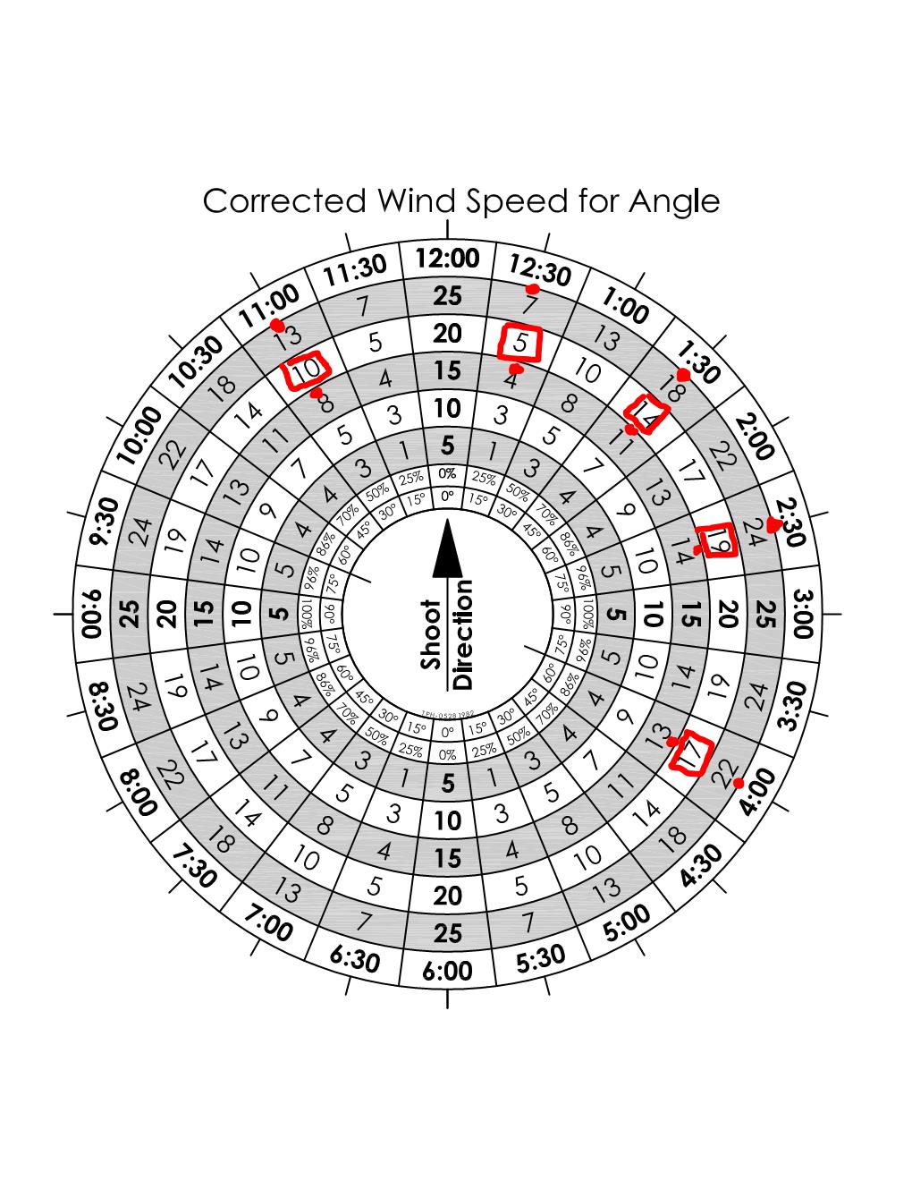

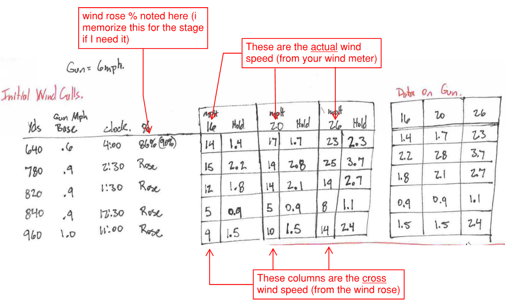

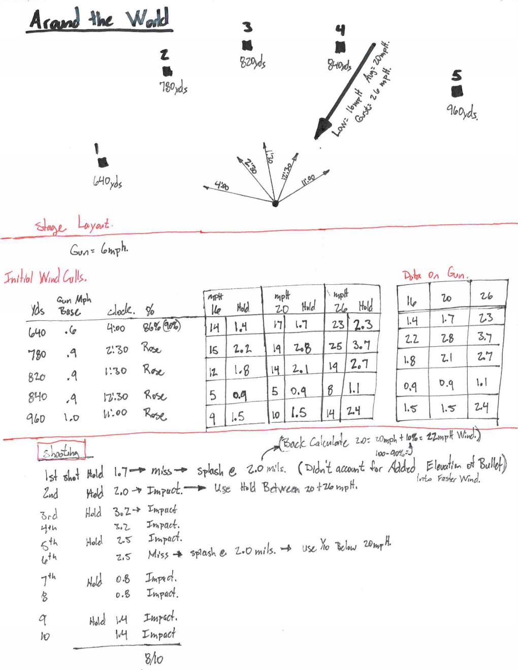

I shot this stage too. It went something like the scenario below. I don't remember the yardages and target angle but this is close. I may have even written out more wind speeds than in this example below. The miss on shot 6 would simulate a changing wind. I wrote this our on paper so you could see my math process.
Thank you for the information. That was very helpful. One question, can you explain the “back calculate 2.0 = 20 mph x 10% = 22 mph wind” note? Thanks

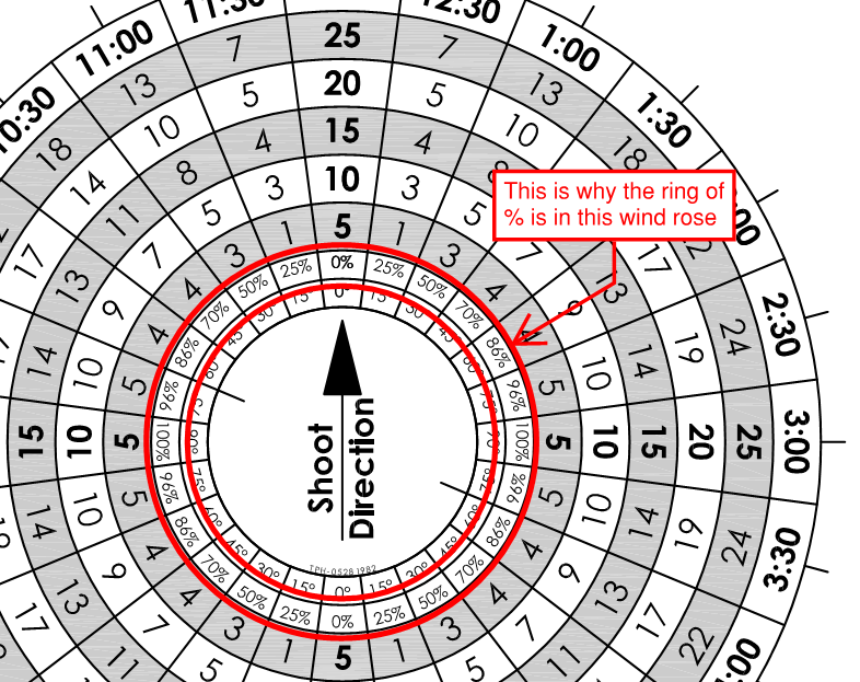

Sure. (with delight because I love math)
Note - When shooting this stage I would probably not actually do this step because I have enough data written out on the dope card to skip it. If I had only one wind speed written, then I would need this step to transition to the next target.
We have 2 winds we can talk about. Actual wind speed and Cross wind speed. The actual wind speed is the the speed your wind meter gives you. The cross wind speed is the corrected speed from the wind rose due to the angle you're shooting in the actual wind. This "back calculate" is finding the actual wind speed for this stage. If I were shooting a troop line in a straight line I would not bother with doing this, but because this stage has very different angles to the wind finding the actual wind speed can help when transitioning to other target directions.
I use the gun MPH system to do this. At 600yds (or 640 in this stage) my hold is 0.6 for each 6mph of CROSS wind. Once i shoot the first shot I can figure out what the cross wind is but I want the actual wind speed for this stage too.
Hold - Speed (at 640 yards)
0.6 - 6mph
1.2 - 12mph
1.8 - 18mph
2.4 - 24mph
(Because this is a 6mph gun, at 600yds the holds and mph happen to match up (0.1=1mph))
Cross wind = hold / 0.6 x gun mph = 2.0 / 0.6 x 6mph = 20mph
Actual wind speed = Cross wind speed / angular correction from the wind rose = 20/90% or 20/0.9 (I rounded 86% to 90% for easy math on the stage) To make this easier I work this math the other way. Rather than trying to divide by 90% (0.9) I add the remaining % to the cross wind, in this case its 10%. 100%-90% = 10%. This is where I get the 10% from.
so
Actual wind speed = 20/.9=(calculator) 22.2mph
or
Actual wind speed = Crosswind speed + (Crosswind speed * remaining %) = 20mph + 20 * 10% = 20 + 2 = 22MPH (actual wind speed)
For this stage, in my brain, rather than do the "back calculate" I would figure a % between 20 and 26mph holds. 2.0m at 640yds is half way between 1.7 (20mph) and 2.3 (26mph). On the next target I would hold halfway from 2.8 to 3.7 (1 mil so half = 0.5) = 2.8+0.5=3.2
