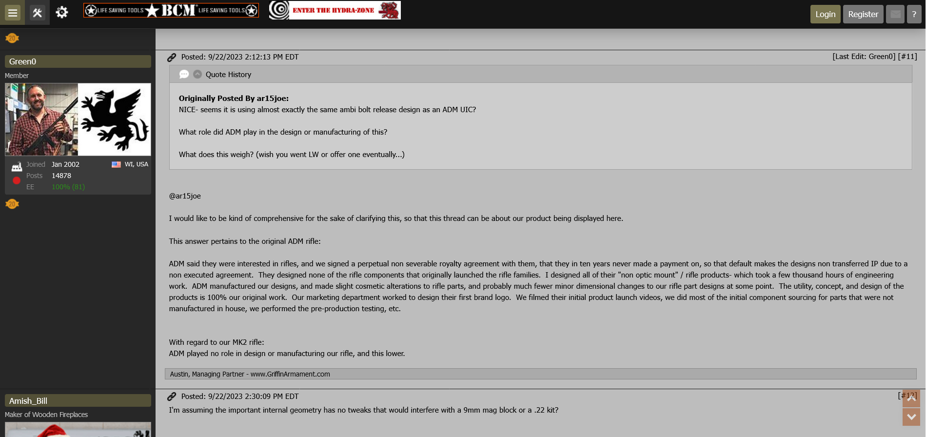

I thought Griffin and ADM "made / designed" the lower together... but ADM never paid Griffin for the work ?
https://www.ar15.com/forums/AR-15/-...eceivers/124-782550/?page=1&anc=bottom#bottom
I don't know all the specific's... and respect both companies... but ?
And Griffin Arm. podcast...
Screenshot 2024-09-17 at 07-40-47 New for 2023 Griffin Armament MK2 Forged Ambi lower receiver...png
