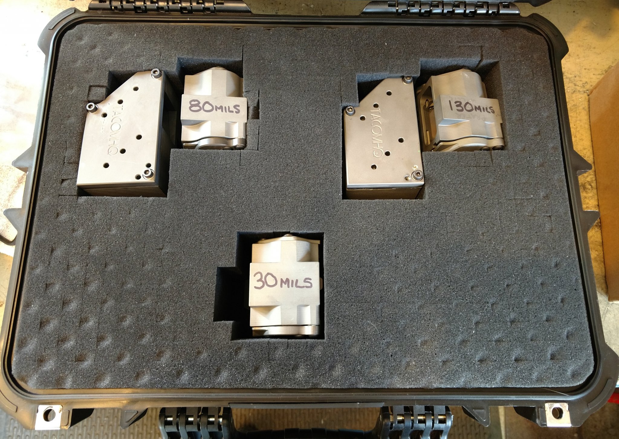

TACOMHQ - Scope Attachment

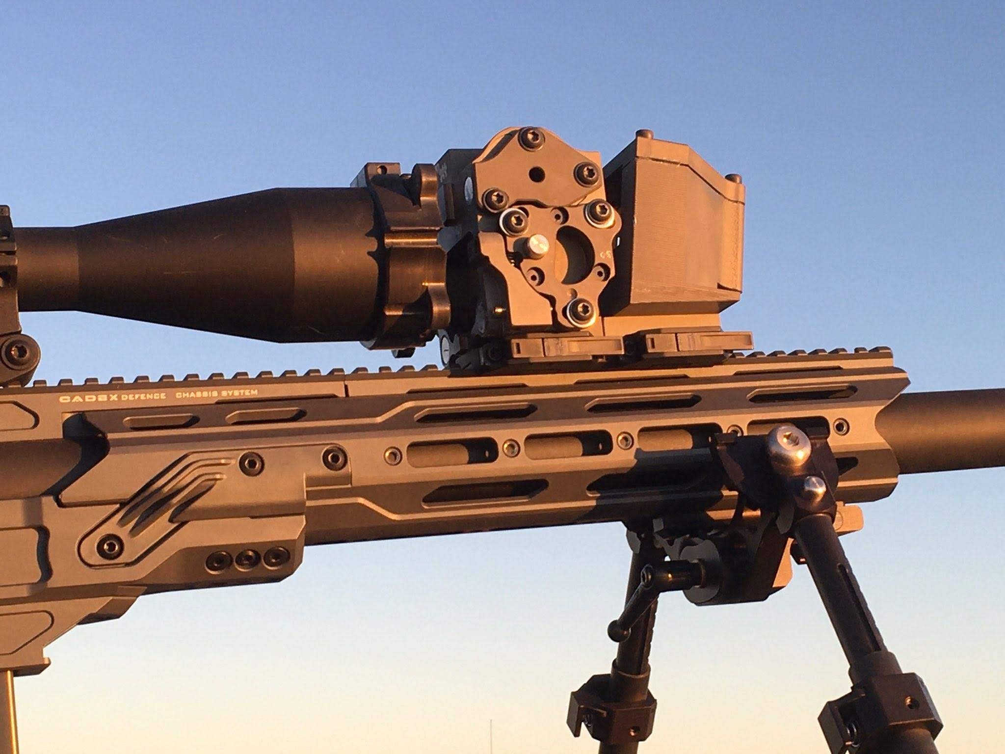

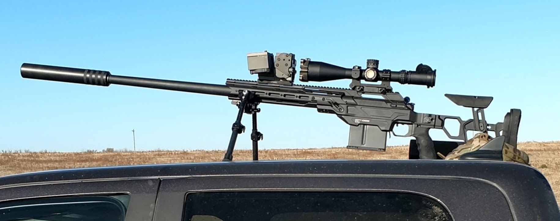

I do run ERA-TAC adjustable mounts on all of my rifles, not to use them for elevation adjustment but because I got sick of constantly not having the correct cant mount for a specific application (get the most out of your elevation turret).
My Cadex .375 has a 40moa cant base. The ERA-TAC gets set to 20moa to achieve 35.5 mils of elevation adjustment and still have a 100 yard zero. A 30 mil CT gets me to just beyond 2 miles. Everything beyond that becomes its own setup based on the yardage because elevation changes so quickly after that. Hence having a CT setup for 2.5 and another for 3 miles.
I have since switched optics on this rifle to a 5-25 Tangent because of clearity at distance. I lost almost 10mils of elevation adjustment in my turret, but make up for it by re-calibrating 10 more mils in each of the CT's.

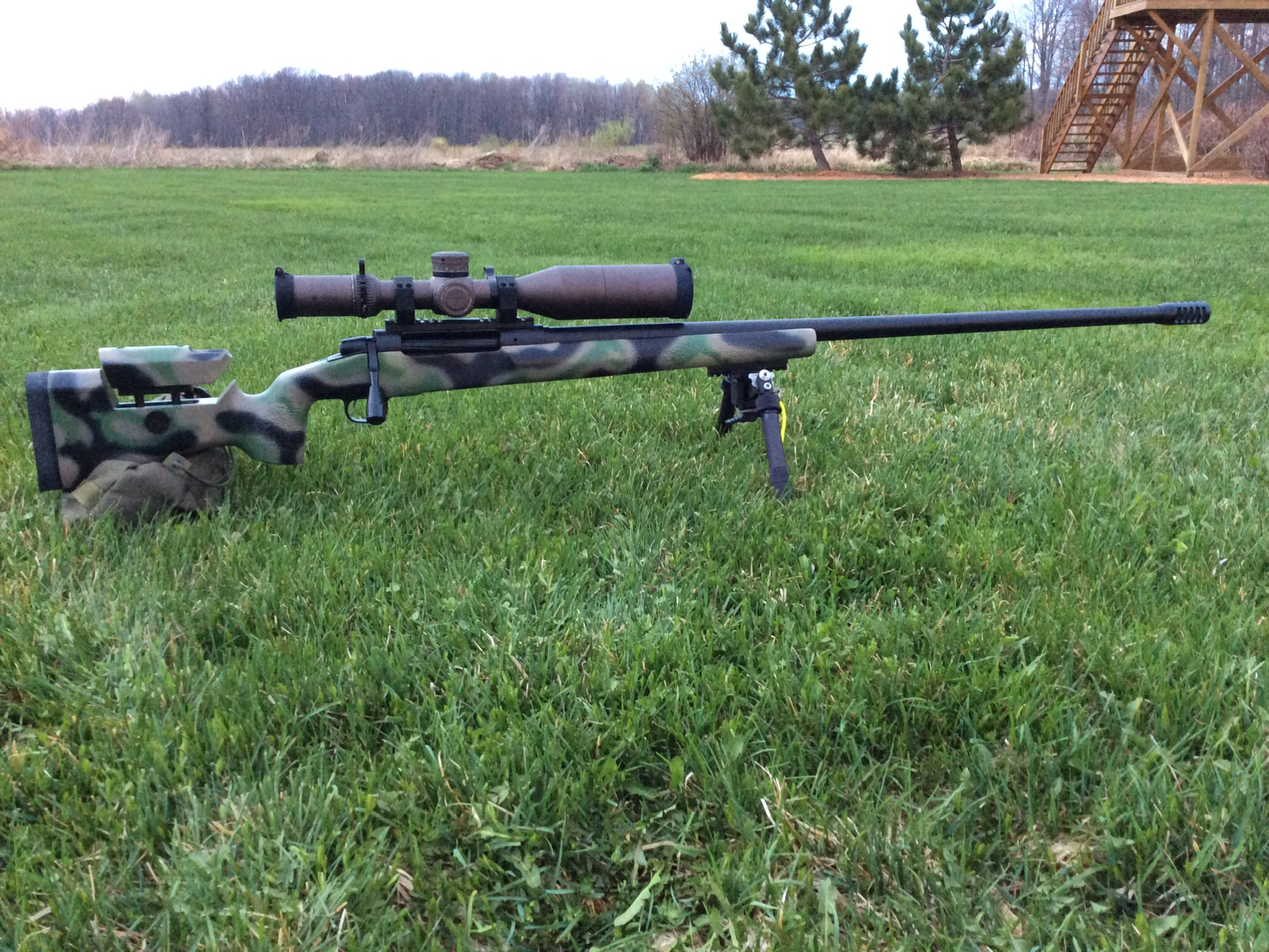

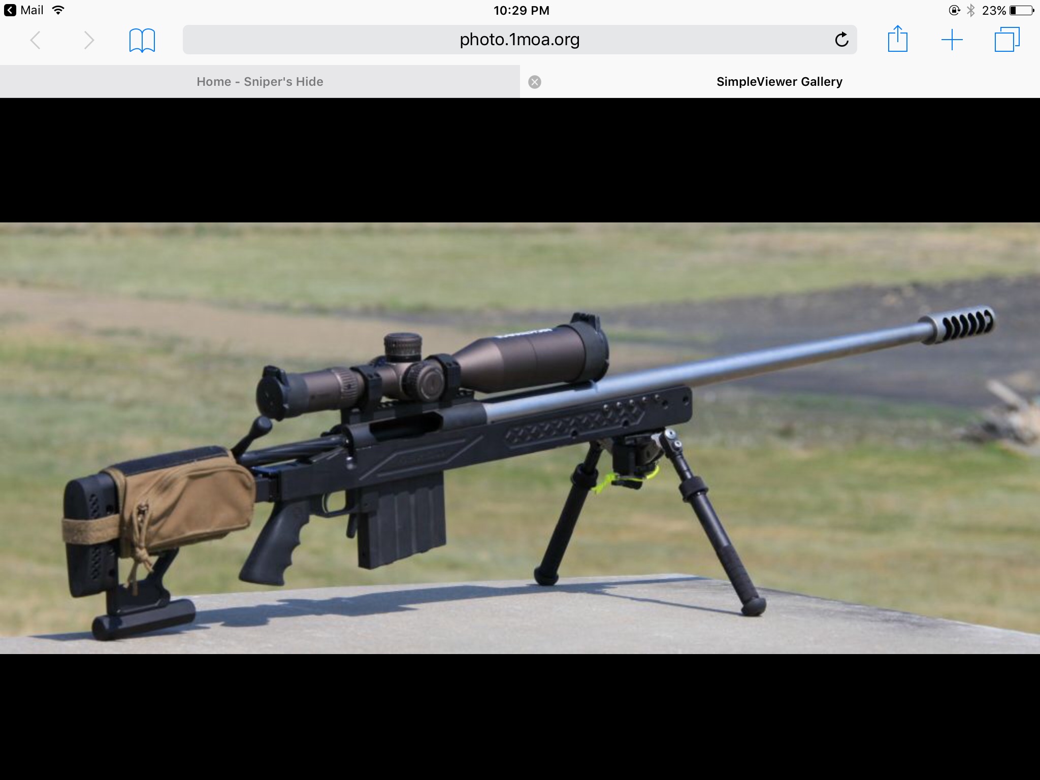

A couple of our 375 Snipetac - 2 mile rifles have been set up with 80 moa rails and the Vortex Gen II 4.5-27x56 scopes. These have done well in the ELR world if your looking for something that is rock solid, no moving pars and gets the job done. Also if needed they can still aim at a dot at 100 yards and hit it when asked. They both give around 47.5 mils of usable elevation aiming points or corrections that get you to the 2 mile targets and under.
Here’s a picture of one of the rifles - to reference the system
Cheers

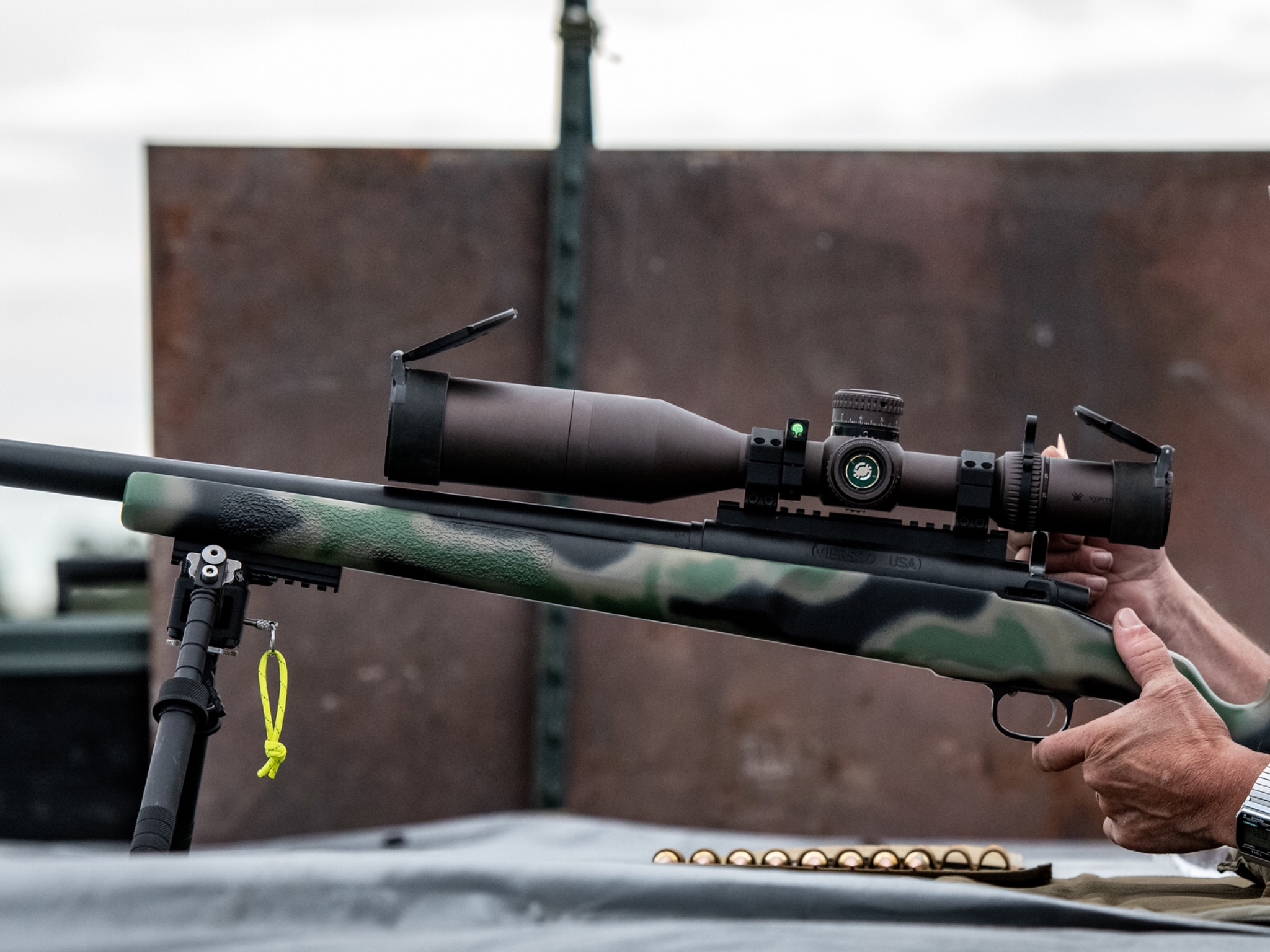

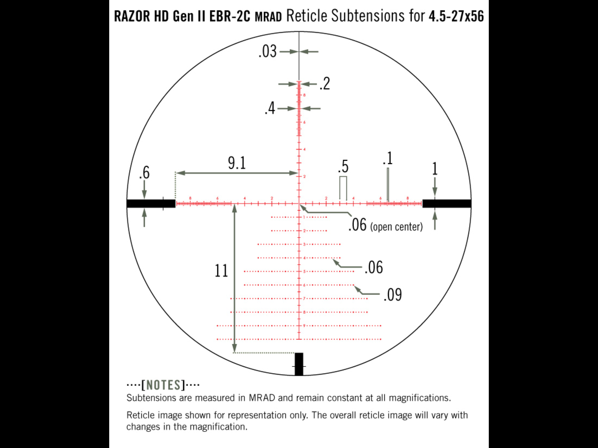

The two 375 Snipetacs both use a 9 mil hold under for a 100 yard target. You simply put the offset in you ballistics program, works very well and is simple.
Both have rifles have medium plus Vortex rings.
A few pictures if the works
Cheek weld is good to work with as seen in the pictures.
Stock info- McMillan A5 Super mag camo , McRee black
As seen in the retical you can see how we make good use of the hold under ability on any very close targets that with these rifles you hardly ever see anything close anyways but yet if asked done deal.
Hope this helps Mark
