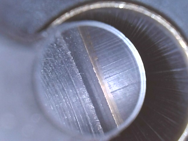

Hello I use this for now:
But the length of the case I s more short than the length that my chamber permit...
FrankFord Arsenal case prep center. You should take a peak with a bore scope where your brass lines up in the chamber though. You could reduce your trimming by 3/4 if you see your case mouth is .050ish away from the chamber wall...
Hello I have the photo ...
But I think that the measures of the chamber with Sinclair gauge are the best and most precise.
