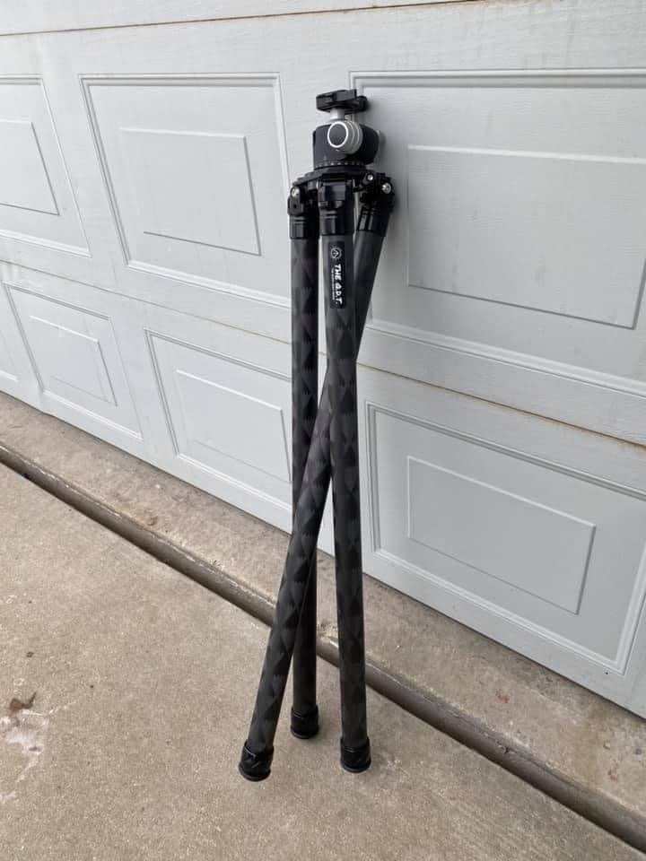

The two vets QDT is also literally gigantic. I couldn’t stand how big the legs are and how you have to make sure you fold it evenly to get the legs not to cross like this
