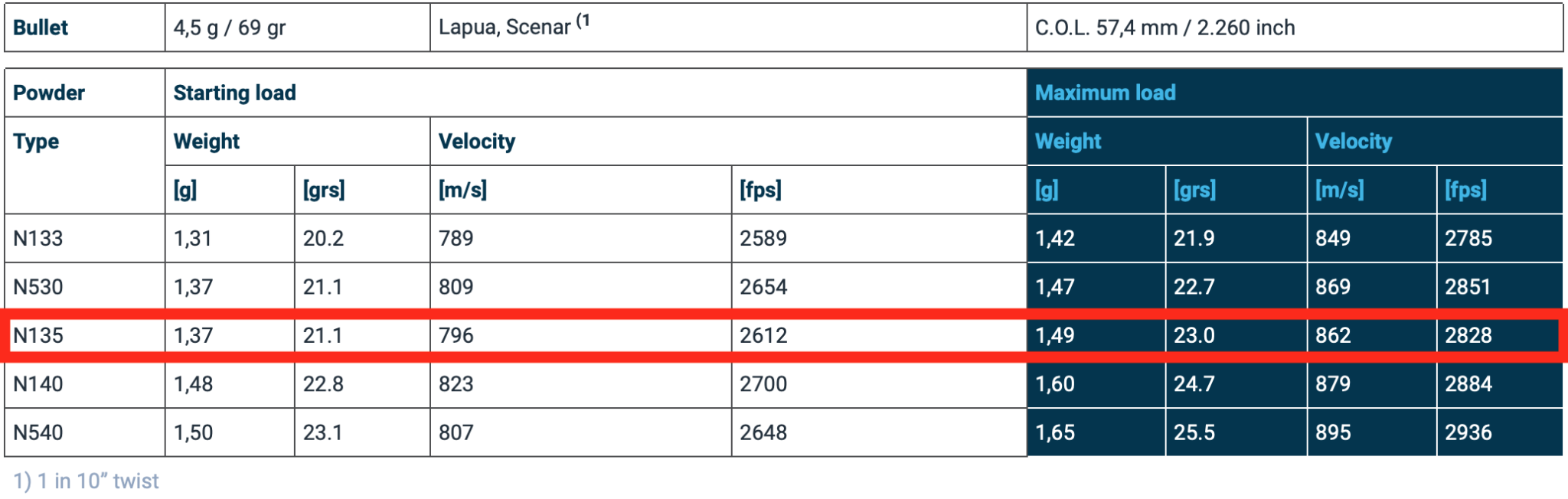

Advice on 223 low velocities versus manufacturer data
MotoSinge
Jun 22, 2019
70
32
I'm reloading .223 exactly as per data from the manufacturer, but consistently getting 200fps lower velocities than the manufacturer data. Any thoughts on why my velocities are so low? Using Viht N135, Lapua brass, 69gr Scenar bullets. Thanks.

Thanks Snuby642 and all. I had overlooked the barrel length and didn't appreciate the velocity decrease as a result. I'm running an 18" barrel. Test barrel was 25". So that explains the velocity decrease.
