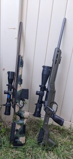

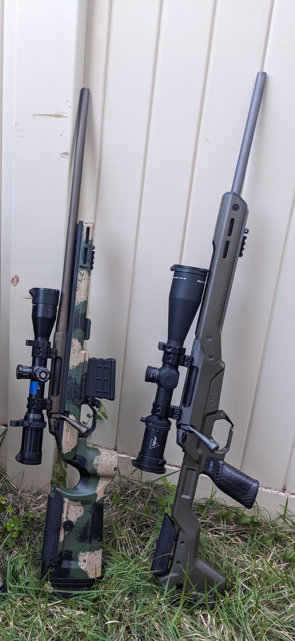

For kicks here’s my super varmint 223 in a Bravo. The gray tungsten factory Cerakote looks good in that Sako green.
Also got an excellent Bugholes 204 barrel for it that I swap in.

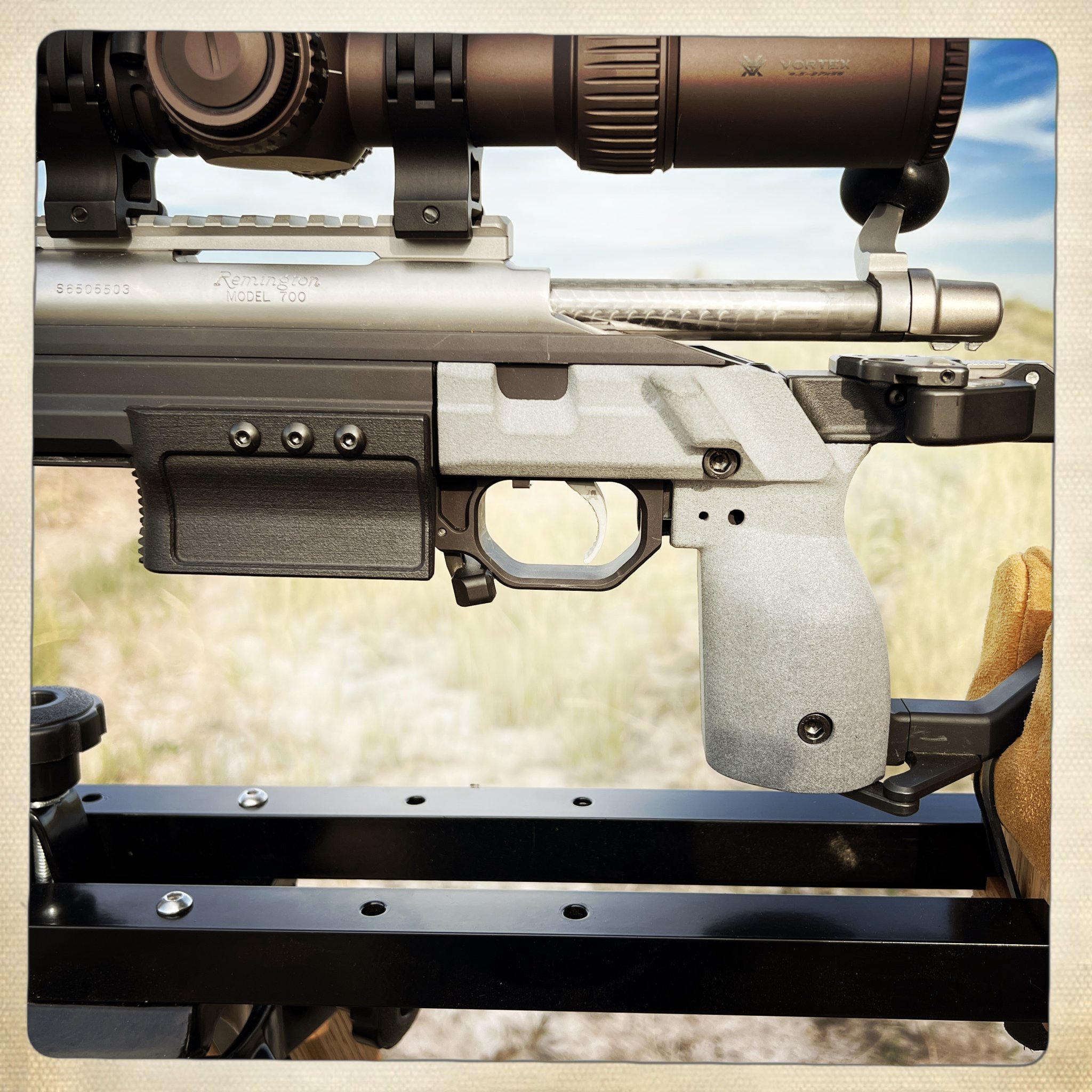

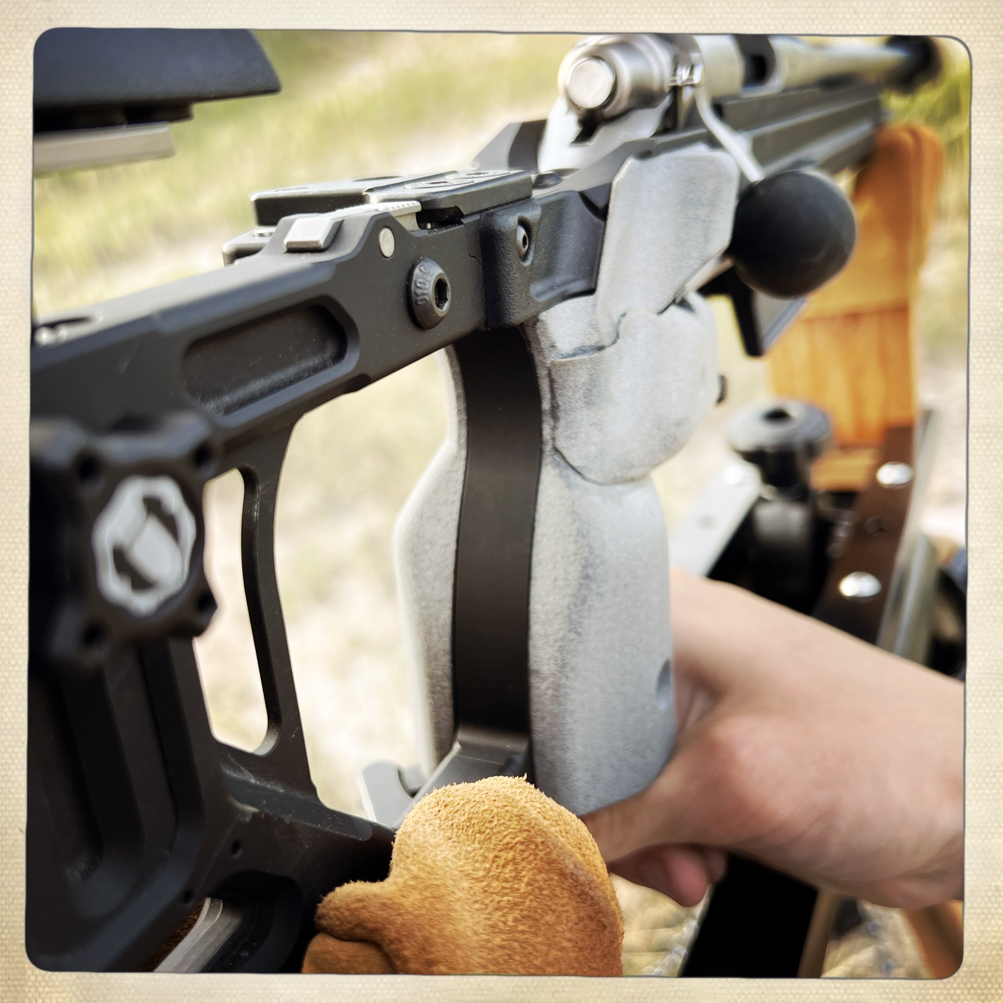

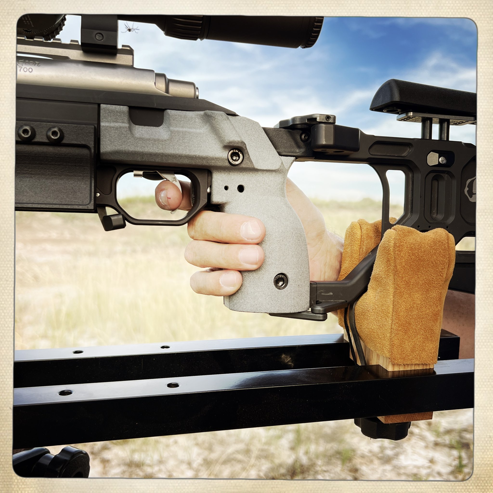

Oh very cool. I wear large gloves and find the Whiskey 3 small grips on the small side but the large ones are bit big for me to get a decent wrap around grip when trying to hold the weight of it by the grip.
Reactions: carbonbased
Yeah, the the thing that bugs me about the large grip size is that it doesn’t bring your hand any closer to the trigger! Dumb.
