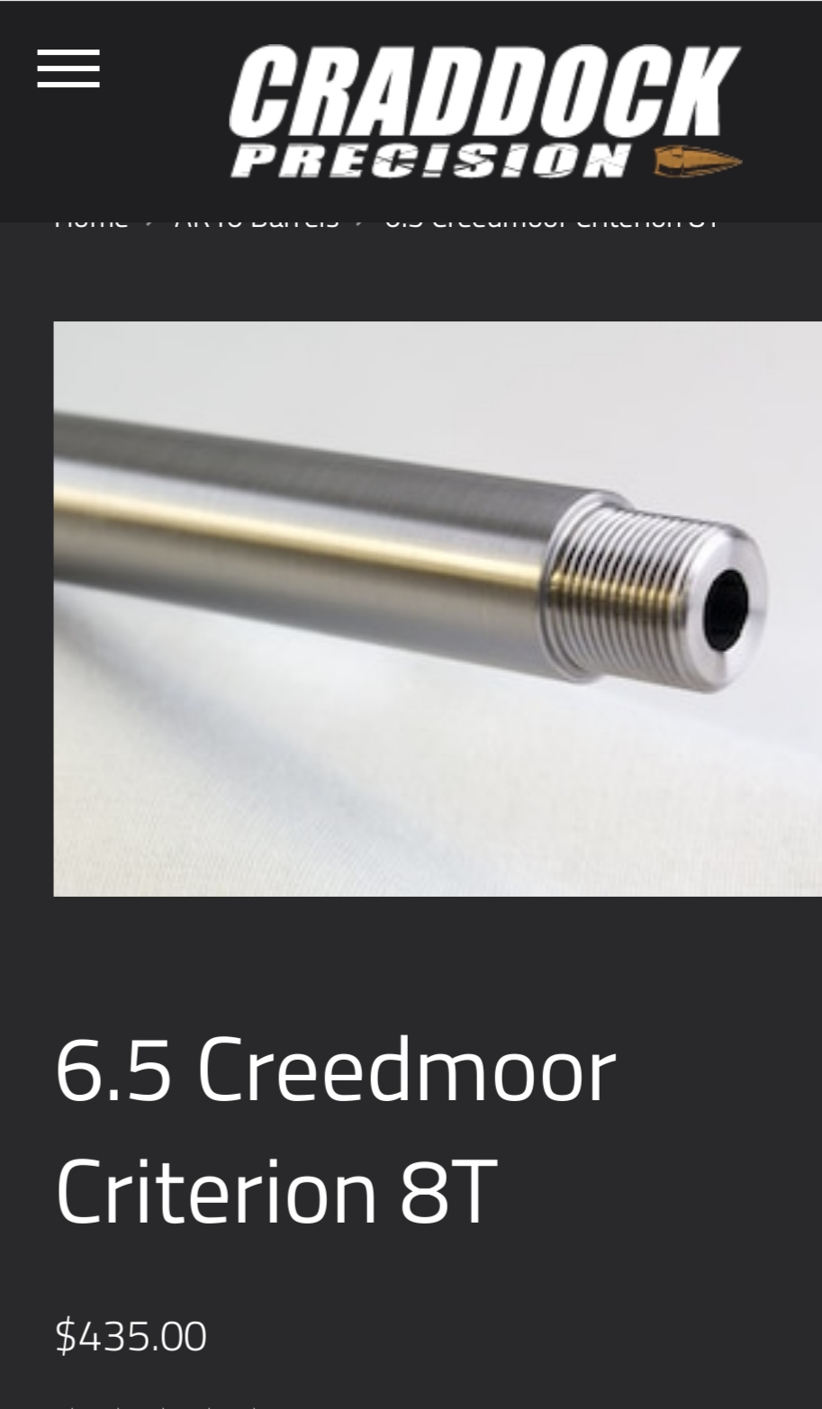

For around $400 or less i would look at keystone accuracy, craddock precision, rainier arms, and wilson combat. There may be others, but those should give you a good start.

In your price range this is your best bet.

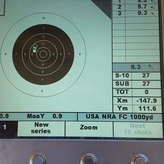

I did a 25" Bartlien barrel w/brake
Not a 6.5 Creedmoor.
I've never tried a Wilson Arms but I know it's different from Wilson Combat.
I've heard good about both but what Bill Wilson has done with the 6.8 SPC makes me lean toward Wilson Combat.
Missed the 6.5cm part.
Wilson Arms is indeed not Wilson Combat. Wilson Arms is a huge barrel maker. Everyone Ive had has been a laser. White Oak has been using Wilson blanks for years...,

I bet you're not going to get a Craddock Precision barrel south of $650 except with the most
economical of blanks. @ $350 is going to be in machine time & labor.
He quoted @ $775 for a 24" 6.5CM 1/8 using:
A) Bartlein Blank
B) My supplied ARMALITE barrel extension
C) +2 gas
D) Headspaced on my supplied ARMALITE AR-10 bolt
For squeezing a nickel till the buffalo roars with odds of having a sub-MOA pipe @ $301.75:
https://ballisticadvantage.com/20-inch-65-creedmoor-rifle-length-fluted-ss-premium-barrel.html
Best to you.
A) Bartlein Blank
C) +2 gas
Best to you.
Reactions: beenjammin
Thanks for the correction, C_R_Slacker,
I forgot about that section of Craddock's site. My fault for always thinking
of only Bartlein blanks for my ARMALITES AR-10 builds.
I purchase Criterion chrome-lined for much of my 16" & 20" 223 Wylde rifles.
Again, thanks for the correction.
No problem, i wish i could afford bartlein, Krieger, etc. on every gun, but there are some good options in the next tier down too. I learned about craddock from other users on this site. Just trying to pass it along, haha
