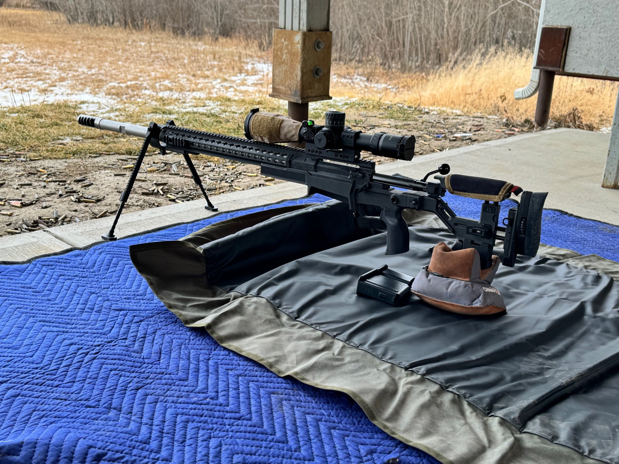

+1 for the Elite Iron. I have and use all three of the above-mentioned bipods, all serve their purposes well, but the EI is my pick for stability.
Obviously, this is a subjective sample size of one. YMMV.
Edited to include a 7 PRC and EI.

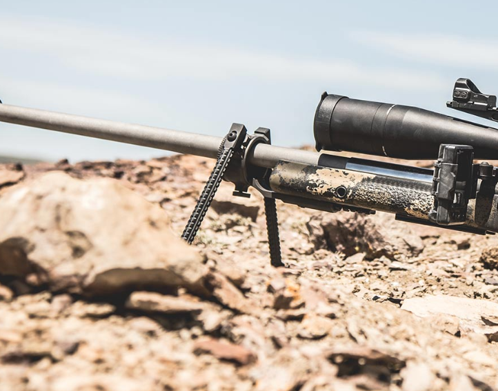

I can't say for certain, but there should be an acceptable mounting solution for traditional stocks, as well. The picture below is from their website.
I'd just give them a shout and talk to someone on the phone about which adapter you'd need, but I can't see it being impossible. They were really good to deal with when I was having fitment issues which were entirely my fault.

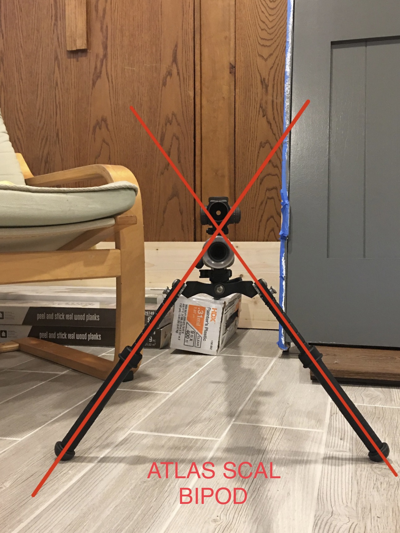

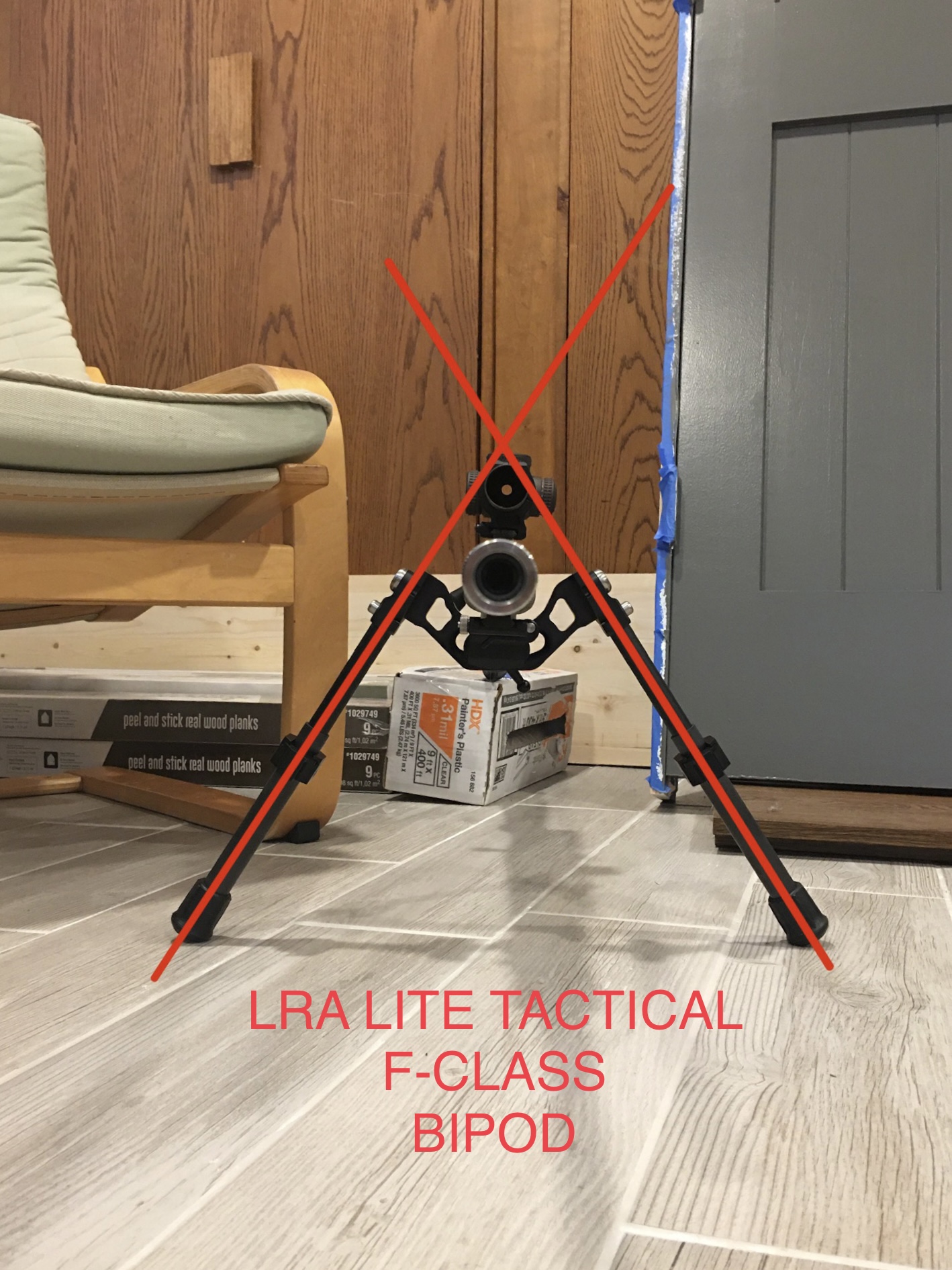

I get it, but the canyon-sized deep yoke of my model sorta makes the difference academic.
For example, some time ago I snapped these pics with a regular fiberglass stocked gun.
Note in the pic immediately above, the LRA is a pic rail version attached WITHOUT an Arca adapter.
With a deep yoked bipod, the additional .5” to .75” of height you gain when using my solution doesn’t pop the barrel higher than the … whatever that stability point is called (where the lines cross). Fulcrum? Note again you need to add that height to the gun in the LRA picture above.
Adapting the Scal in the same way would push the barrel well over that fulcrum (but you could just use a RRS dual use clamp since it’s 17s compatible).
Is it ideal? No.
