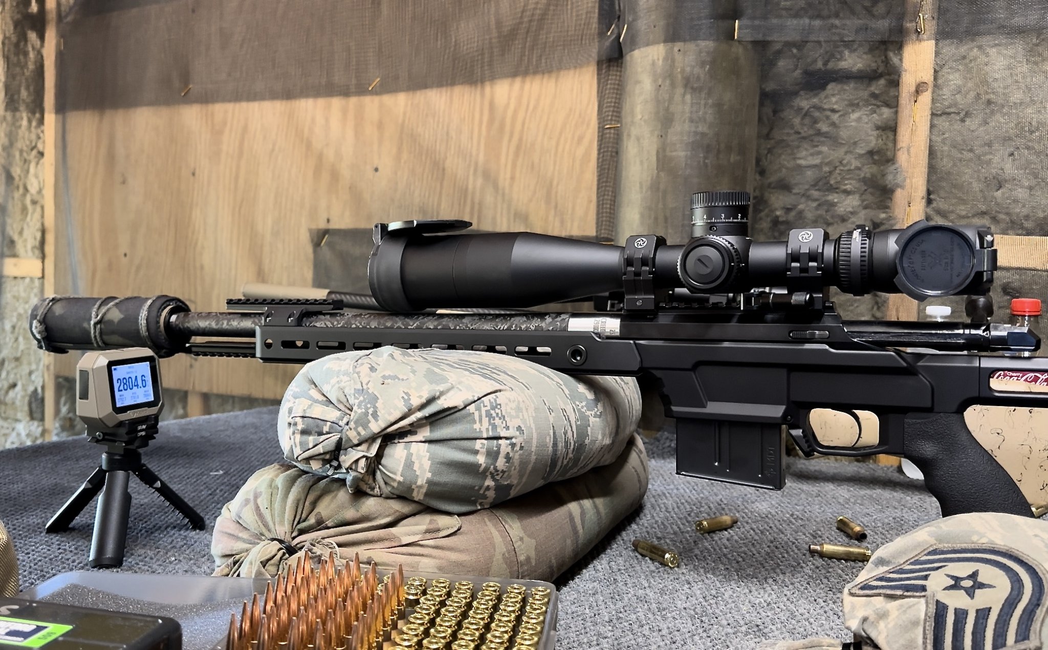

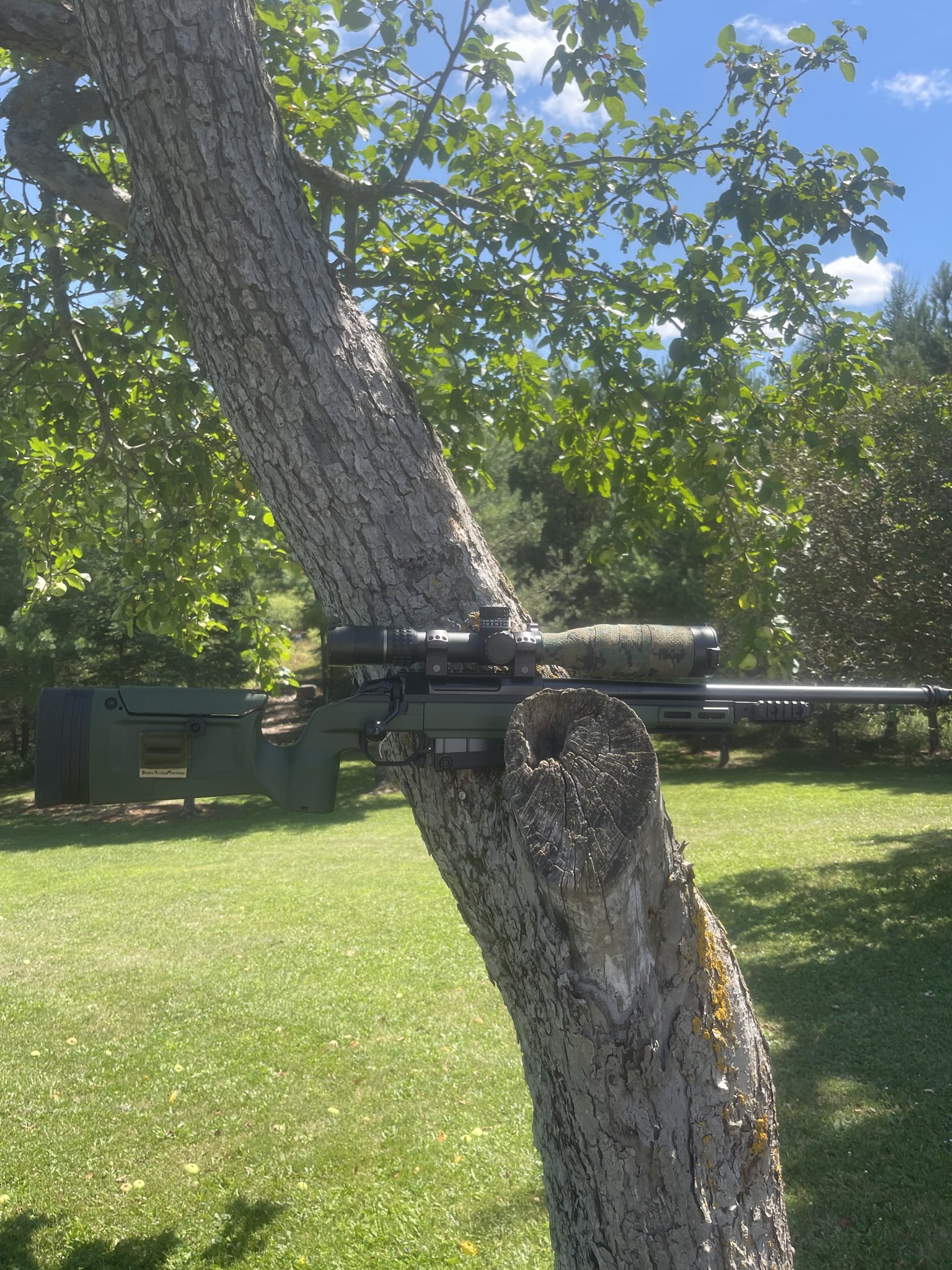

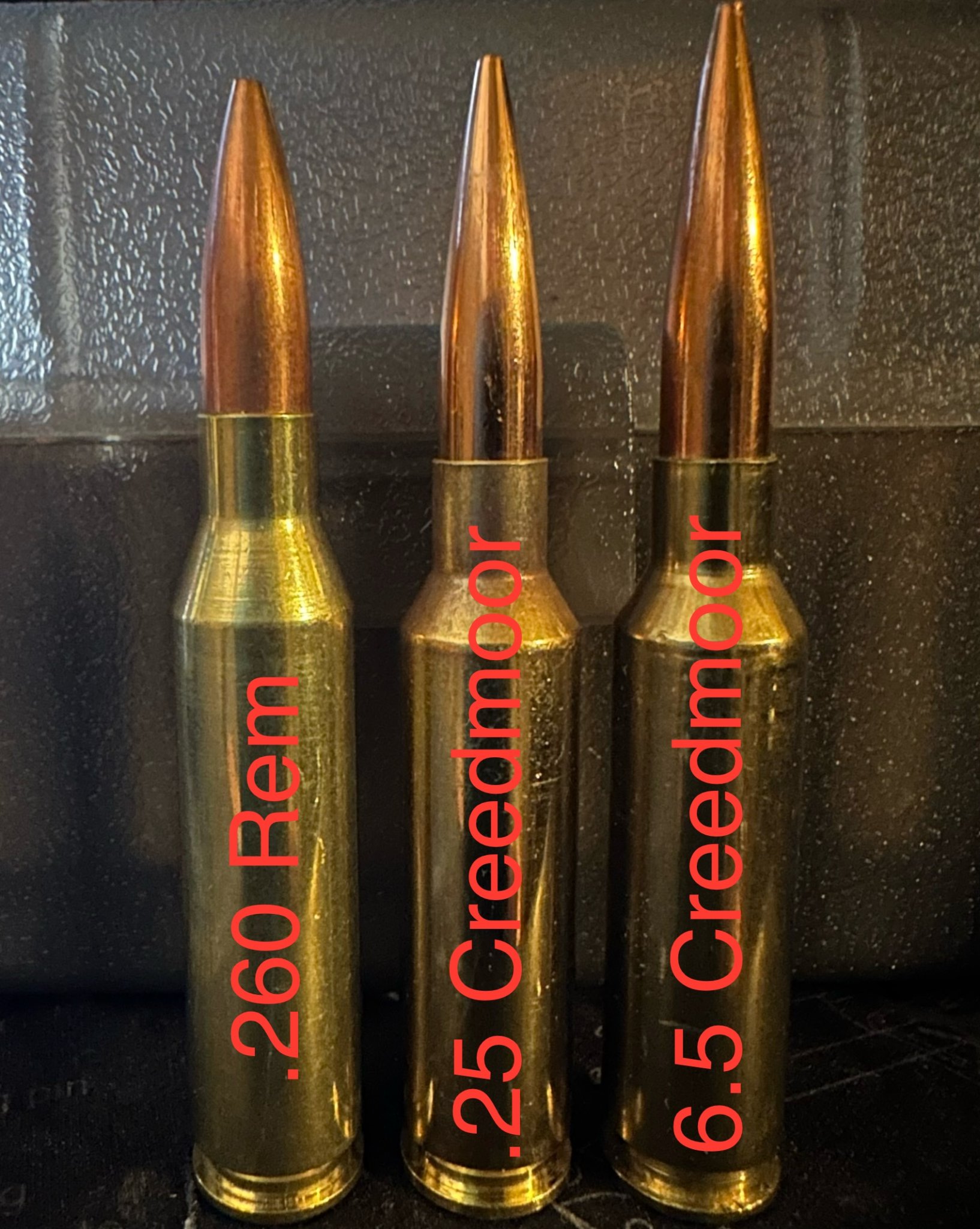

If you reload, the easy-button option would be to build an Aero Solus action with a TriggerTech Special or Diamond single-stage, and have a custom prefit built for it chambered in .25 Creedmoor, with a 20" barrel with a 7.5" twist, and pushing Berger 133 Elite Hunters. You can build it at home with simple action wrench and barrel vise, and you can order other prefit barrels for it (that can be easily found most everywhere, since it was designed to use Zermatt Origin prefit barrels that are readily available from most companies). I'm getting 2800 FPS MV average from mine, and it's a very easy cartridge to load for. Alpha Munitions makes .25 Creed brass, and sells the reamers that match their brass. Winchester StaBall 6.5 powder can be found everywhere. CCI 400 primers (or any SRP primers) can be found just about everywhere. It's very conservative on powder consumption, it's got good barrel life, is an excellent design (Creedmoor case), and extremely mild recoil.
I built mine this year, put about 300 rounds down the barrel so far, and I'm extremely happy with it.
IMG_9201.jpegimage_cropper_82957909-02CC-4CB4-A8F4-86DB98C26A8F-485-000002A84CC08B50.jpegimage_cropper_5778DA93-270F-417B-8F4C-1F100B7DEC98-10219-00001A80781EB6BB.jpeg
