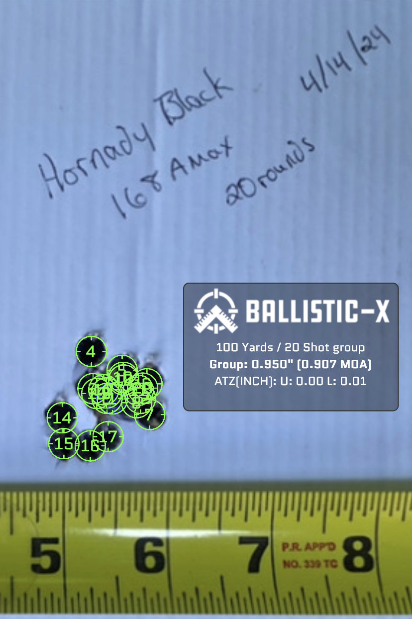

20 round group from one of the TAC18 308’s

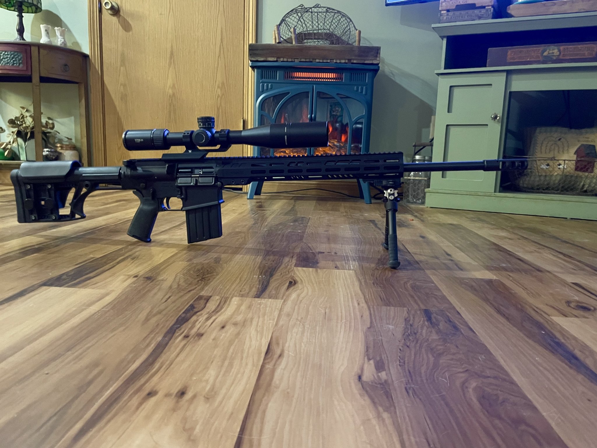

Armalite holds their own in the large frame gas gun world.
