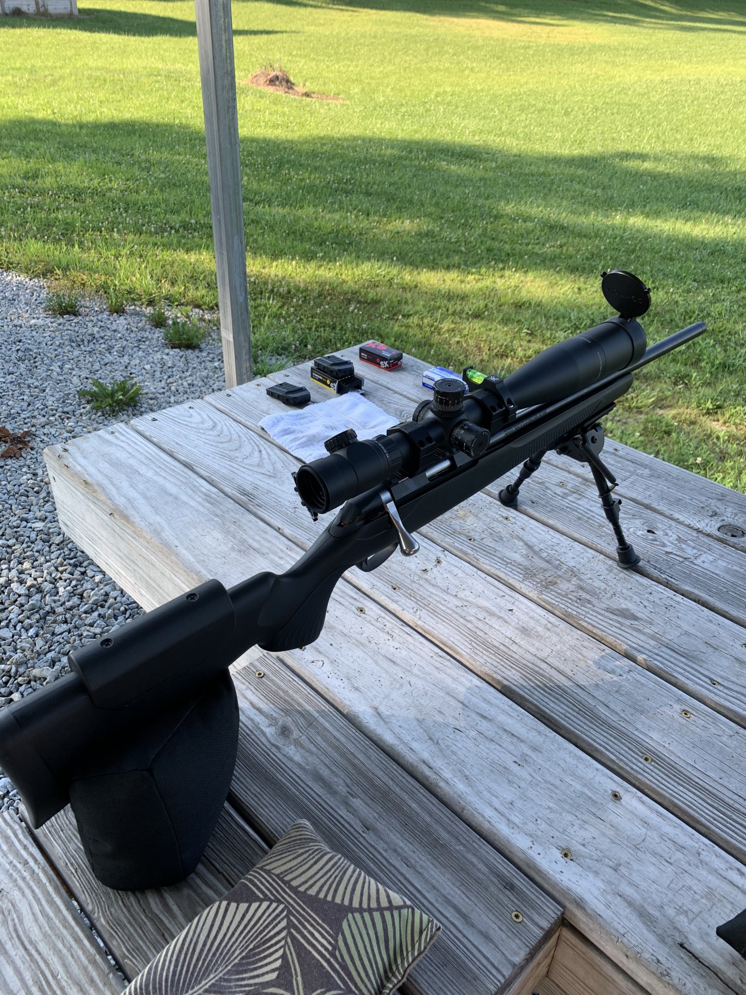

Hello everyone. I’m needing some advice on lot testing for our 2 TikkaT1x
Me and my wife picked up a pair of Tikkas last month. They are all set up now and we are starting to get comfortable behind them. Both rifles have maybe 100 rds thru them.

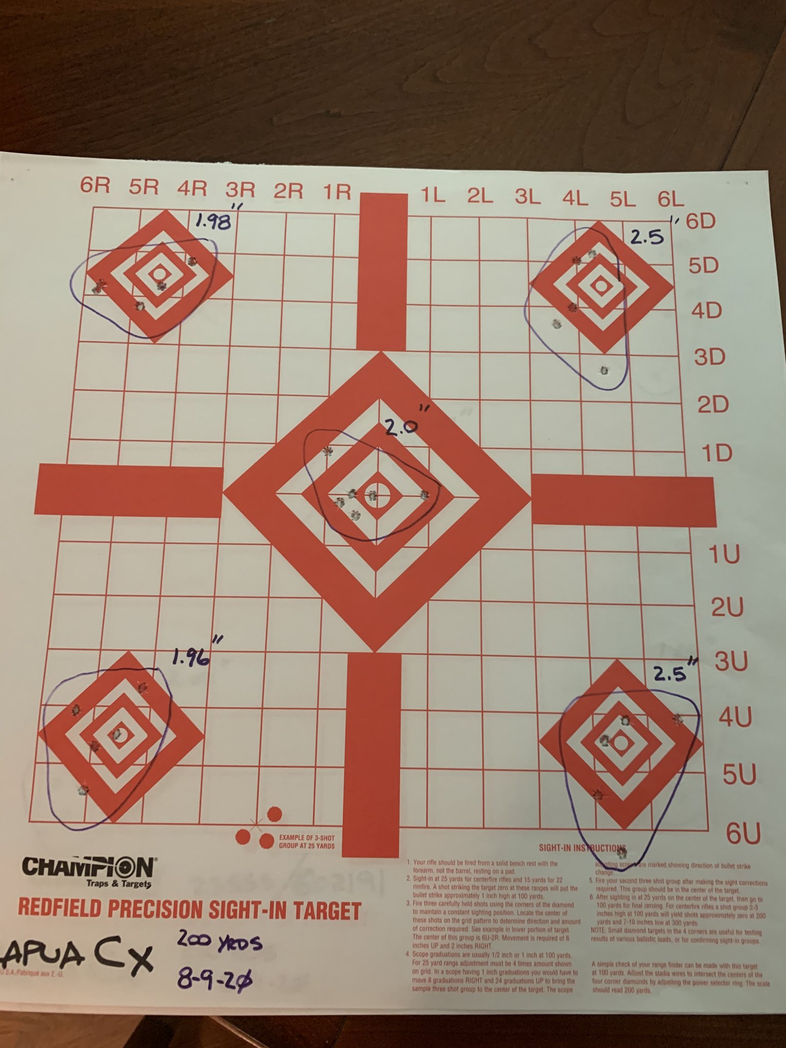

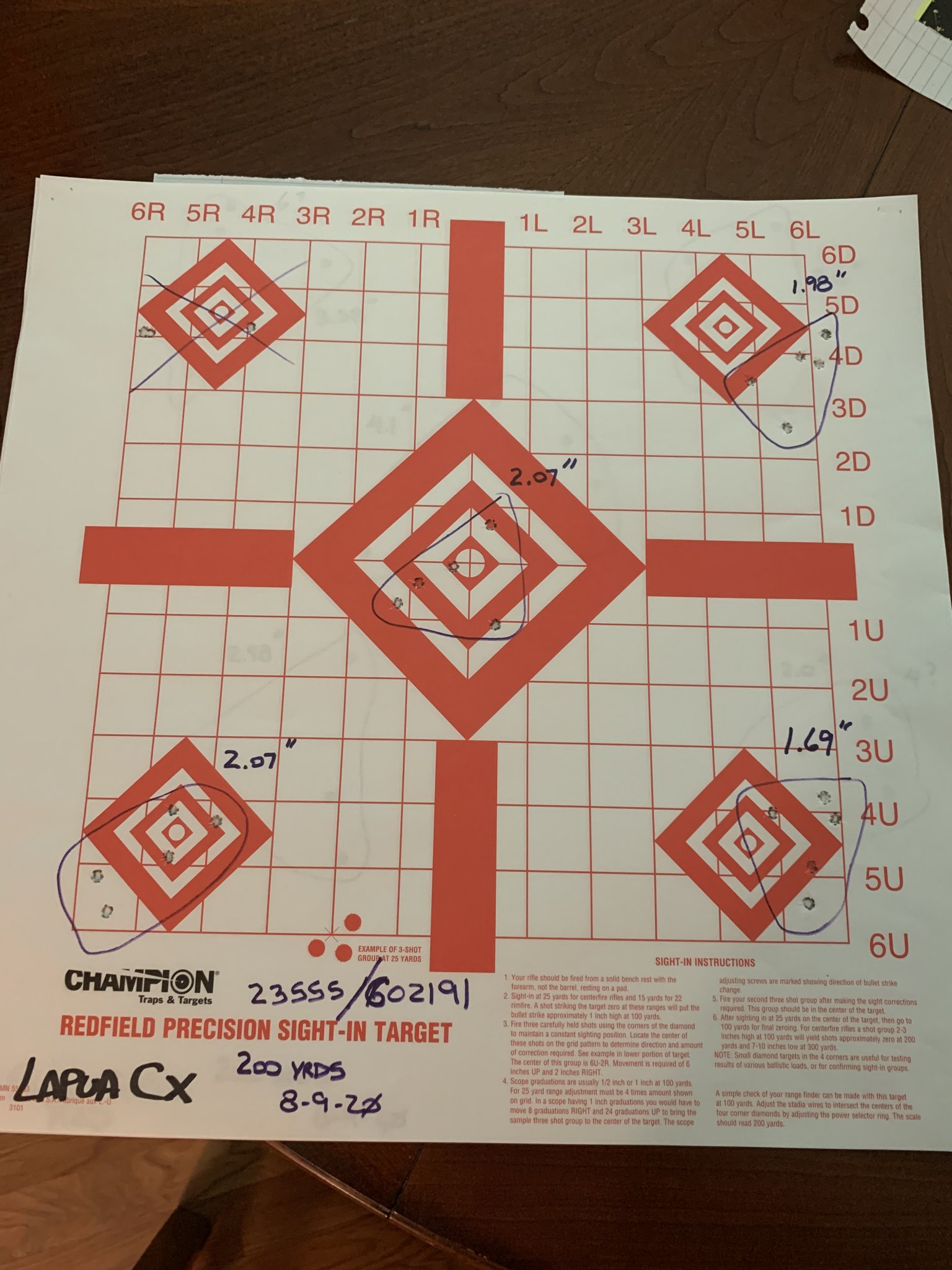

Today we lot tested the SK std+, SK RM, and Lapua CenterX
we didn’t go forward with the CCI or Wolf as it didn’t group well in our first go around.
Today we each shot 5x 5rd groups at 200 (10 sighters to season prior to recording the groups ). No cleaning in between.
interesting thing. My T1x did well with the SK STD+ but not so well with the SK RM
my wife’s T1x was opposite in that hers did better with the SK RM but not so well with the STD+
as I’m trying to get 1 lot that we can both shoot I was lucky in that the Lapua centerX shot well in both of our guns.
targets below.
we are new to .22 and are asking for advice on if we would benefit from lot testing more centerX or is this about as good as it’s going to get??

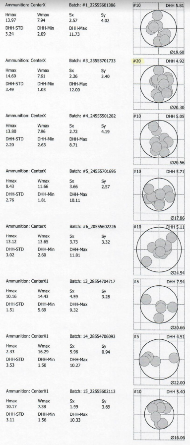

I tested 16 lots of center-x and there was a big variance between the lots. Luckily I got a lot that works well out of my Vudoo and out of my friend's T1X so we're splitting a few cases of CX.
This was @ 200. I'd say the lot of CX you found is shooting really well out of your T1X.

First 2 #'s are the velocity so "23", add a "3" to it, so it means 323 m/s out of their machine. For example I run a lot of 24xxx so it should be 1062, but it chronos out of my rifle at 1090.
Maybe similar #'s means similar performance. In my testing of 16 lots of CX, they all had pretty different lot #'s -
