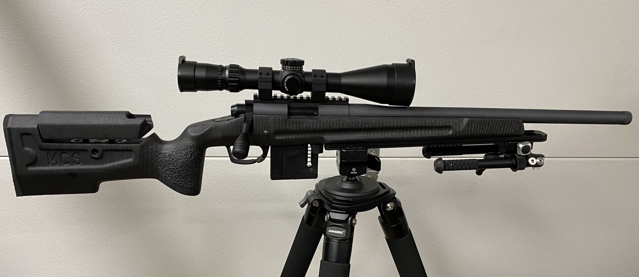

Only difference between the PRS1 and PRS2 is the 1 has a hook so you can pull it into your shoulder with your support hand. Now I believe the mini chassis manners offers is pretty close to being spot on with feeding and also works out to almost be a better deal depending on DBM you run plus having to bed the action.

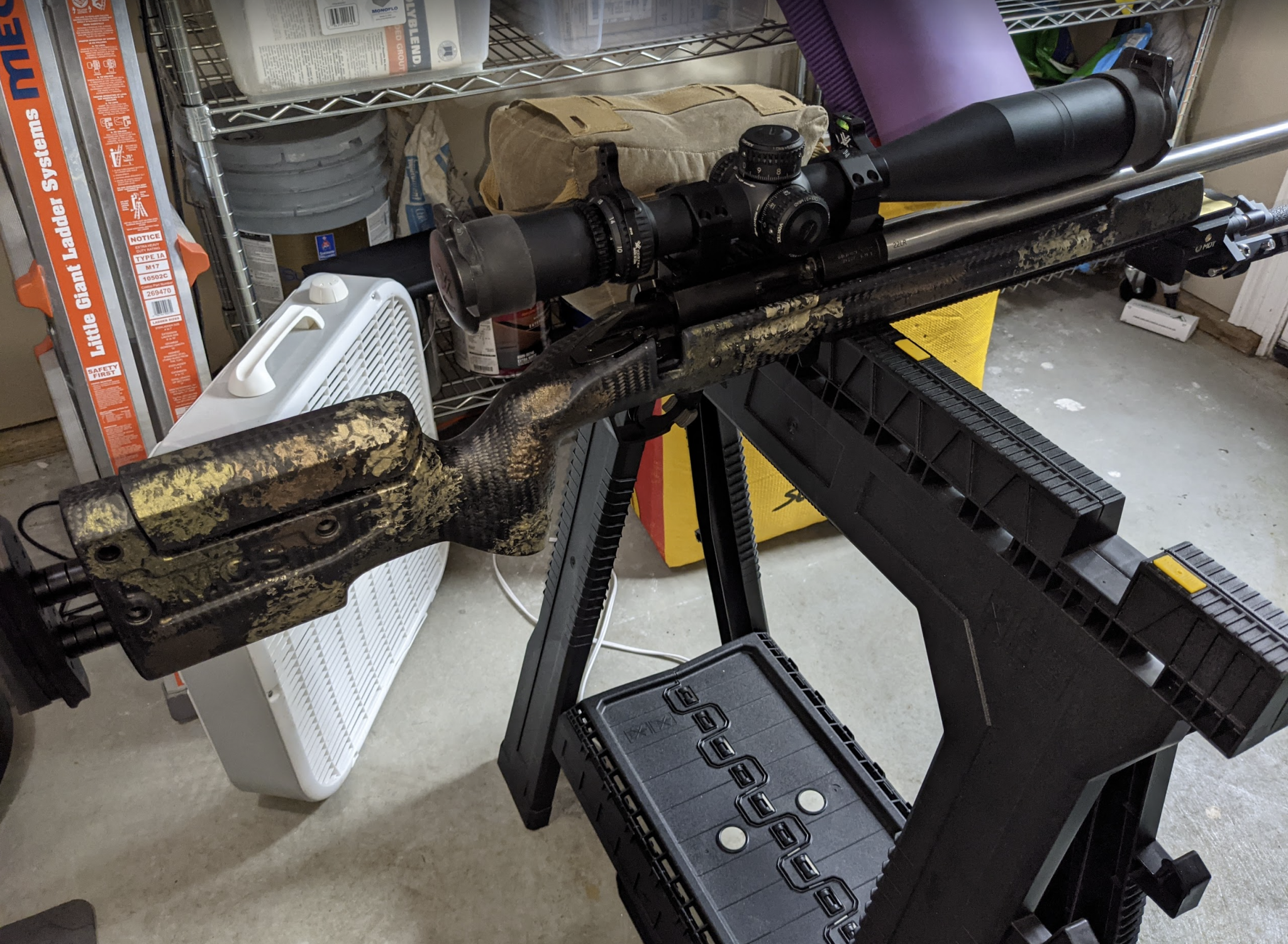

This is all 6 weights inside of the arca rail. 18" barrel. A Bipod all the way at the end, and the Razor AMG 28oz scope. It balances right at the mag well. If I was to try to get this 2-3" in front of the mag well as desired to sit on a gamechanger, I'm going to need a lot of weight up front, like another 1-2lbs hanging off the legs of my bipod.
