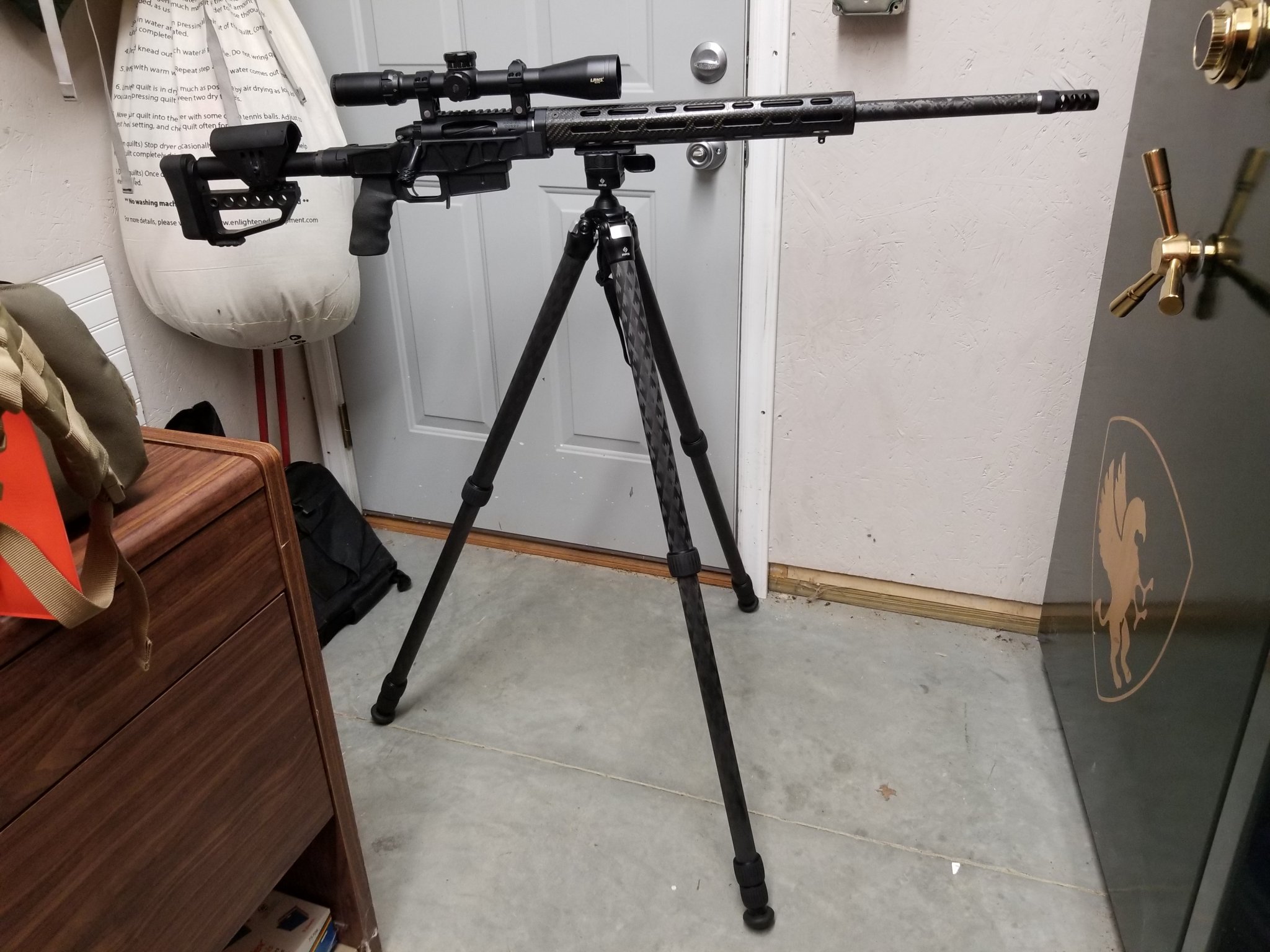

I have both the Anvil30 and the leveling base. I would say that the base is a little more stable but the ballhead is what I use most often due to the flexibility. I run the RRS rail on my AI AT and to say that it is stable is an understatement. You really can't go wrong with either the Anvil or the leveling head....that is why I have both.
Got a pic of that set up?
I have to echo what people are saying about the Anvil 30. I was looking at a leveling base setup but Adam Rehor at MHSA convinced me to get the Anvil 30 based on its range of motion. I have no regrets. The Anvil 30 ballhead locks up tight and I haven't noticed any movement in it when you tight the locking lever so the rifle stays where you point it. We used it to shoot out to 1400 yards standing at Franks class this summer.

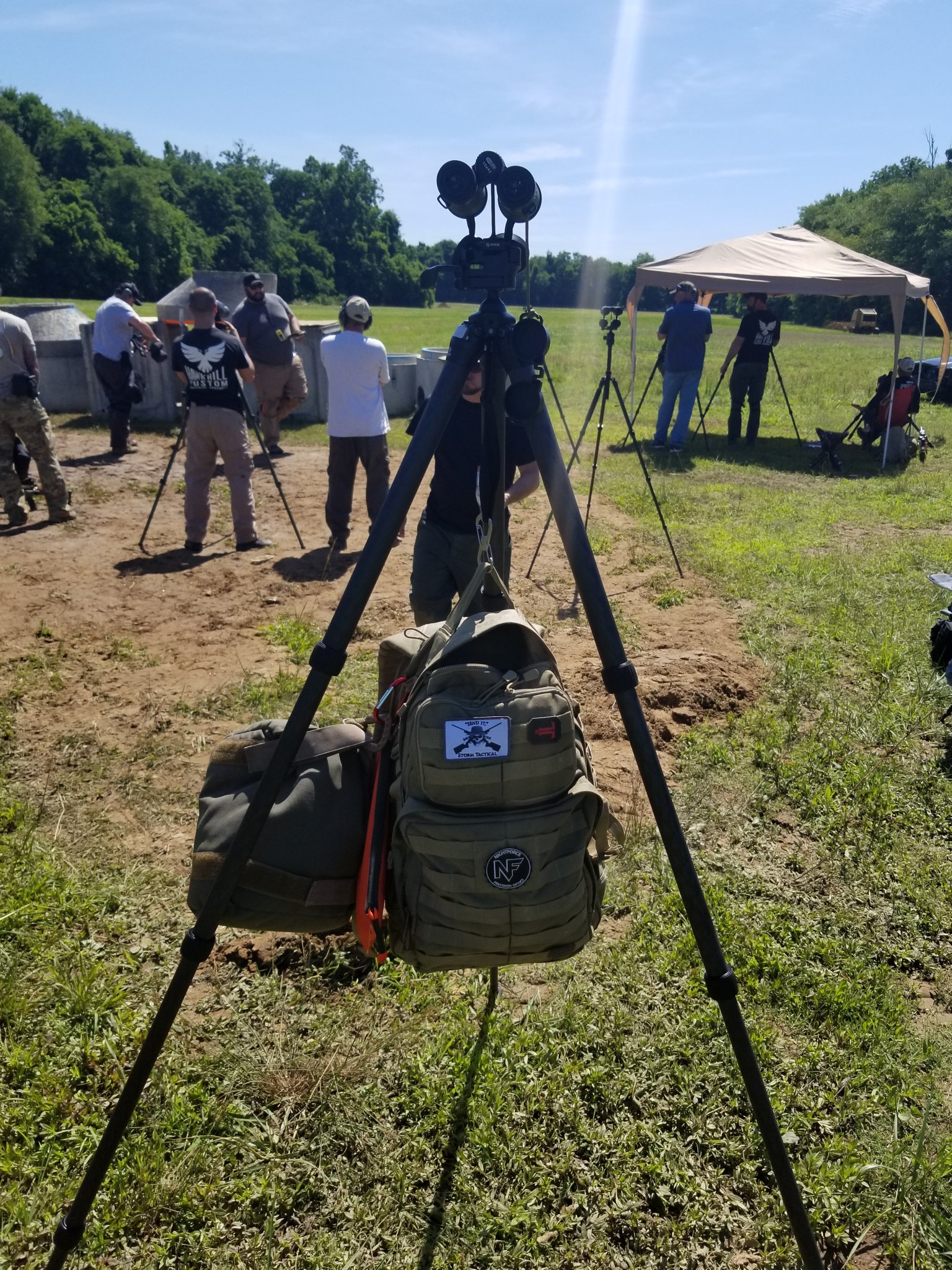

Tell me exactly how the binos are mounted on your tripod. Is that an Outdoorsman bino attachment? Thanks
Not sure if i would go this route or not again, this mount isn't super quality but hasn't caused any problems in 2yrs. Time will tell..
