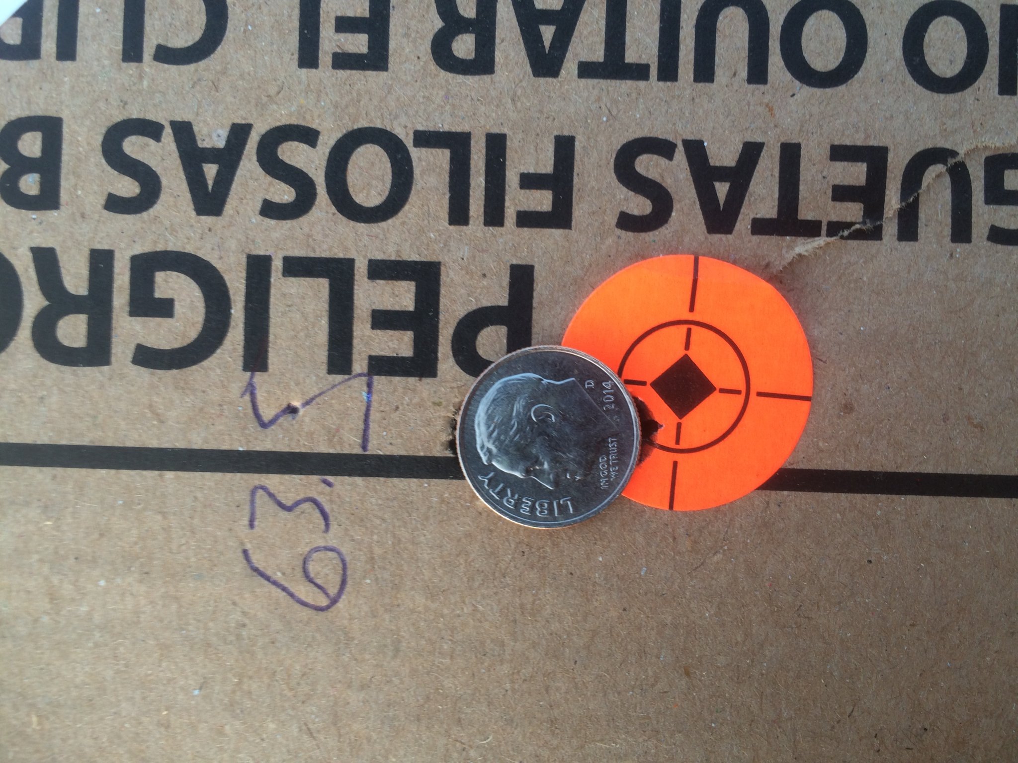

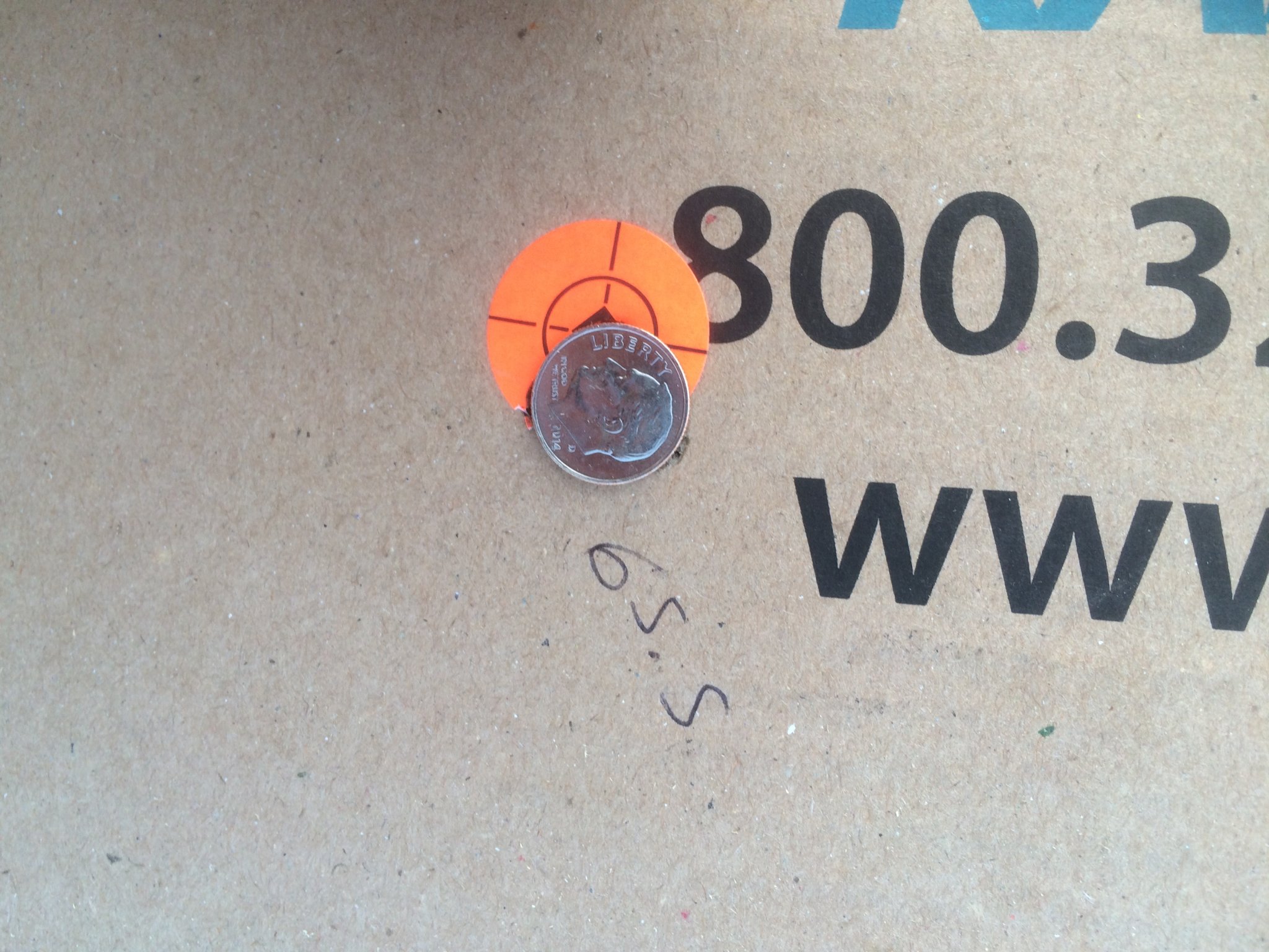

I have the same rifle in 300 WM. Shot for a while in the HS then put it into a MDT ESS. The gun is very accurate. My buddy has it now for deer shooting but it’s one savage I wouldn’t sell just because of how accurate it is in factory form
200 ELDX at 100 yards

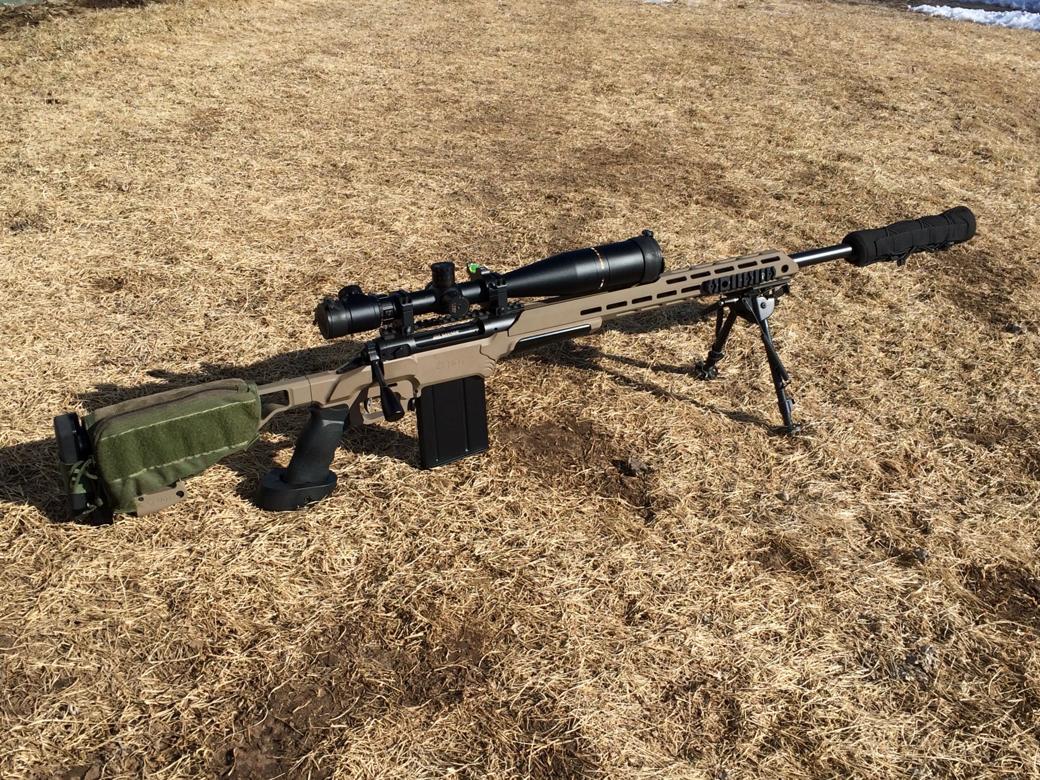

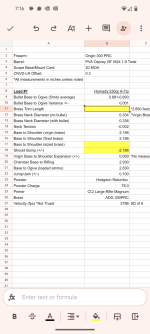

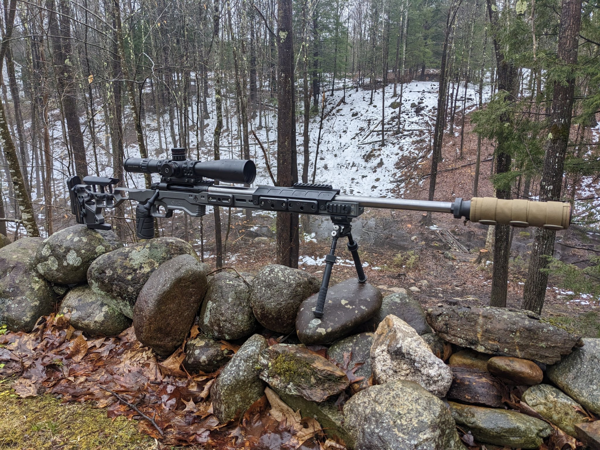

Big fan of the origin long action. I dropped it into a heavily weighted MDT ACC chassis. It weighs about 24lbs with a 26" M24 barrel.
Load dev didn't take long with Retumbo and ADG brass. I ran charges up to 78.5 with no pressure signs, but with a velocity of 2786fps and an SD of 6 with Virgin Brass and 230gr A-Tips I am very happy. It is a 1/2 MOA gun.
PVA spun up the barrel and I installed it myself. Highly recommend their Ospreys, it is my second one.
Action was about $1K, barrel with a 2 week rush was about $800. So into a barreled action with the trigger for $2000. I hunted and snagged the chassis for $700-750 and added the weights from the PX.
All in was less than $3000. I have had a few Savages and they shot great but after running R700 or any custom action, I personally can't stand the chatter when cycling bolts. It probably doesn't impact function. But there are also way more barrel options for something like an Origin.

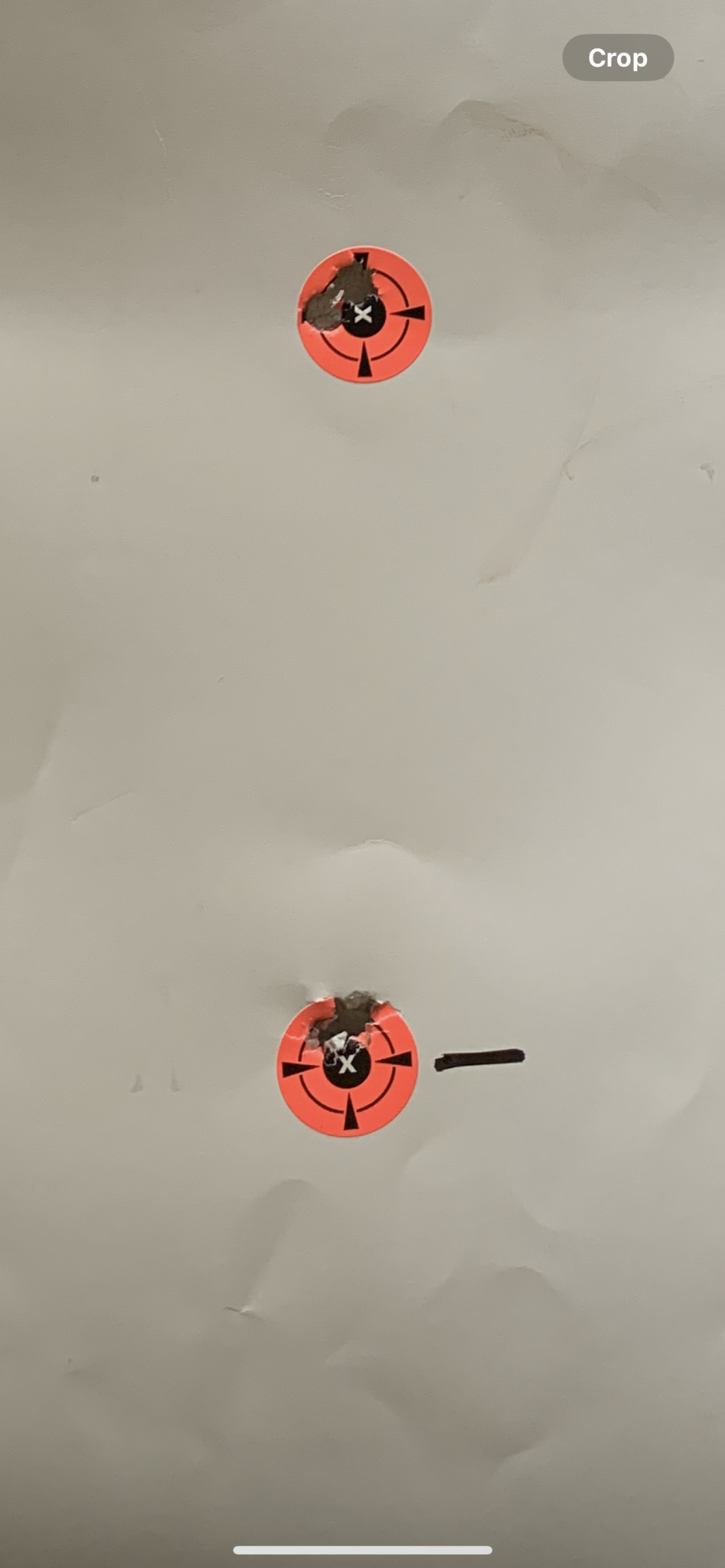

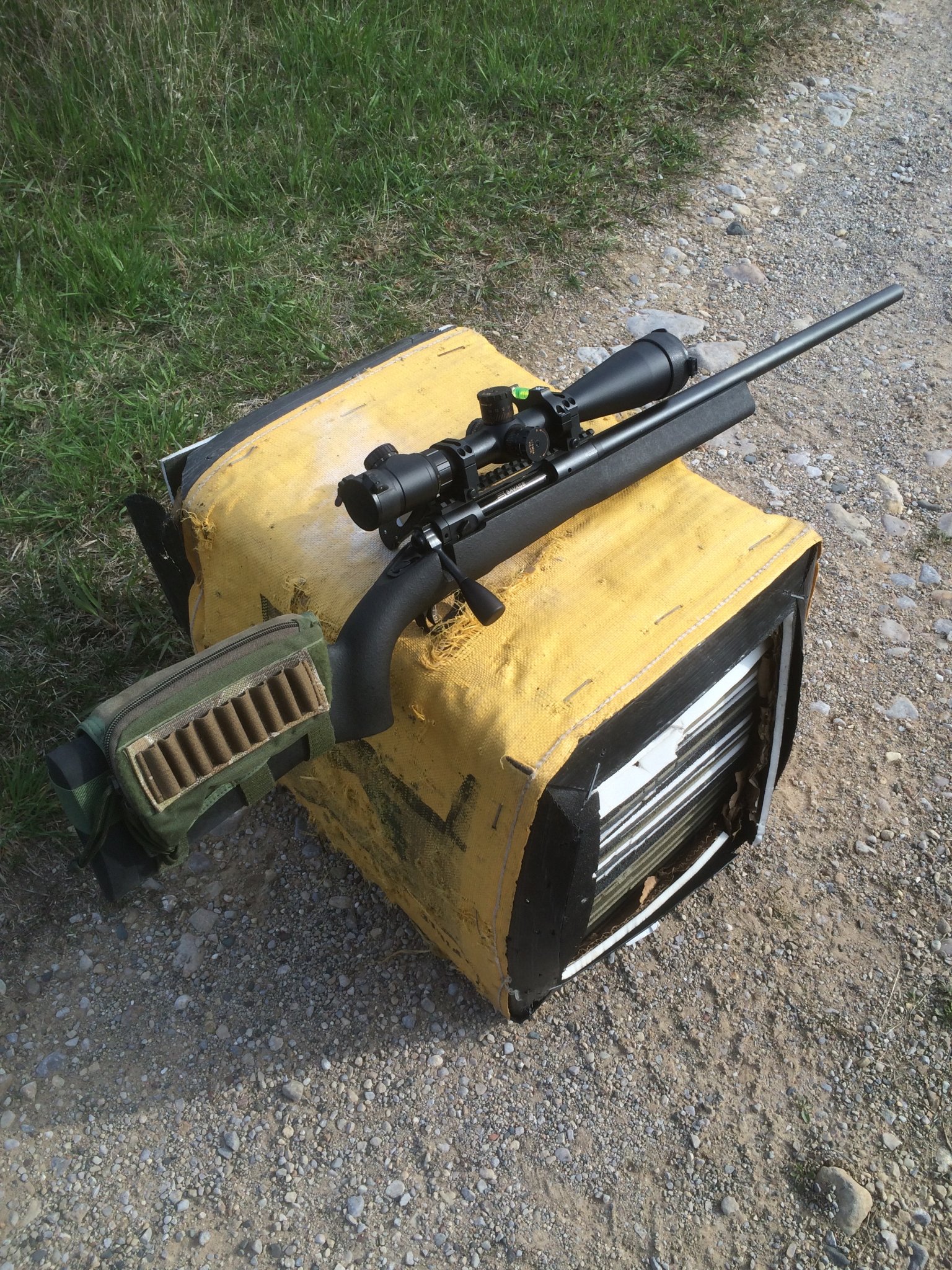

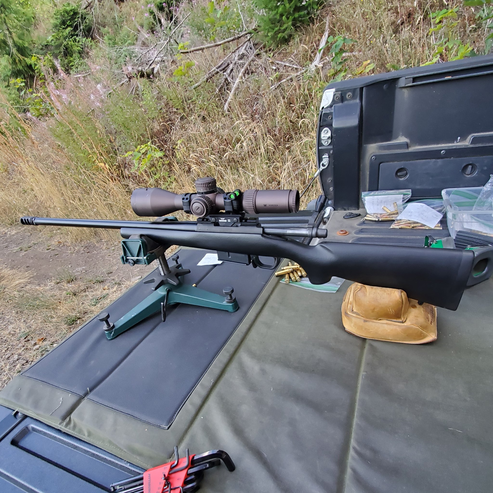

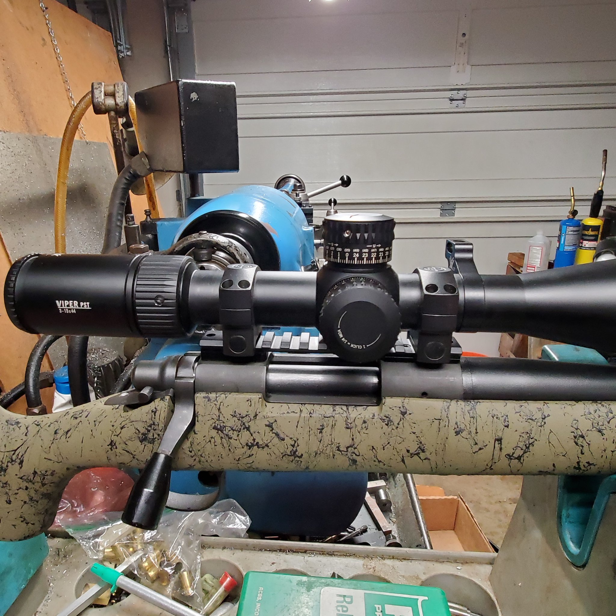

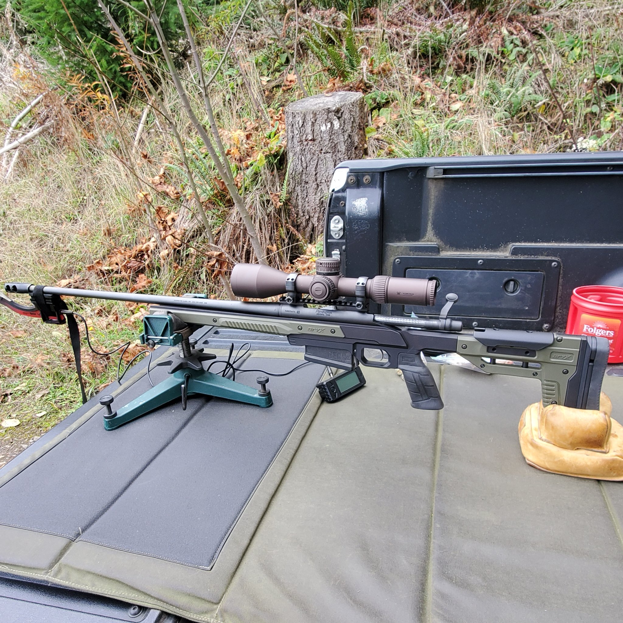

I purchased a brand new Rem 700 ADL 300 WM $540 total out the door on sale....
I just wanted the action for another project.
But decided to shoot it first to see what the new Rem 700 would do.

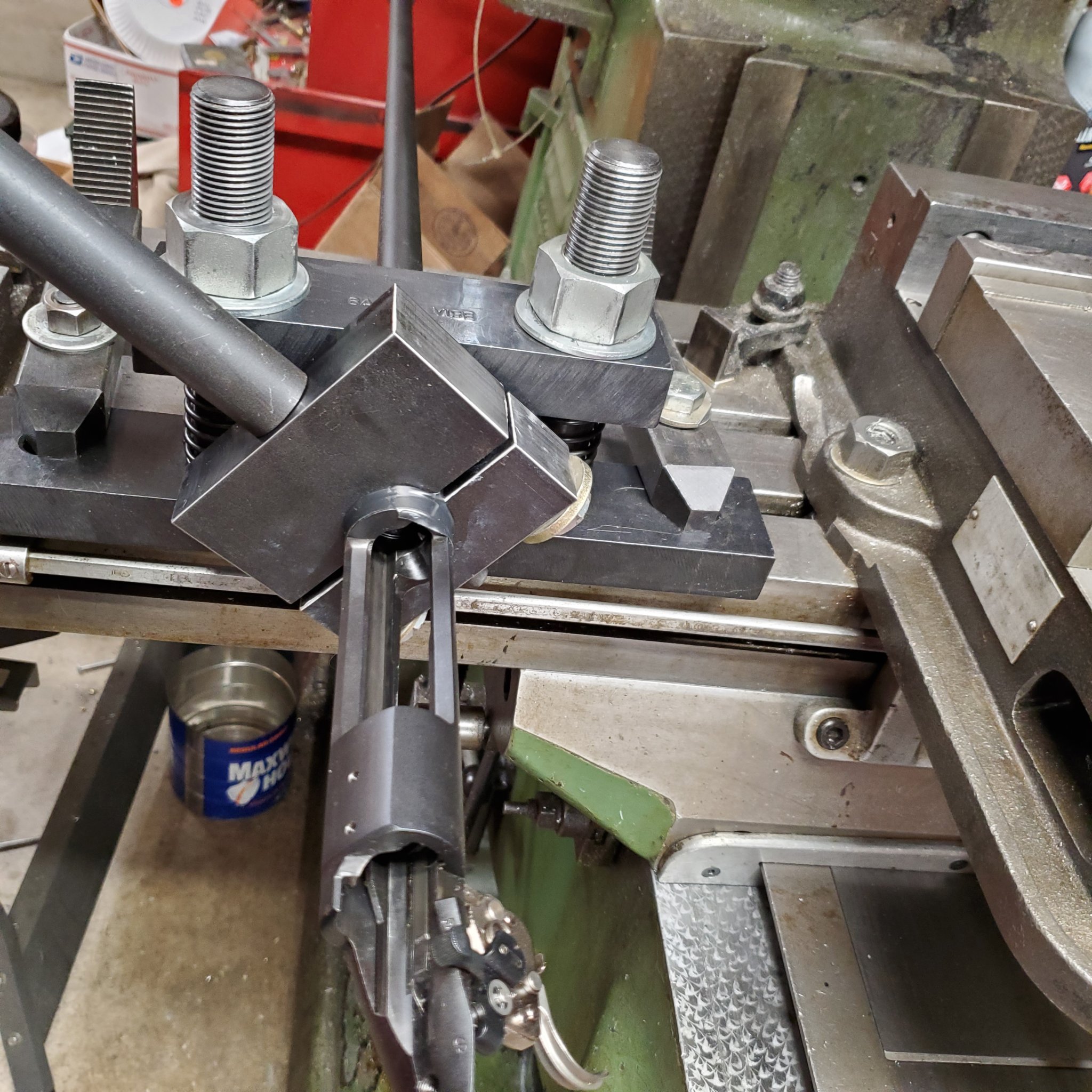

Added an aluminum chassis I got on special $375 shipped. Added a muzzle brake around $85. The machine work was free for the muzzle brake.
I have machine tools to do all the work.
Gave it its best chance to see what it could do.

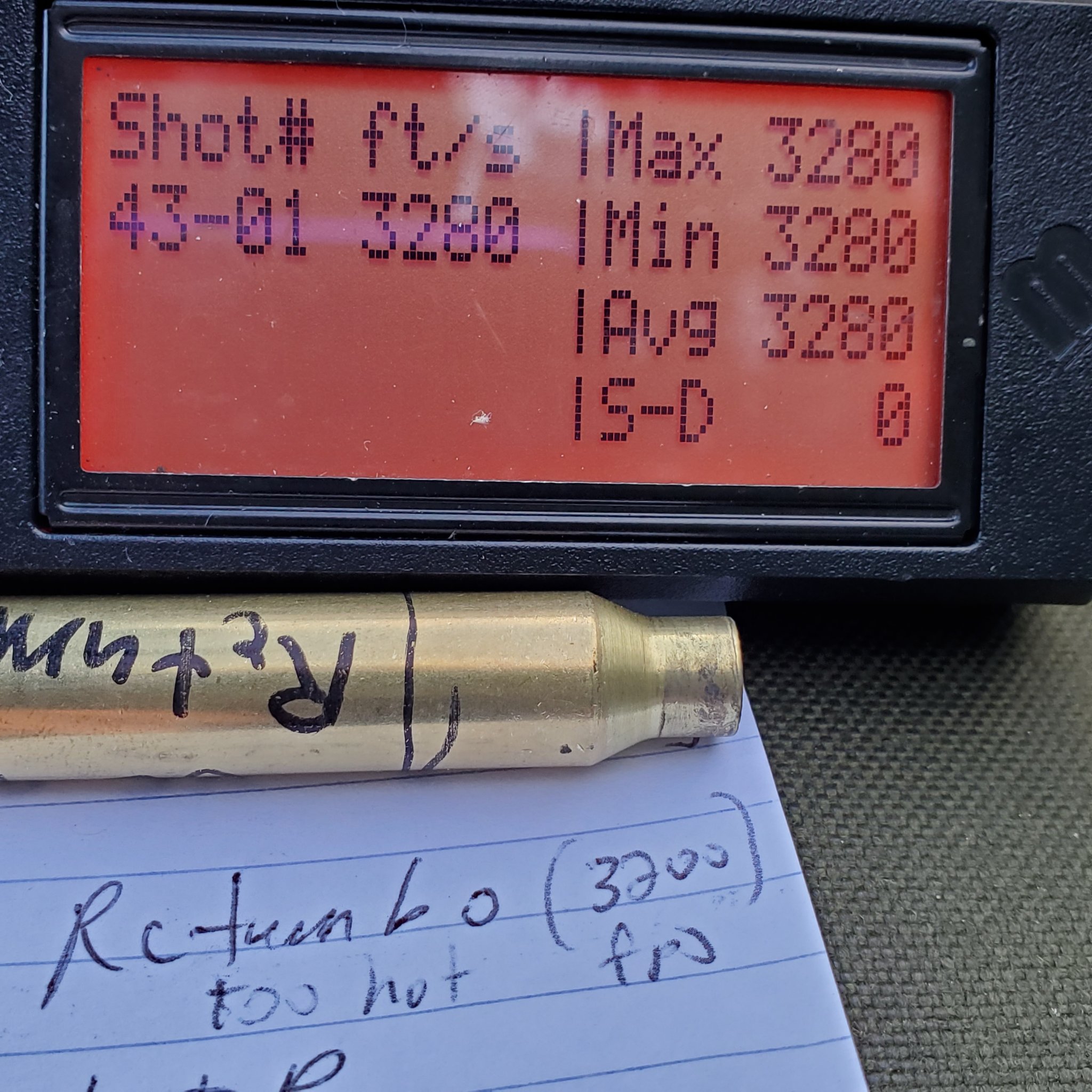

3 shot 1/4" groups and 5 shots .5" were there with 200 gr SMK .715 BC.
I never broke the barrel in, and ran the piss out if it with heavy loads.
3280 fps with the 200 SMK
2964 fps with 230 gr SMK
The chassis lets one run really long cartridges in the 3.7" range with this chassis, longer in other chassis.
Something to check into with your 300 PRC.
Total cost all new cheap 300WM was $1000. And it shot good.
Much better than alot of high dollar rifles like Christensen Arms I've seen terrible groups from many of them, as an example.
But I wanted the action so the 300WM is no more.

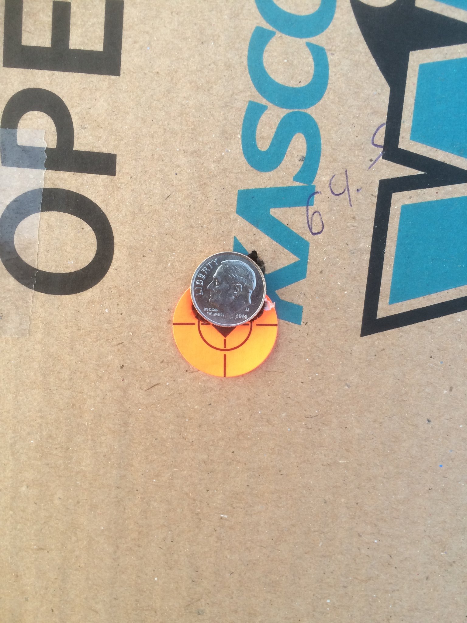

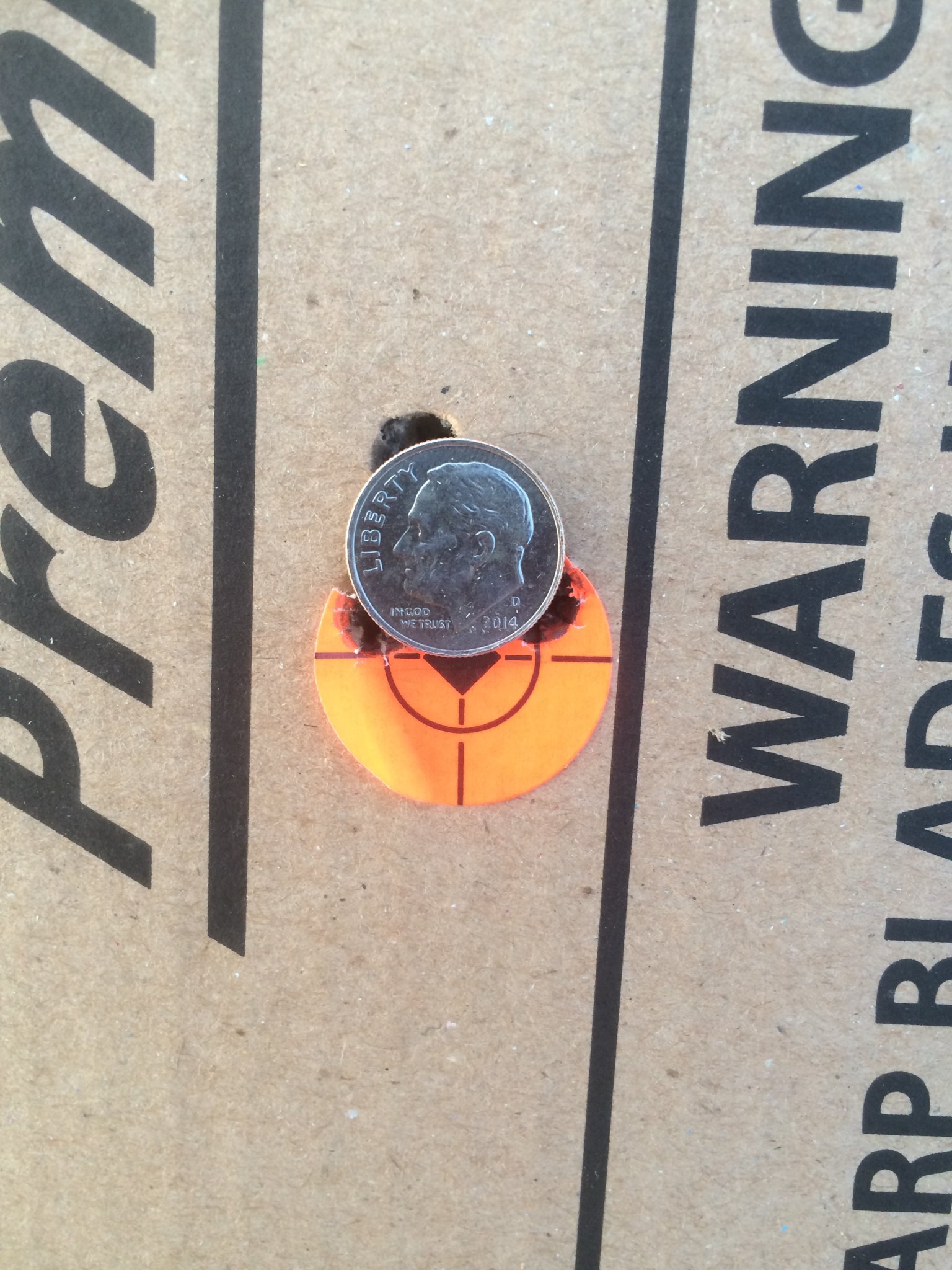

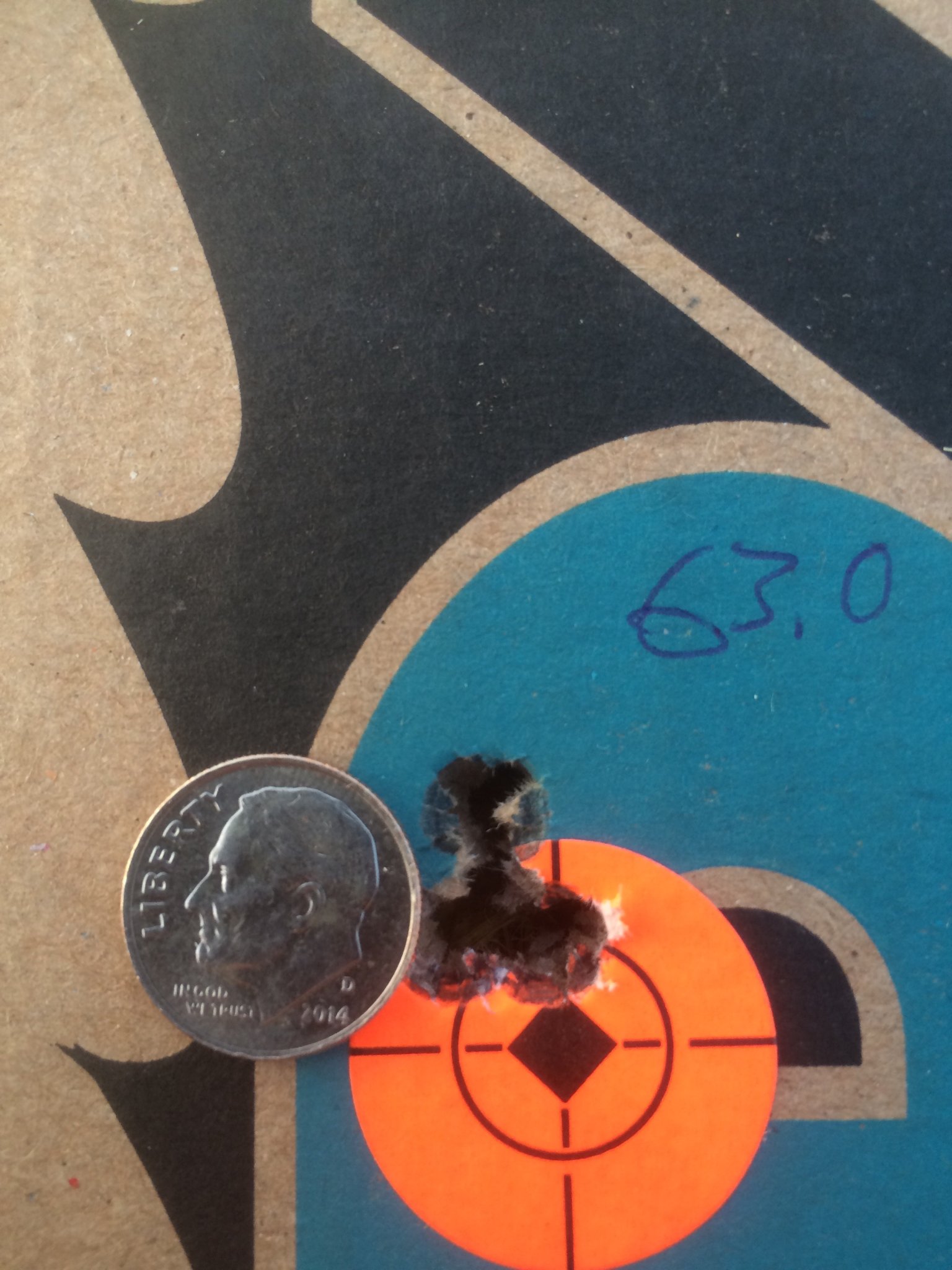

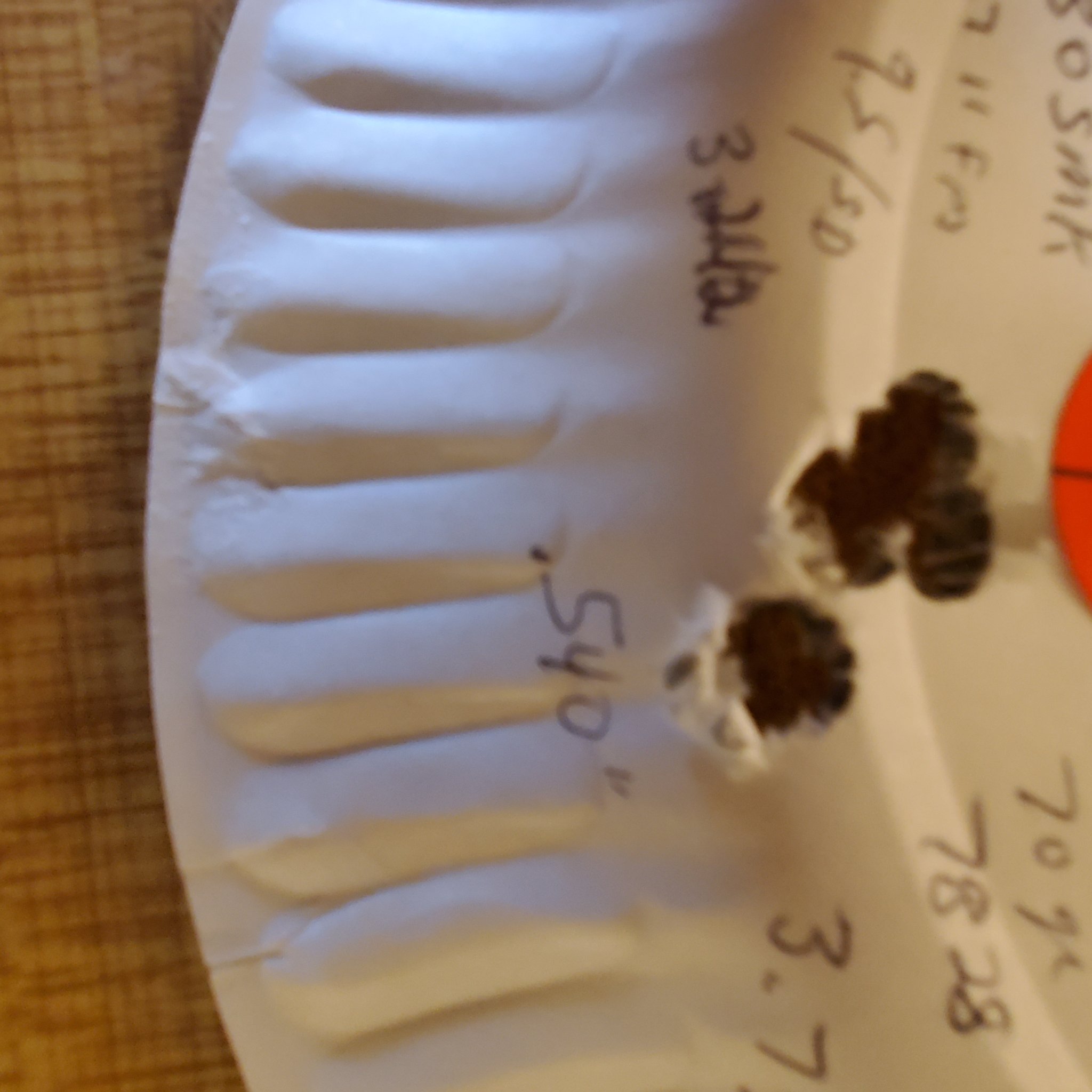

The groups above were the first outing with the rifle. All shot at the same time during load development. The charges of H4350
Powder are written next to the groups. This rifle is very forgiving as you can see which is why I kept it.
The pic of the gun in black is the same day I fired these groups
The brown mdt chassis was added later. These are two groups shot when sighting in with that chassis
Yours will probably not shoot this well. I’ve owned a lot of savages and this is the top of the tier for accuracy. I had the 338 Lapua in the BA version and had to replace the barrel as it through the first shot or two about 1 moa low

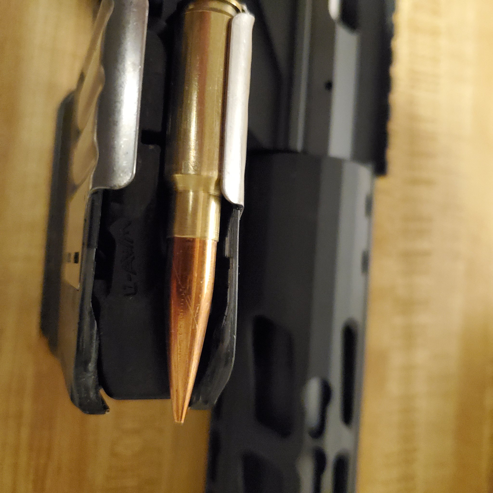

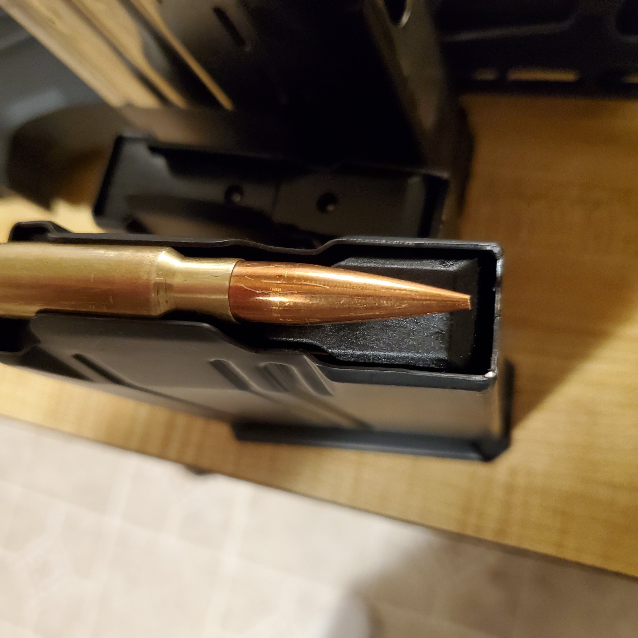

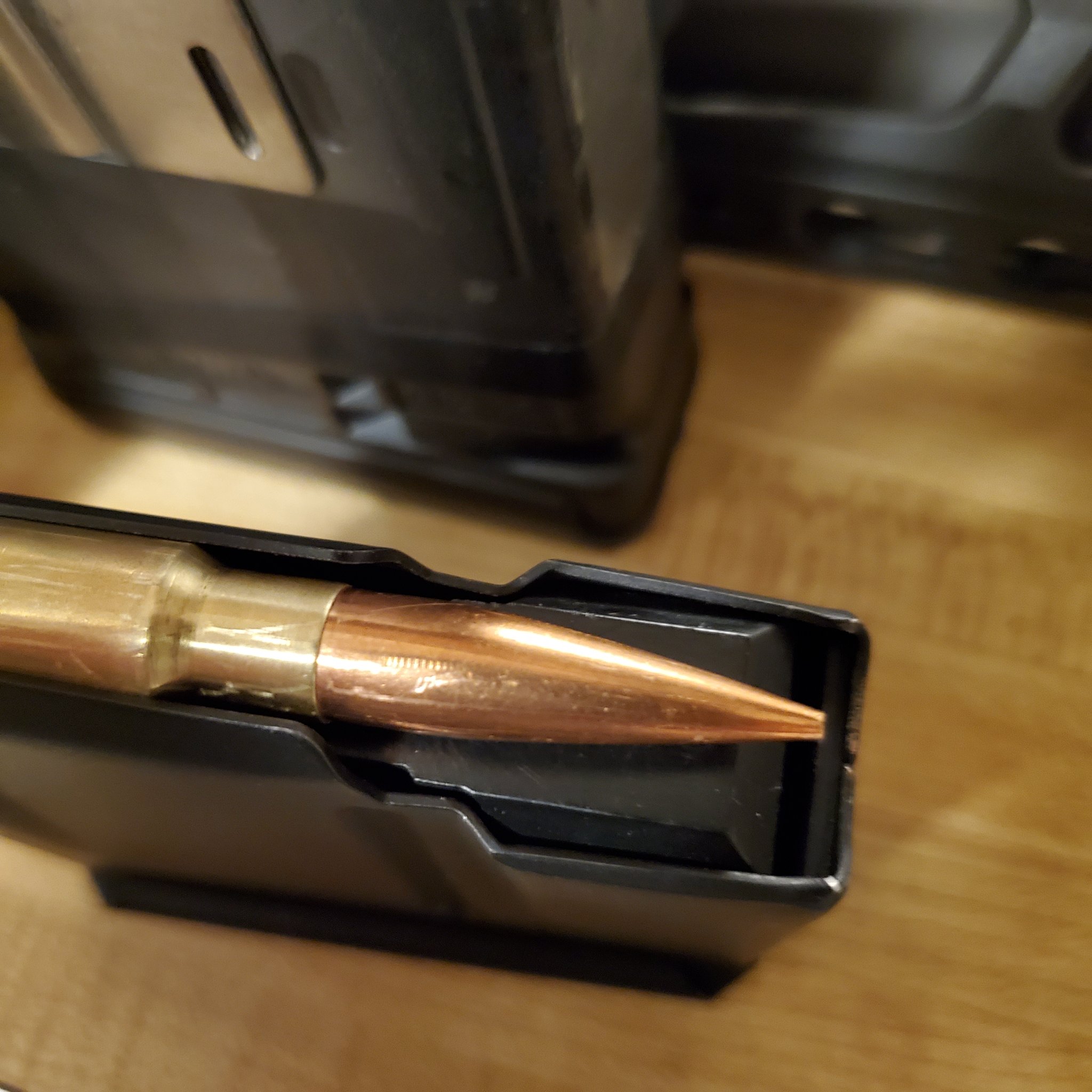

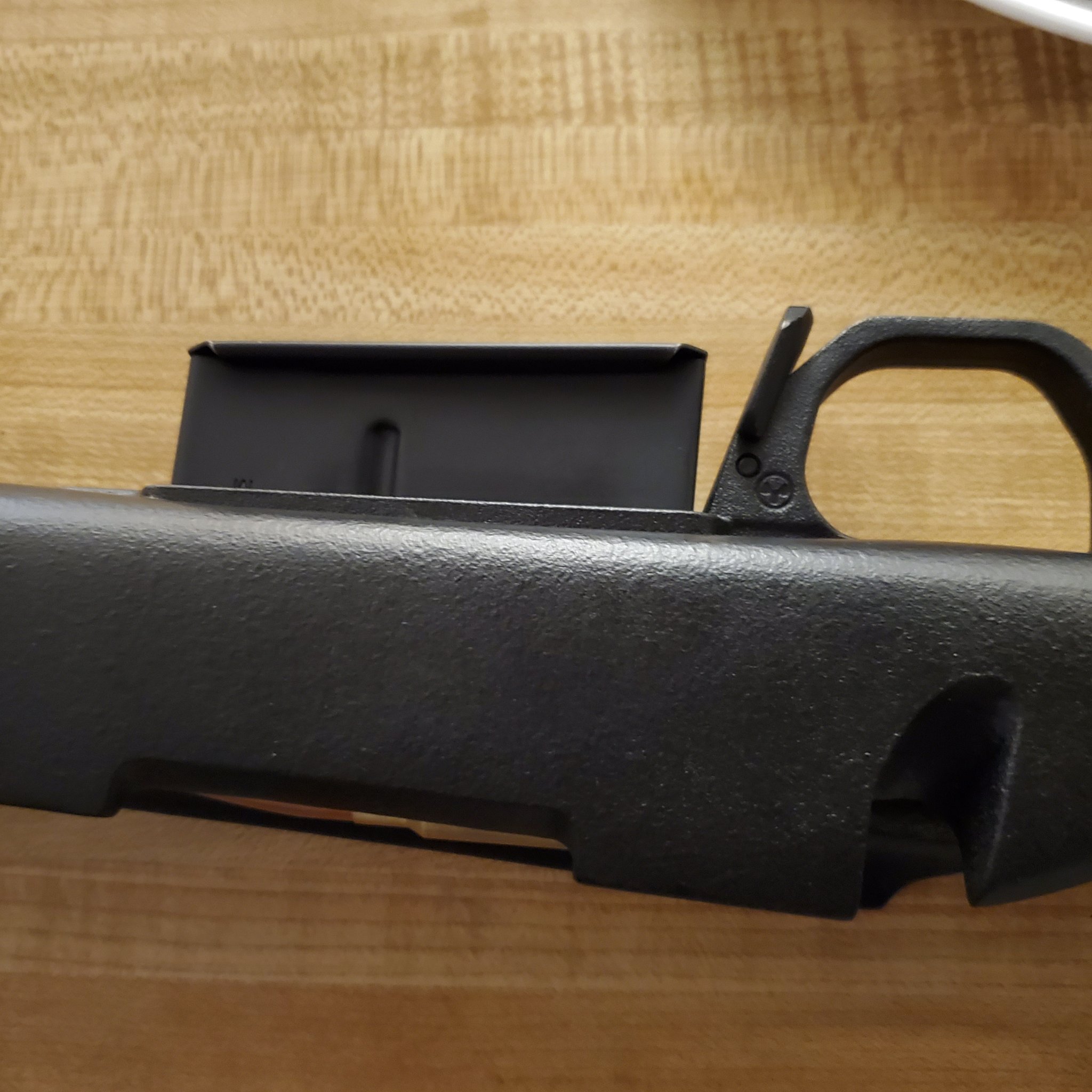

If one goes with aluminum chassis, all you do is torque down the barreled action to the chassis, with long screws provided... thats all...done

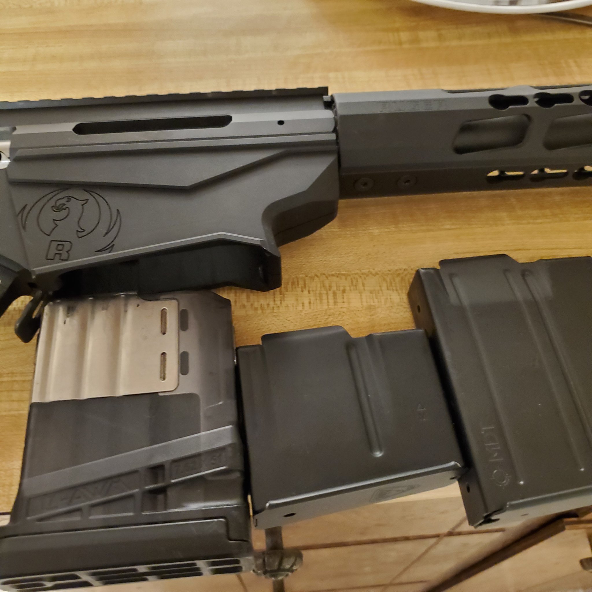

The ACIS mags fit the chassis you installed, and MDI without the center support bar takes 2.990" cartridges.
On the 700 with the $65 Magpul bottom metal only a slight inletting was needed to make it fit...it almost fit. But I'm not familiar with the Savage on this.
The Ruger PR comes from the factory, it takes both center feed and staggered feed.
Here is that example and the mags
with a 2.890" 6.5 CM for comparison...as to what mag one uses. The last one has room to spare at 2.990" max.
And the cheap Magpul 5 rd ACIS for 308 base cartridges, center feed ACIS up to 2.990"
