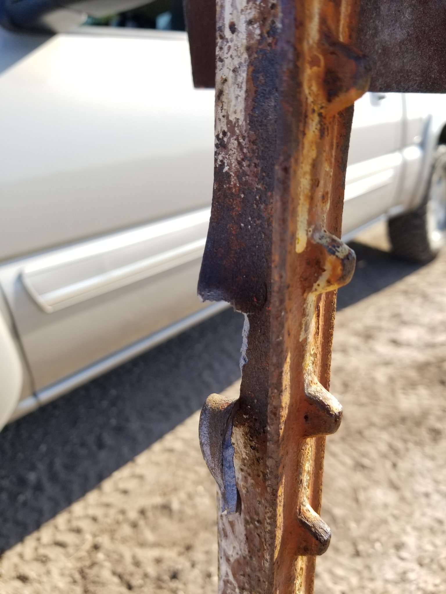

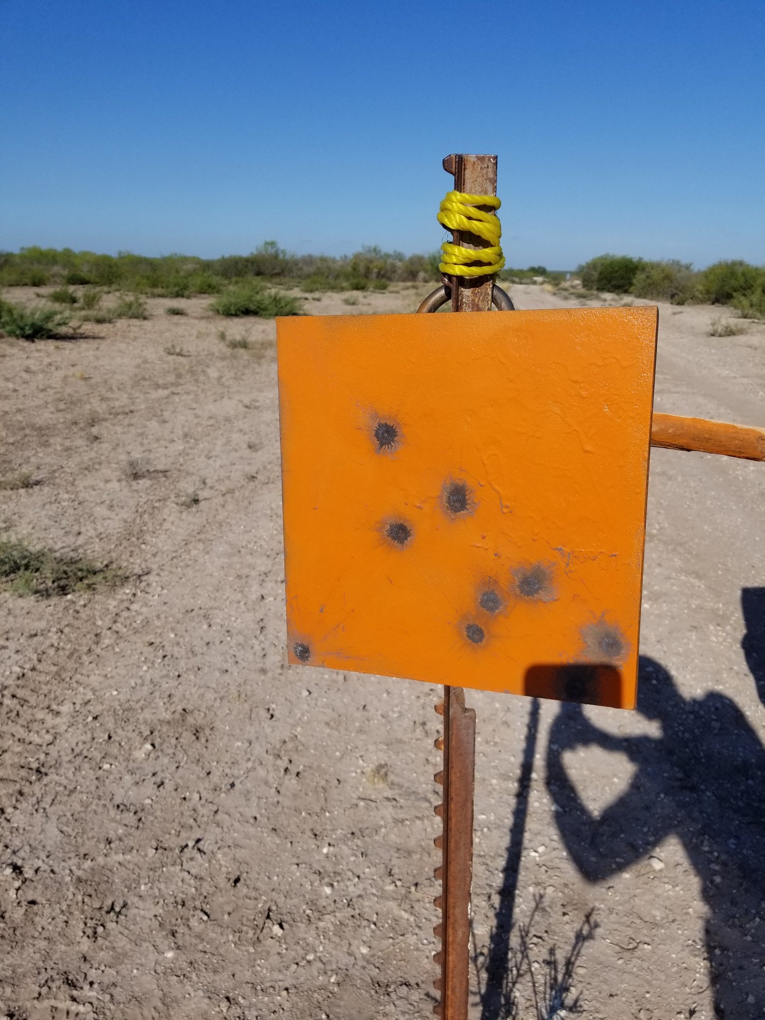

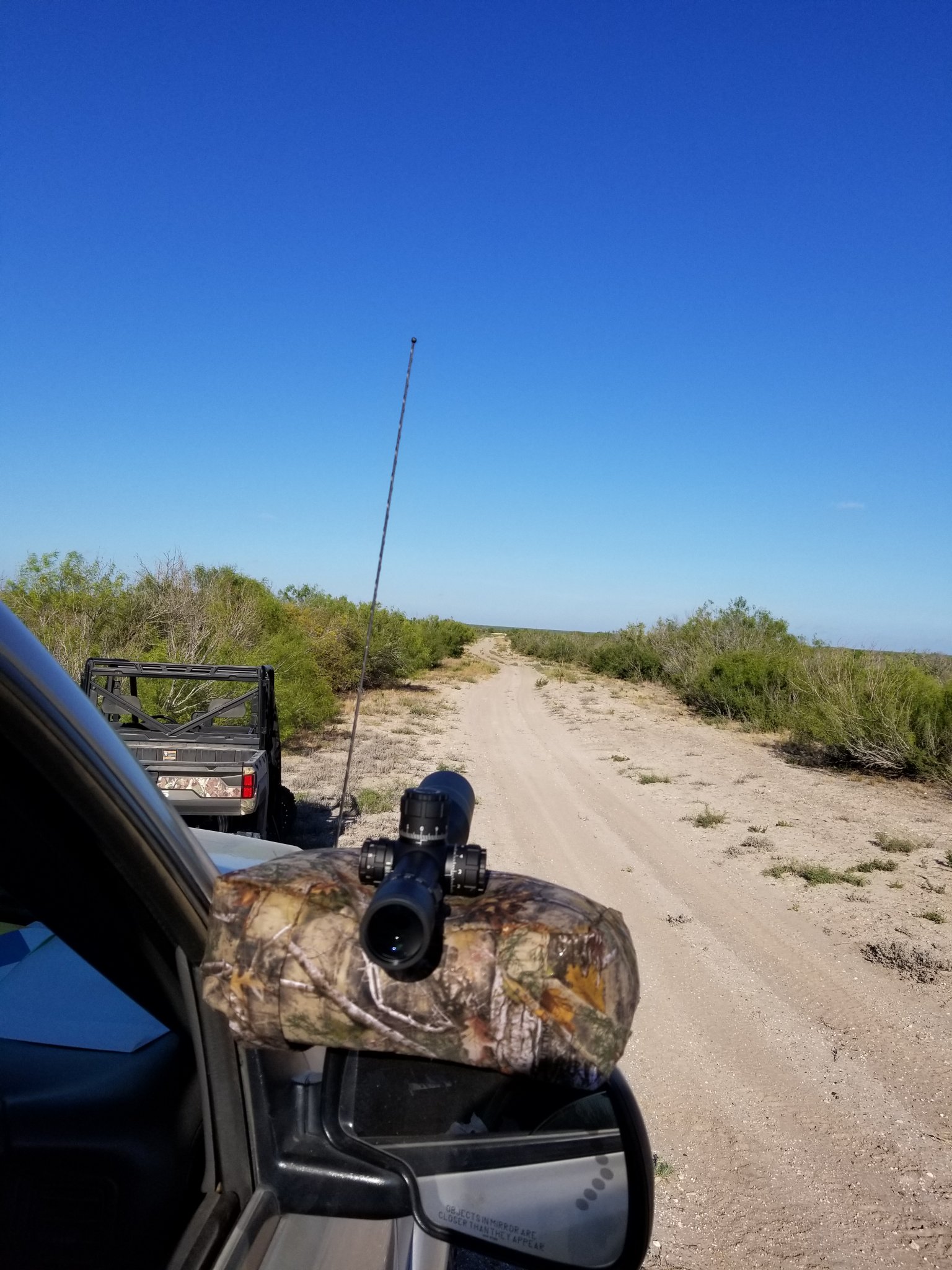

    We started off by me firing 3 rounds at 100 to confirm zero. Perfect!!! Dead on!!! I decided to move back to 200, took a few shots and got hits. Moved back to 300 and did the same. Everything was real smooth so off to 445 we went. I had trouble at first getting hits since the wind was really blowing and I had not made any elevation or bullet drop adjustments in the scope. Little by little, shot after shot, I started dialing on my scope until I got closer and closer. I was seeing splashes low and to the right. After a few trial and error shots, I was on target. I don't recall how much windage I had to dial. As for elevation, 1.8 mils put me on right on target. The person that invited me also took 2 other gentlemen. We all tried shooting the target and all of us got hits. I wasn't really going for tight groups. My main concern was just to hear the steel ring and for everyone else to enjoy and have fun. That's exactly what happened and it was a total blast. We might go again next weekend. If so, I will then focus more on stretching out more and seeing how tight I can get my rifle to group. There's an area where it's all clean land, no brush, for 2.4 kilometers so if I can one day make it to half of that, I will feel extremely accomplished. I will say though, the ballistic app I used gave me a MV of 3005.5 which I obviously think is wrong and too high. This is factory hornady black ammo. It consists of 140 grain HPBT. I have my zero at 100 and entered the amount of elevation I had to dial at 445 in order to true my MV but again, I'm sure 3005 is way too high. Anybody have recommendations on this???

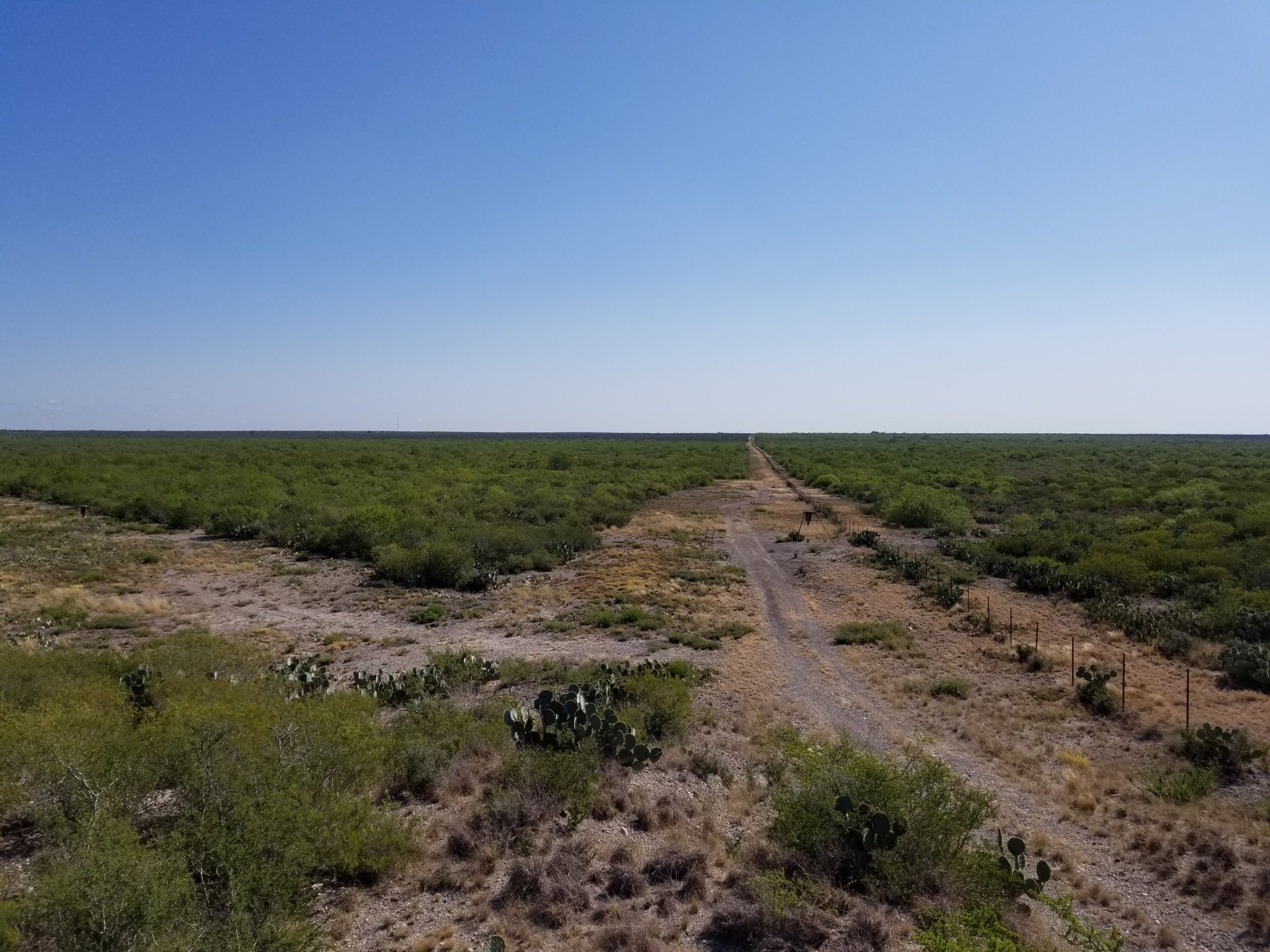

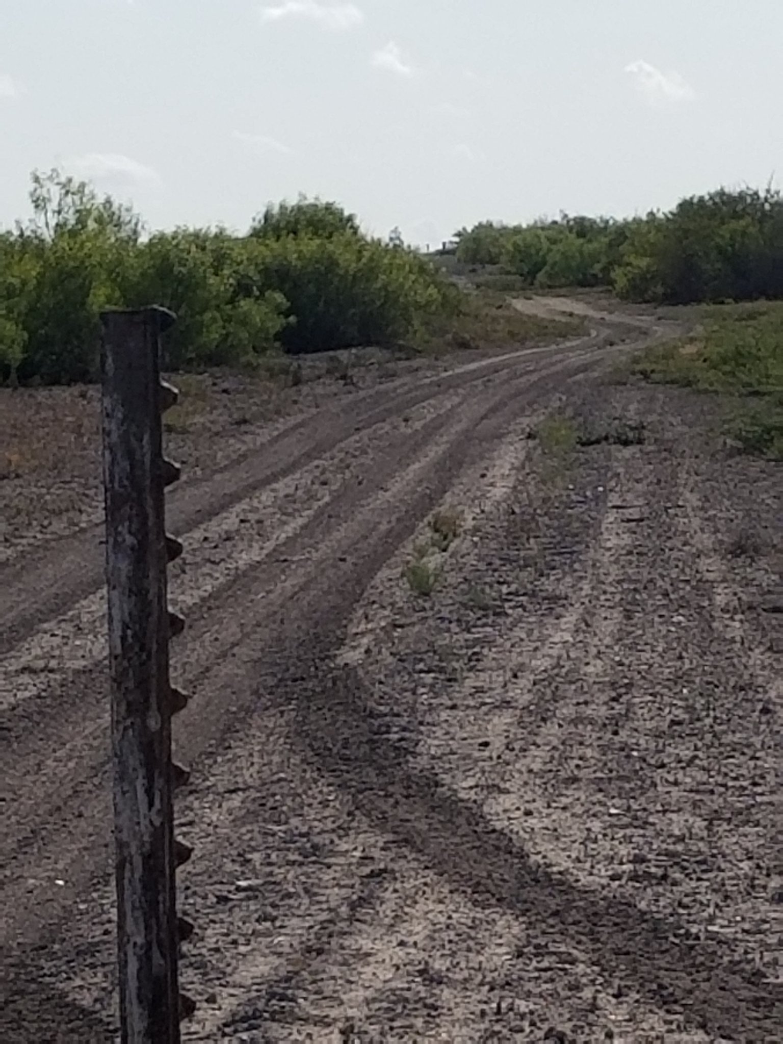

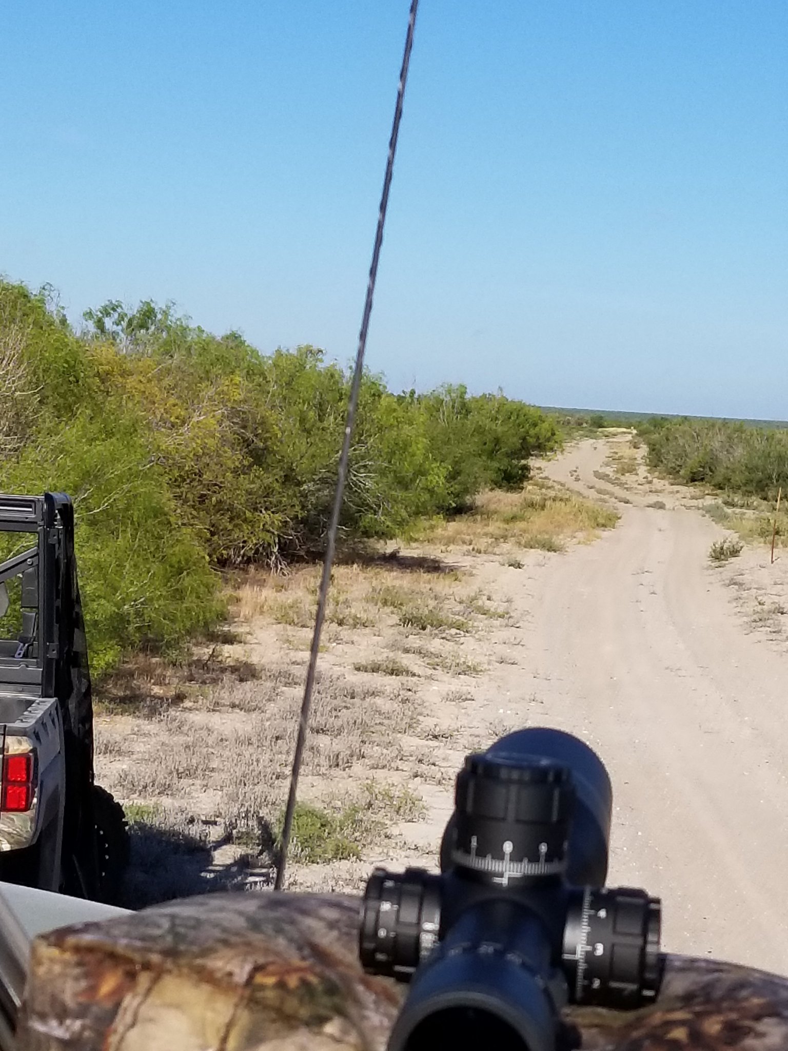

    These next two pics are from the target T-post looking towards my shooting position...
