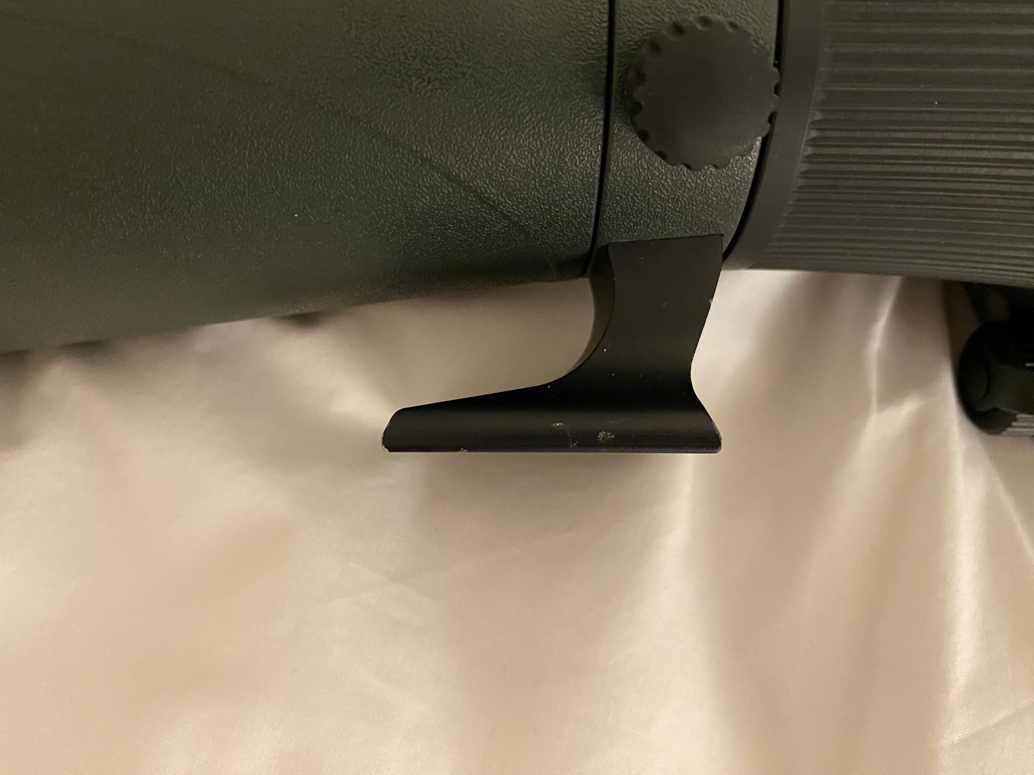

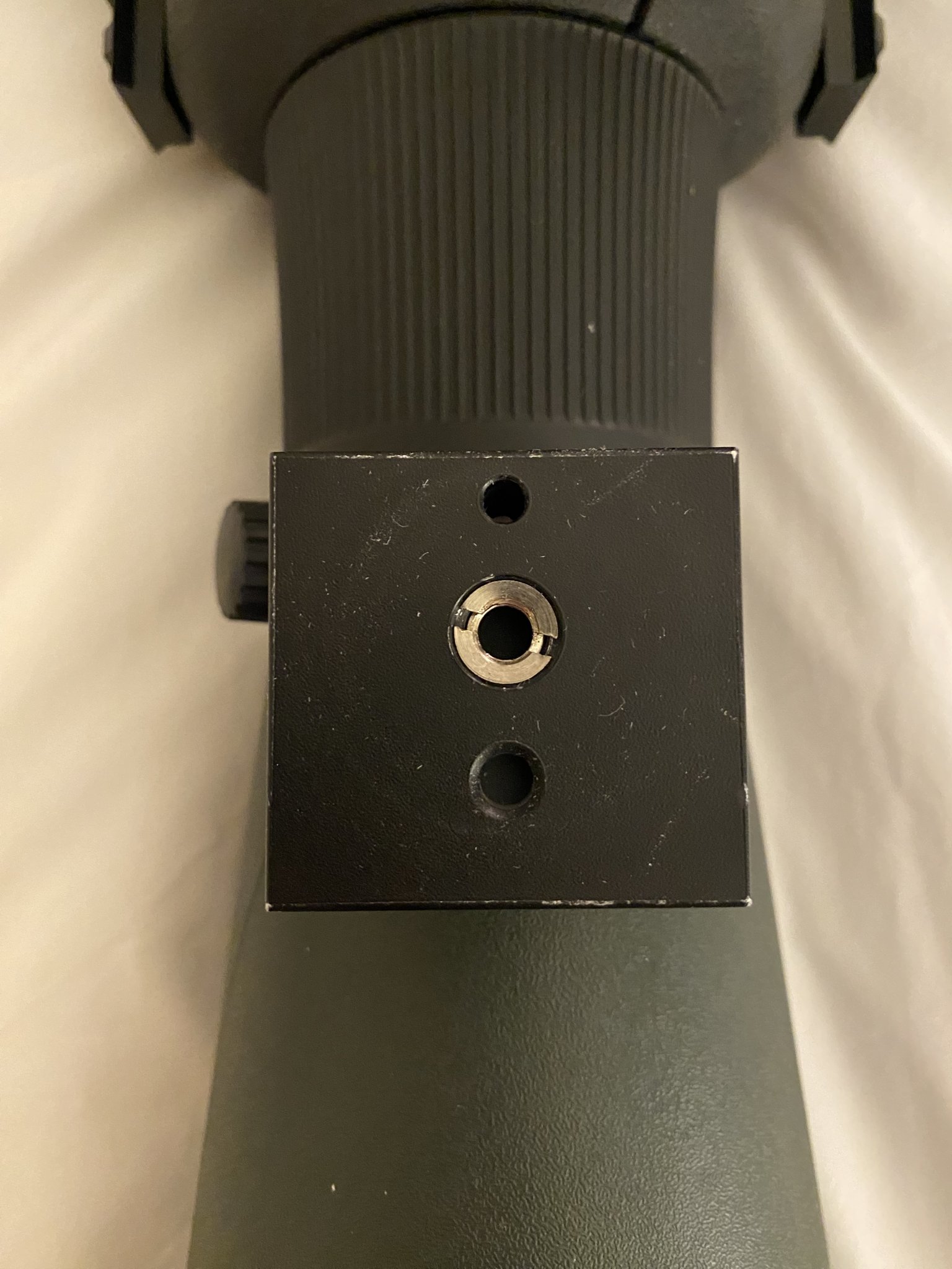

I’ve managed to get my hands on a used Swarovski spotter for ELR. I’ve done some searching, but would really appreciate recommendations for a good, sturdy tripod/head to mount it on.
Also, I don’t think mine has the Arca shaped foot on it (pics below). What’s the best/most stable way to mount it?

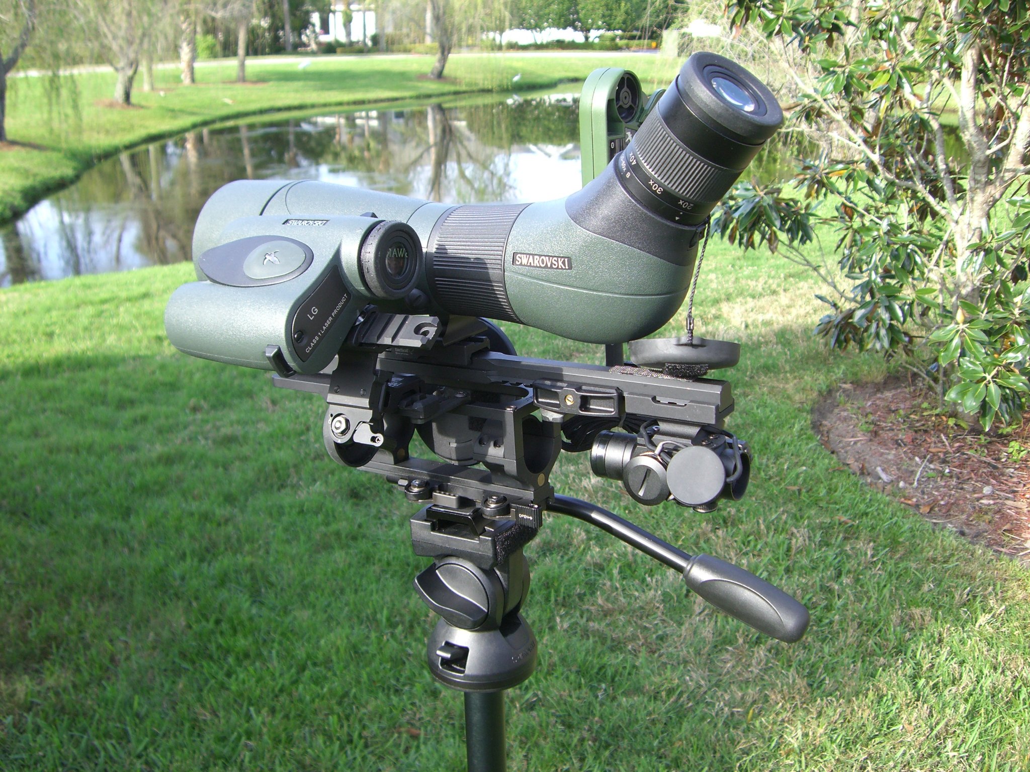

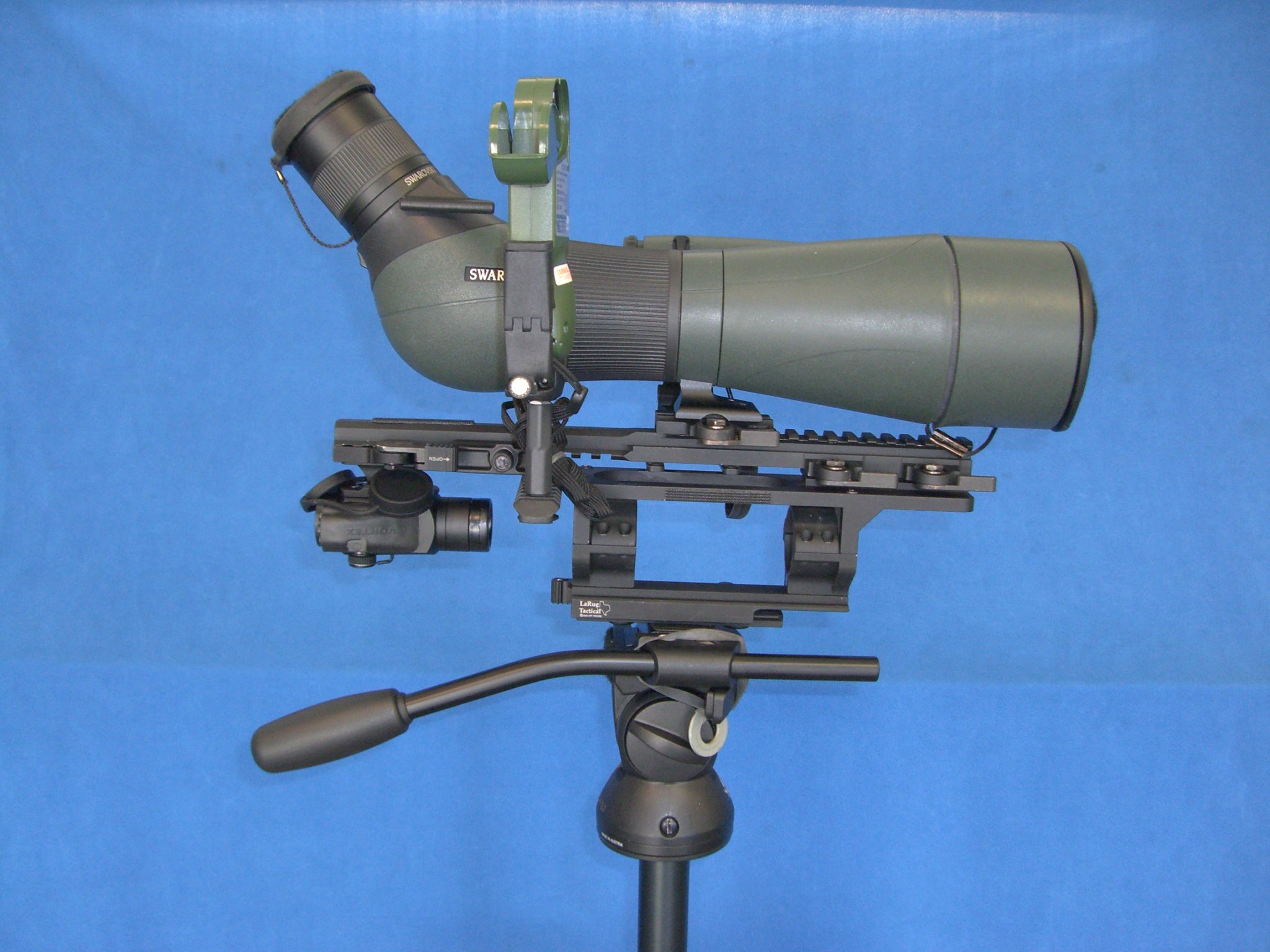

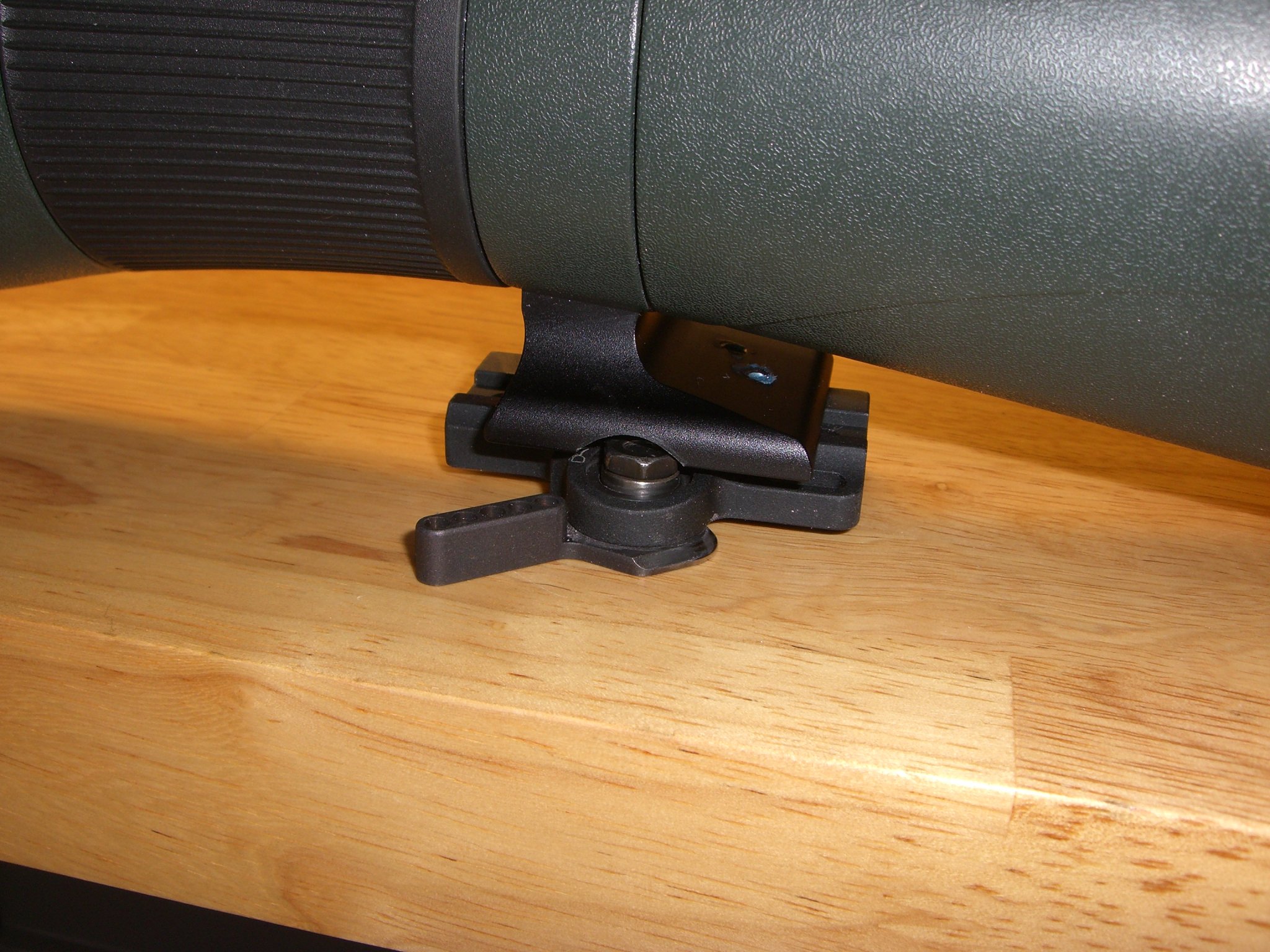

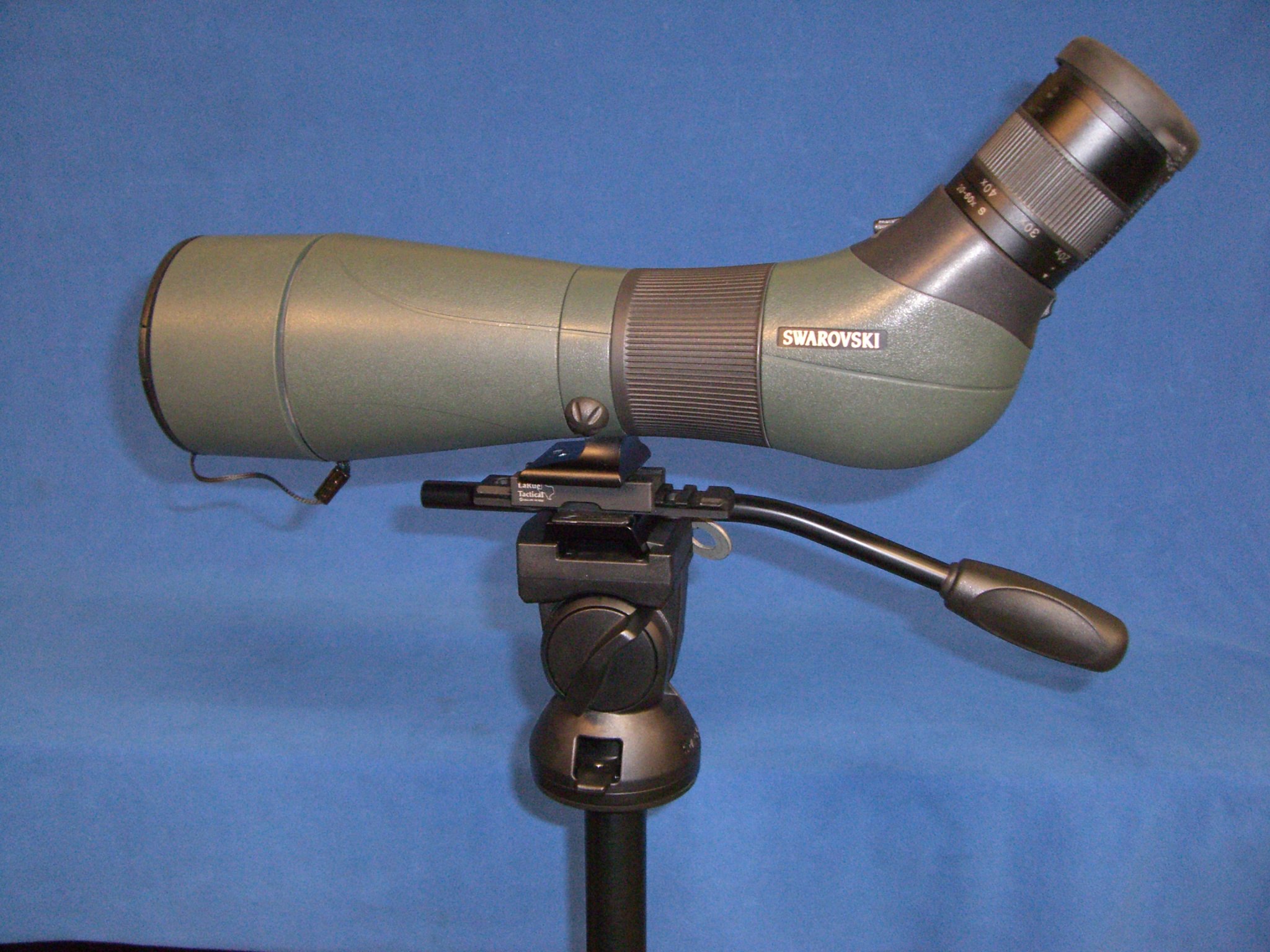

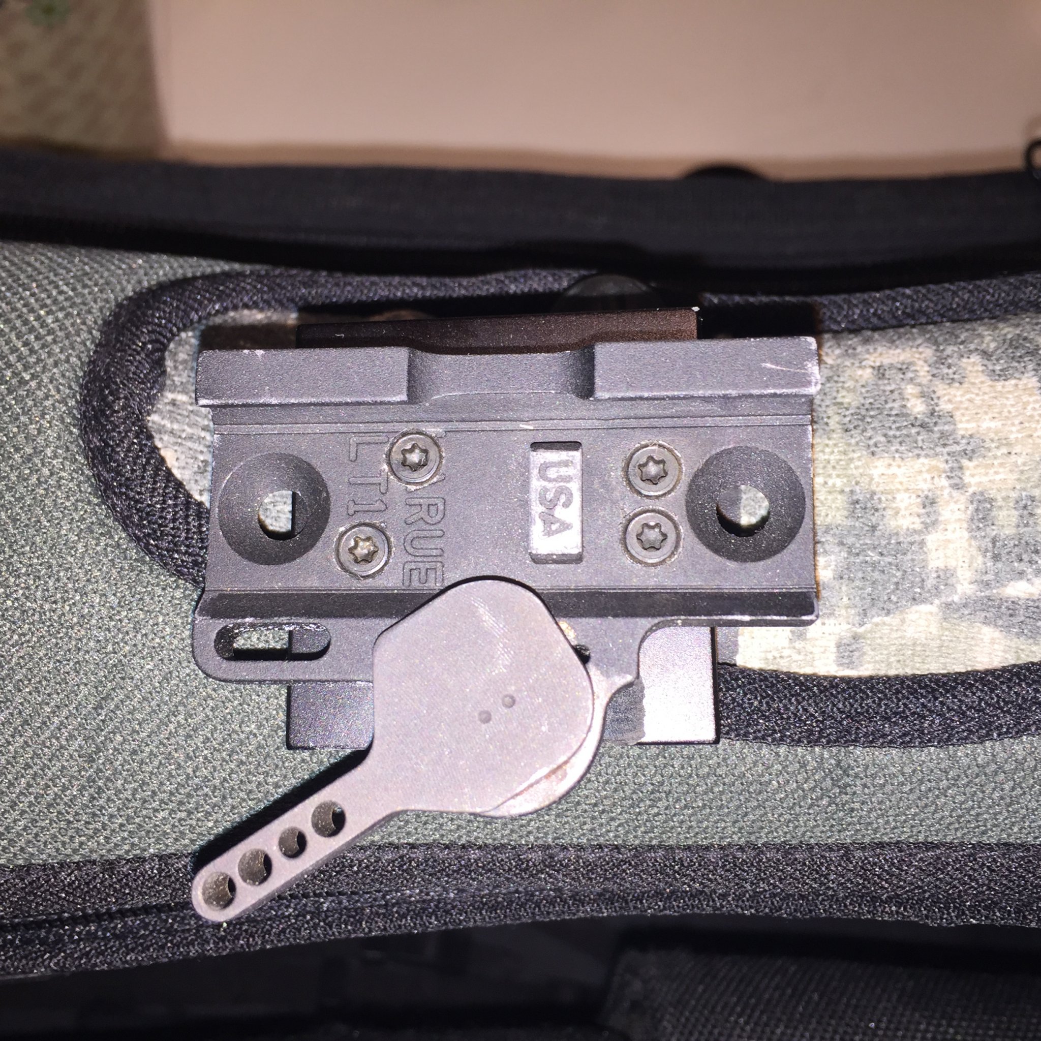

Before "plates & tables" were a thing I used a LaRue qd picatinny mount on a Swarovski carbon fiber tripod. I use mostly RRS kit now.

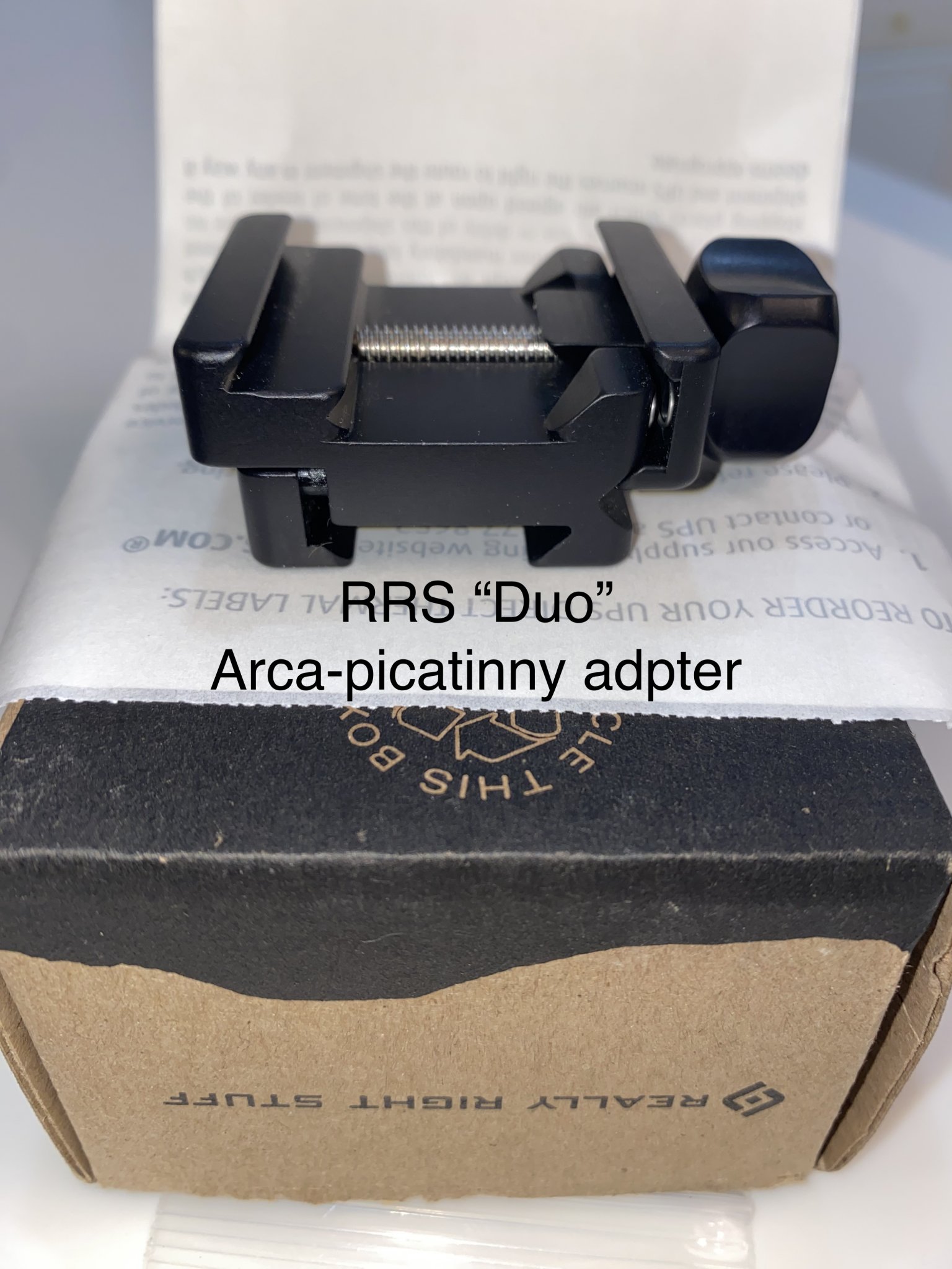

You could configure the "duo" in a similar fashion for either picatinny or arca attachment.
