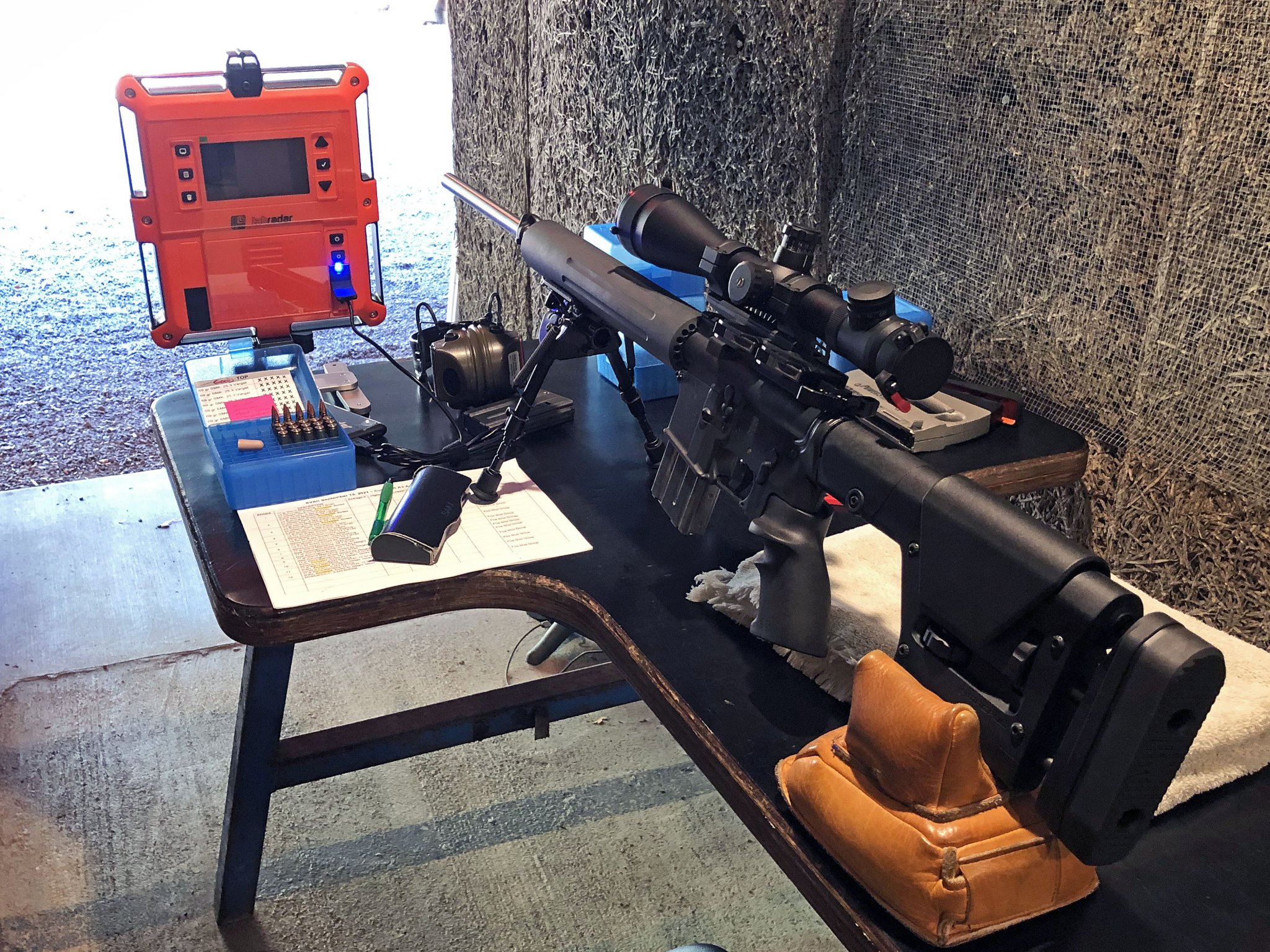

I have a Colt CR6724 Accurized HBAR Elite AR15 with a 24” heavy stainless steel barrel chambered in 223 that is an absolute joy to shoot. I can easily shoot ½” or less groups with N133 powder and 52gr SMK bullets. 69gr SMK’s group under an inch.

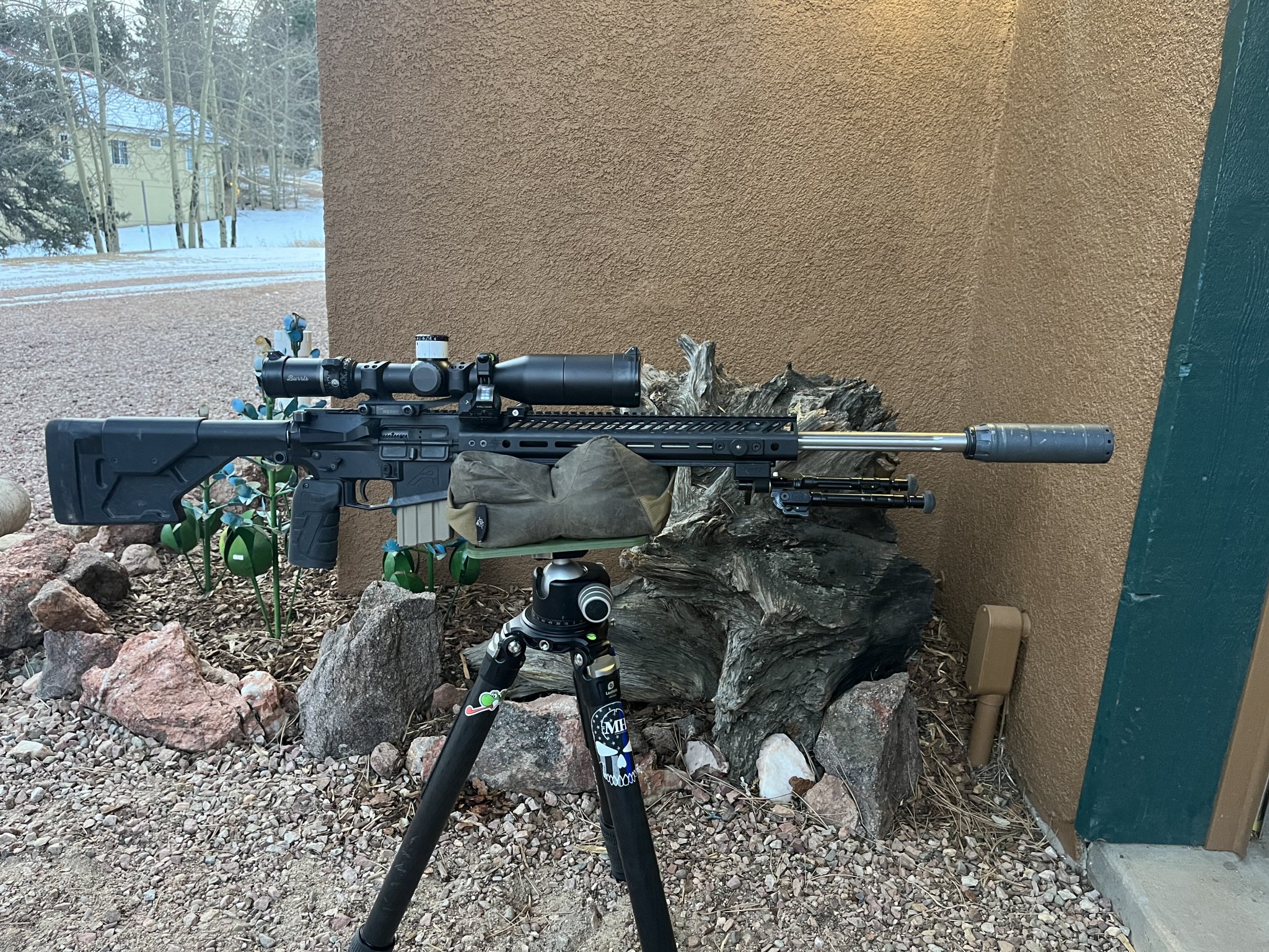

I have both Krieger and Bartlein from CLE. Same twist, same 20". Of those, the Bartlein is slightly more accurate, but this proves little. lol
And also, it is a myth that shorter barrels shoot more accurately. I would argue the opposite, unless its strictly, like 50 yard target or something. You want velocity to buck wind at distance, even 100 yards matters. I typically buy 20" barrels,. WIth very good barrels, they can do sub .5" groups with more than 5 shots. LIke here is a couple targets from 20" barrels, with .750 gas blocks, and these are 7 shot groups. So you have an N140 24.0 doing .4 group, and you have a SW Precision Rifle 23.8 doing a .2 group with 7 shots. But even with top tier barrels, you can see many groups in the .6-.7 range when you take even 7 shots. You can see I commented how accurate each group is with 7 shots, then took best 6, then best 5. So you can see BIG difference between best 5 and all 7. in the .2" group, 6 shots were in the .1 territory.... in my opinion, that was rare day, because its not repeatable over and over. But around .5 is in "some barrels". AR15's commonly do flyers for various reasons...
