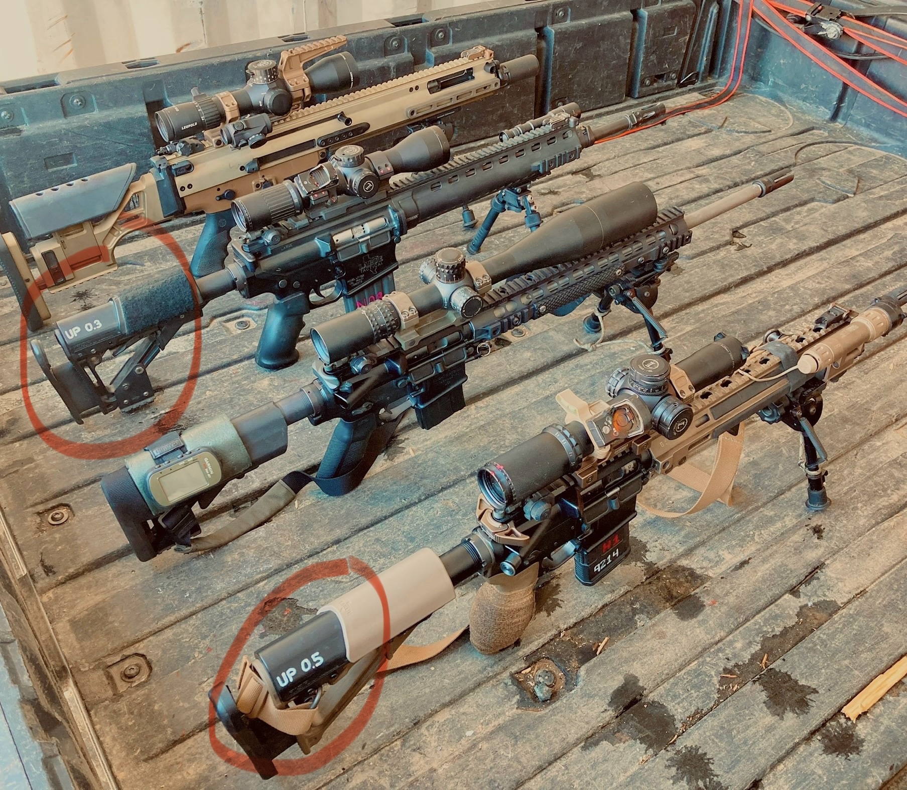

So what I’d recommend is mapping out any mechanical POI shift and document the correct in angular units. I like to then, using a paint pen, write that correction directly on the buttstock as a reminder.
You can then dial or hold that correction (in addition to your normal elevation) as need as the situations present. I feel this is better than compromising a solid 100y zero with the “averaging” technique.
