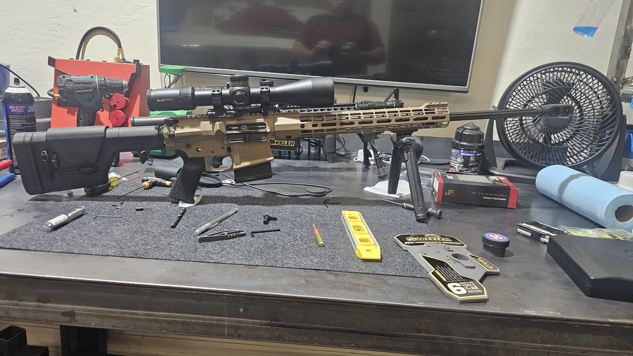

I built an aero m5 in 6.5cm and I had a hard time getting the buffer correct. Went through 5 or 6 different ones until I got a enclosed piston style. I adjusted the gas until I got elections to go to 4 o'clock and it has been great ever since. With the wrong buffer it was all over the place.
I'm working on load development for it now but sub MOA at 100 yards is fairly common.

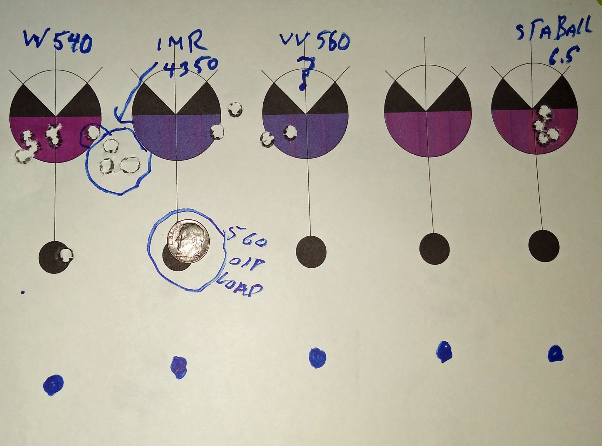

ODD indeed ,I've never experienced any difference in accuracy with any of MY gas guns . Whether single shot manual cycle or full clip throttle open ;Accuracy STAYS the same . At 165 yd. MY VV 560 load took a dump as I bumped up powder and it obviously didn't like it .

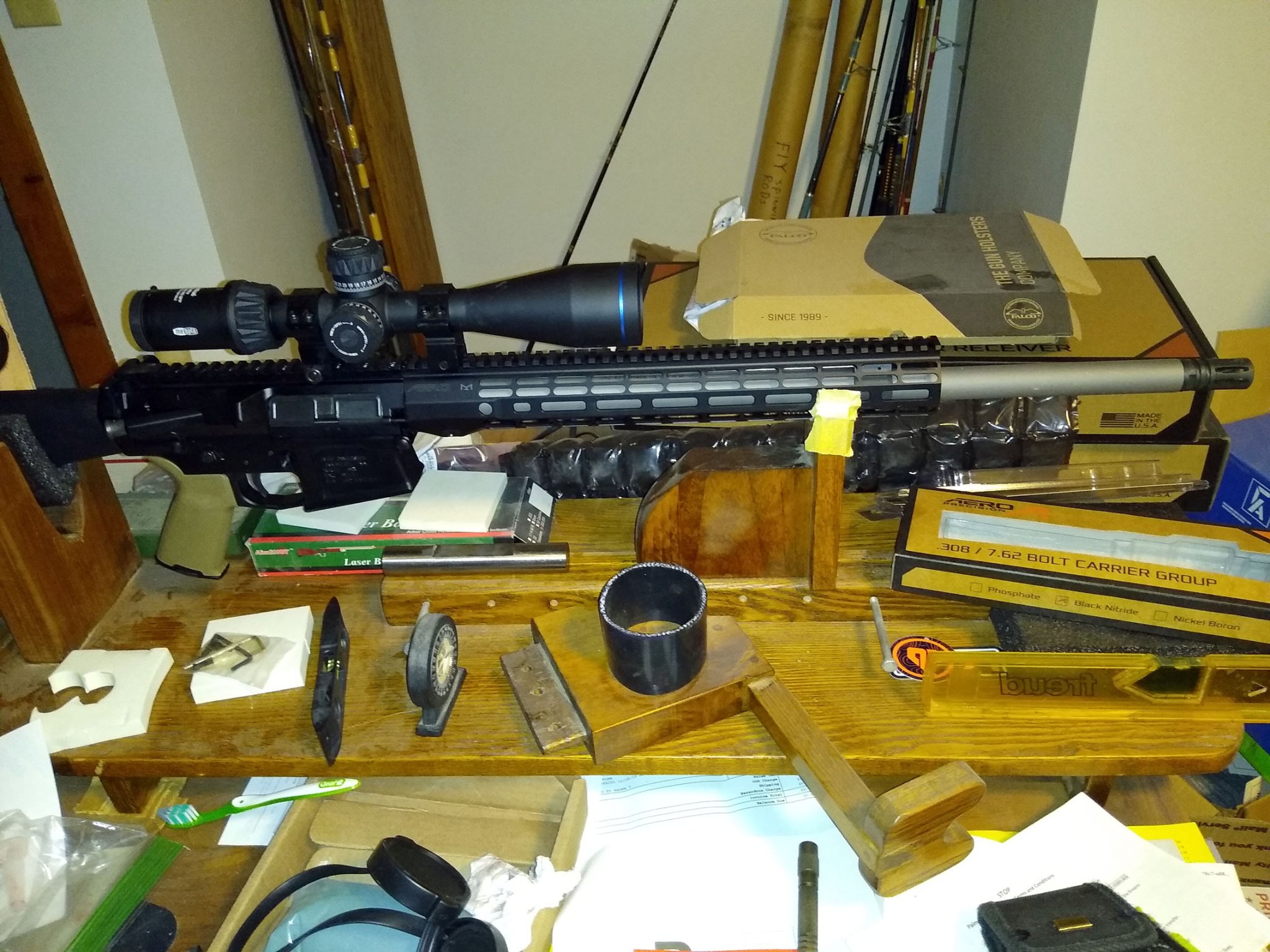

I won $110.00 at the range ,for sticking #11 ( all I had left ) old VV 560 loads with 143 grain Hornady pills and 6.5 StaBall . Some guy bet Me I couldn't put them under a dime at 200 yd. . He asked ME to change point of impact ,as after #8 he was suspicious they weren't actually going into the same place . So Last #3 , I put on the dot HE called for . His Buddy was using the spotting scope . He was lucky I only had #11 shots left at $10.00 per . Aero Precision custom build 22.5"
