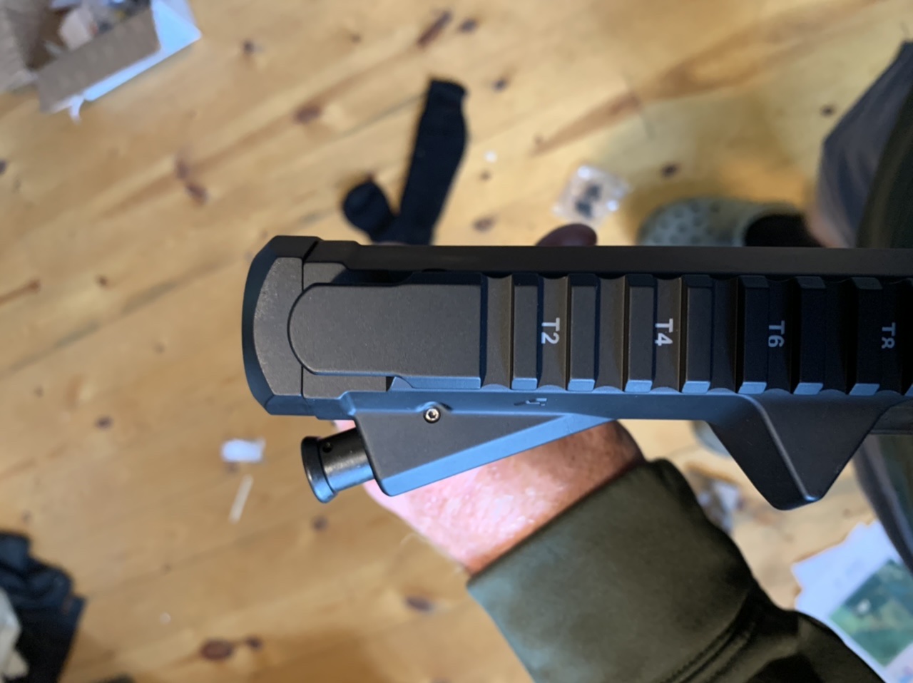

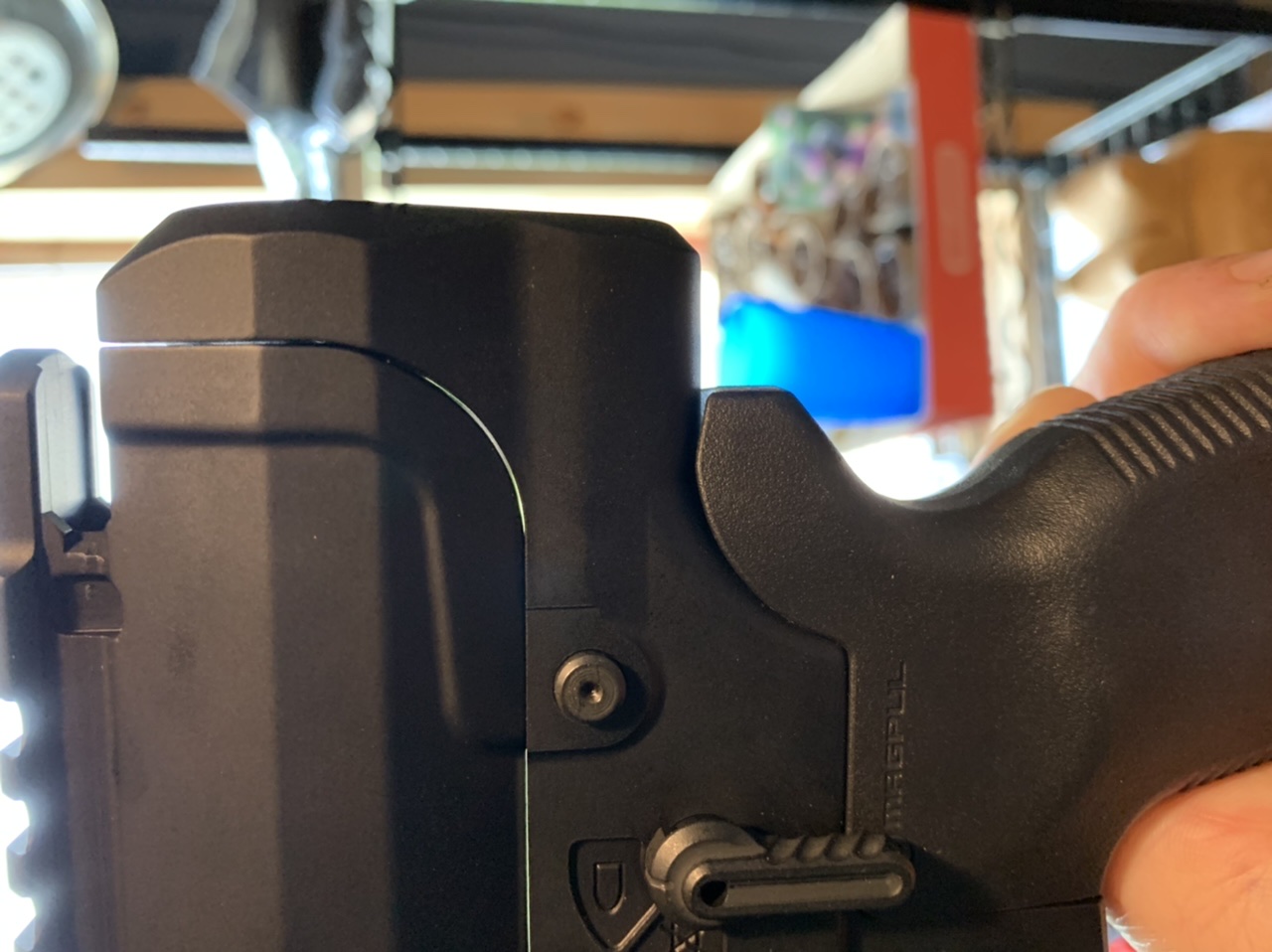

Aero M5 Receivers not lining up
jb0311
Professional Button Pusher
  • Jan 22, 2019
    1,329
    2,051
    NC

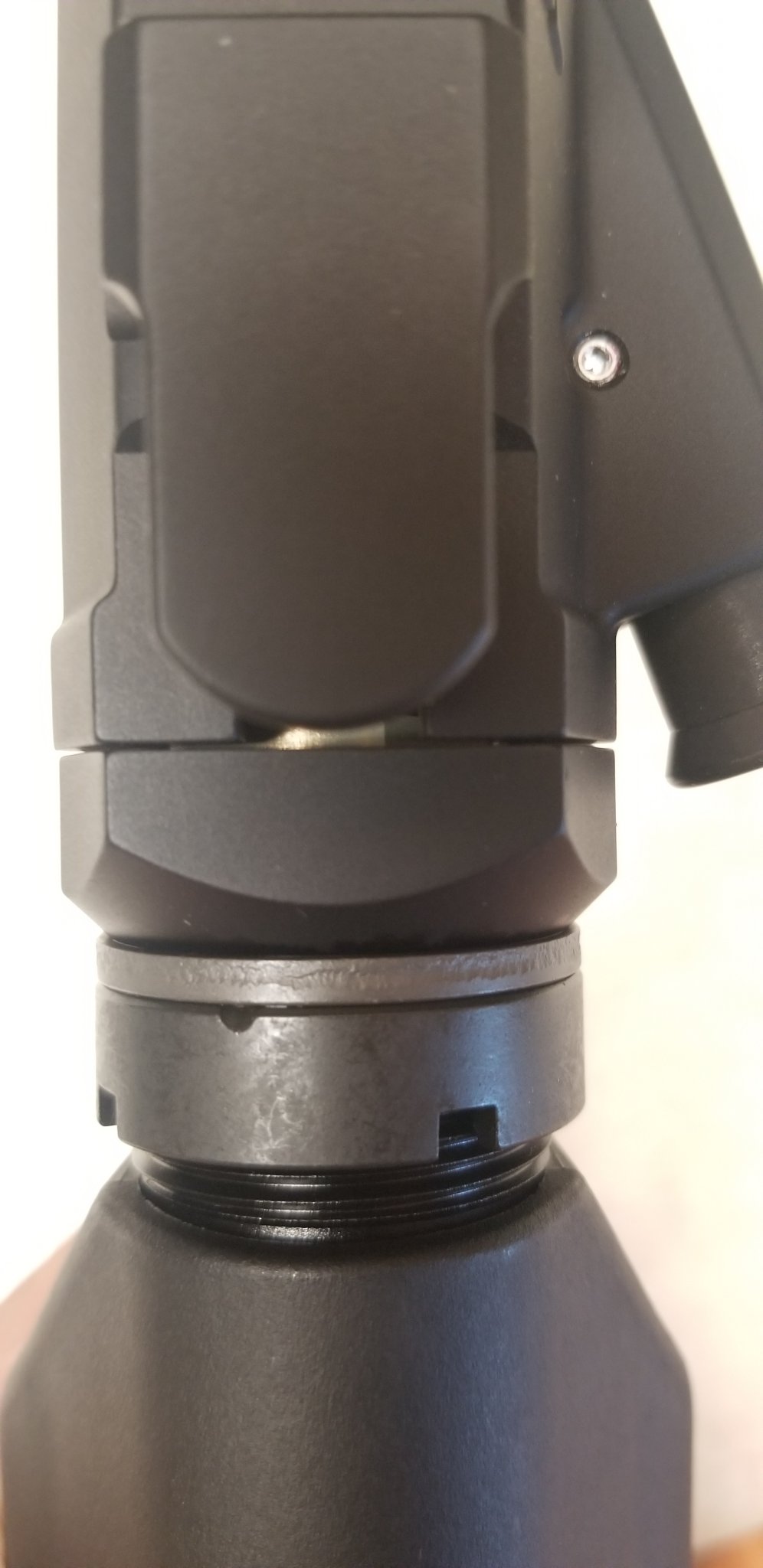

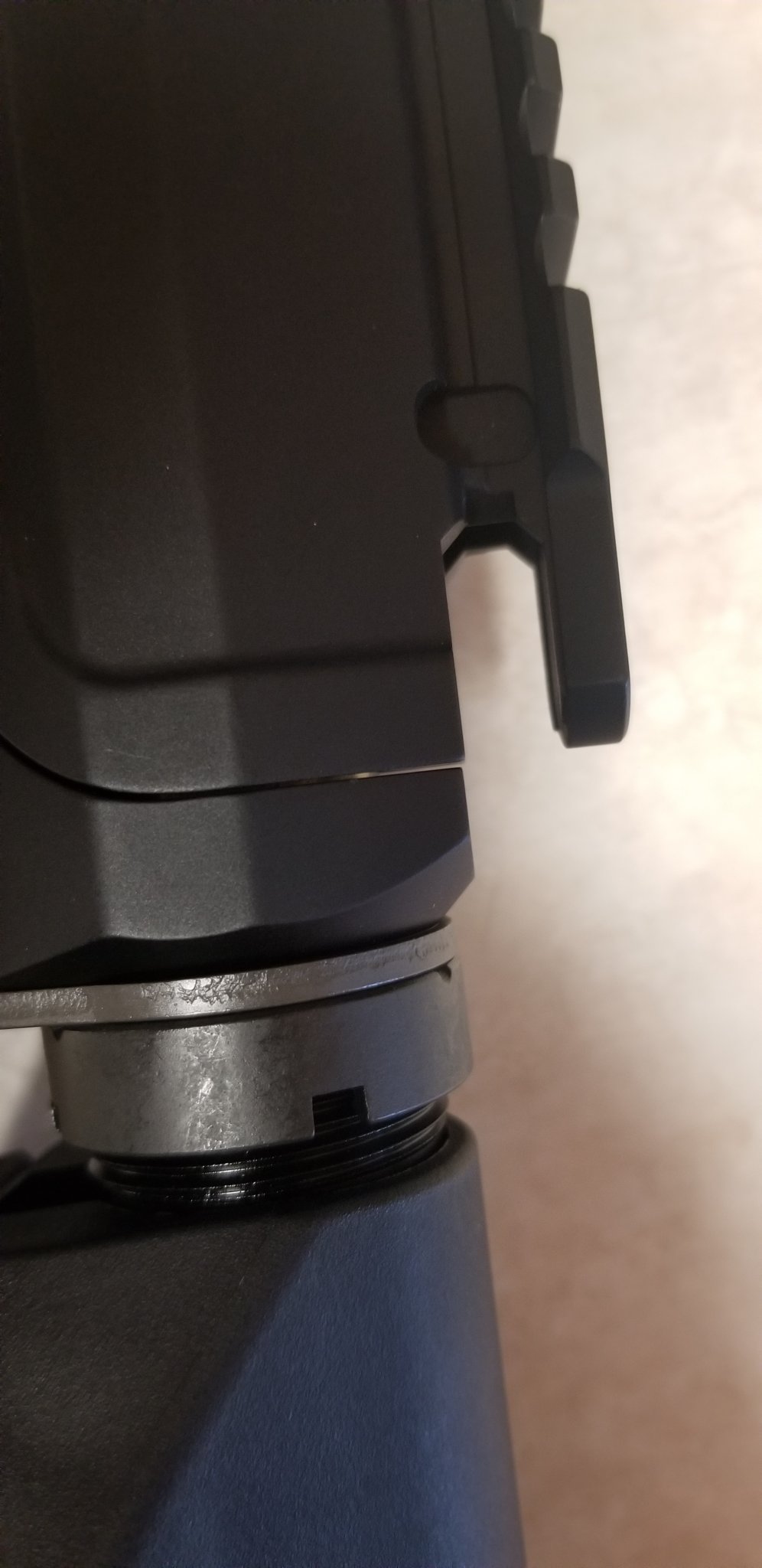

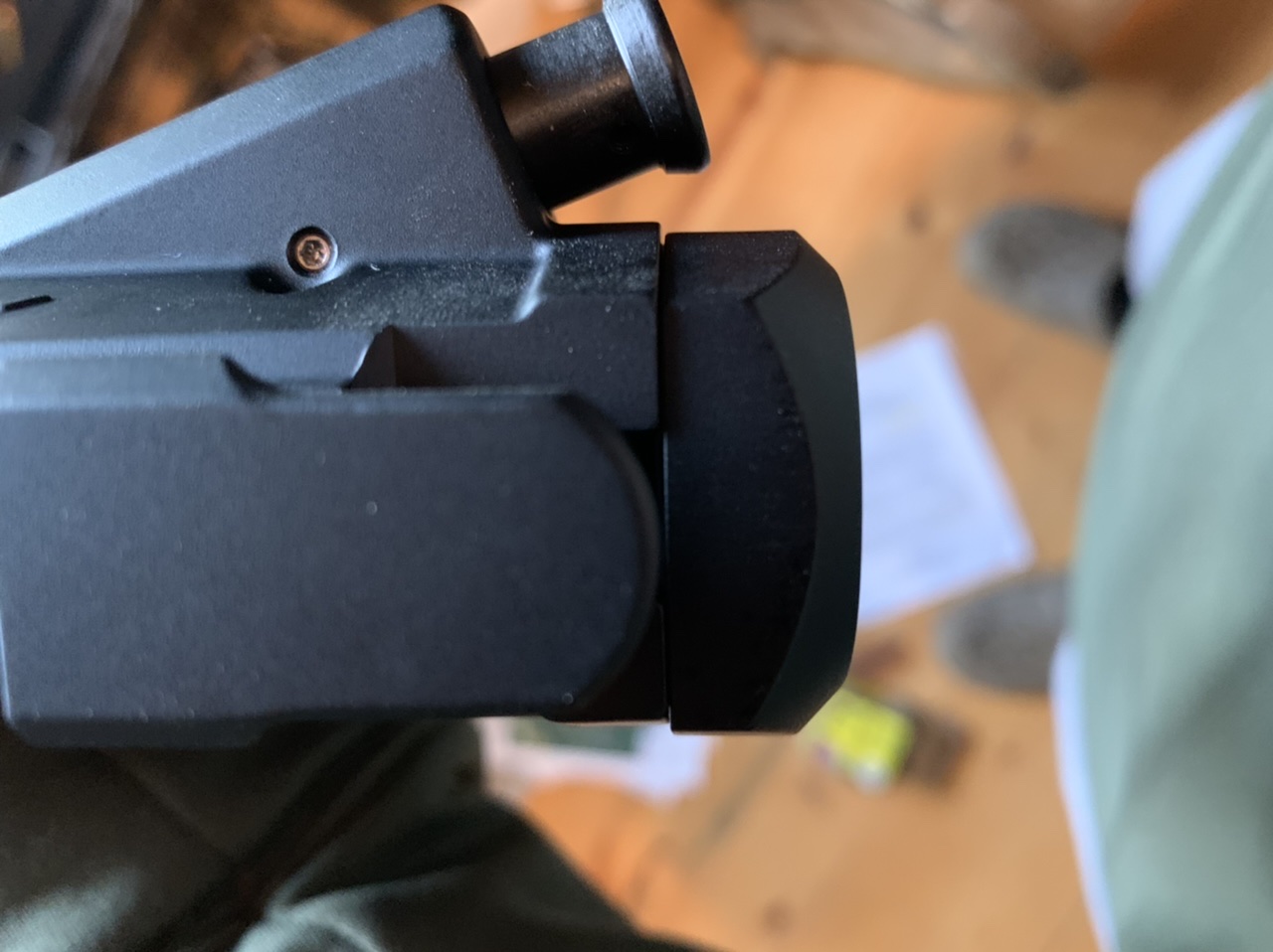

    I’ve had good luck with their small frame receivers but has anyone ever have a set this far off?
    The front looks fine but I’ve never seen a set this far off before, even using shitty Anderson lowers for small frame builds. Too late to return anything from the dealer. Reached out to aero’s CS just to see what they say but not optimistic on getting anything swapped out since it wasn’t purchased direct. I know aero is basically budget but I would have expected better quality here. Can’t tell if the issue is with the upper, lower, or both. Is this going to be a purely cosmetic issue ? If it was just the gap I wouldn’t mind as much but the off-square has me a little hesitant to finish the build. Thoughts?
    Will update if Aero responds to me.
    Thanks,
    No, my M5s look nothing like that.
    Did you buy a factory complete upper? If not, who put the barrel on and how was the upper clamped?
    Bore alignment could be off far enough that the carrier will be riding one side of the RE, so if you run it, keep an eye on wear. Also, check your tension screw, but that shouldn't twist it.
    Reactions: bfoosh006
    No, stripped receivers purchased at different times. If I bought a factory complete I would have returned from the get-go due to the fitment.
    Upper receiver has not been under any torque, barrel has not been installed, but I use a Geissele reaction rod when I do install barrels. Nothing but the FA and dust cover has been installed on the upper. It was like this from the factory.
    Good point. I'm still waiting to see how Aero's warranty will handle this but I have more money in the barrel and trigger than in both receivers combined so at this stage I do not plan on proceeding with the build until I get a set that mates up better than this.
    I also would think the uppers bore alignment would be bad.
    Or maybe better said.. how far off can it be before the stuff starts binding or wearing badly / pre-maturely ?
    Who's pins are you using and does this happen unpinned?
    I had a set where the rear boss was about 2 thousands proud
    Using a set of battle arms enhanced I had laying around. The rear take down pin was a little tight when installed so I backed the set screw out a bit but the receivers fit the same with or without the pins.
    They are just slightly longer because the recievers are thick in that area. I built an m5 on a luth ar normal kit and the pins just don’t protrude far enough to push by hand and need to be pushed with a bullet. No other negative effects.
    Aero recommends using their M5 LPK. It uses "custom" takedown and pivot pins.
    (Not saying this will necessarily fix the prob, but something to look into)
    I do have a spare set of M5 pins as well but the BAD pins seem to fit fine and do not change the fit of the receivers when pushed in.
    Im going to see what Aero says (I put in a help ticket yesterday) and in the mean time try to figure out definitively if the upper or lower is the problem. The front of them lines up perfect but it almost seems like the rear of the lower may be causing the issue.
    Update as I believe in giving credit where it is due:
    Aero responded to my help ticket in a little over a day and are sending a shipping label for the upper to check first as that is most likely where the issue would be. Sounds like they will also have me ship the lower if MN allows to check fitment with new upper. That is quality CS in my book.
    Or I could take Hobo’s advice and sand paper and sharpie it?....🤦🏼‍♂️
    I will update again with any findings but thanks for the contributions.

    Really glad to see Aero is taking care of you, even though it wasn't purchased from them directly. Good CS! I can speak for the 4 Aeros, including 2 M5s, that I've purchased without any alignment issue. The "they don't make 'em like they used to" portion of the thread is dumb and not worth wasting time on. Opinions are like assholes and shitty ones come from them, too.
    Reactions: jb0311
    Agreed on the CS. They even paid for the shipping which is above my expectations especially since I didn’t buy the parts direct as you mentioned.
    UPDATE:
    Aero received my set on July 22nd.
    I just received this message from Aero (4 business days later):
    "Hello Sir, I have decided to replace both the upper and lower as they both had tolerances near the edge of acceptance. This caused "Tolerance-Stacking." and resulted in the offset that you describe. I have matched an upper and lower and will be shipping them back FedEx 2Day"
    Hard to find a complaint with that CS. Perfect timing as it should get back to me about the same time as the SLR handguard which is the last part needed for the build.
