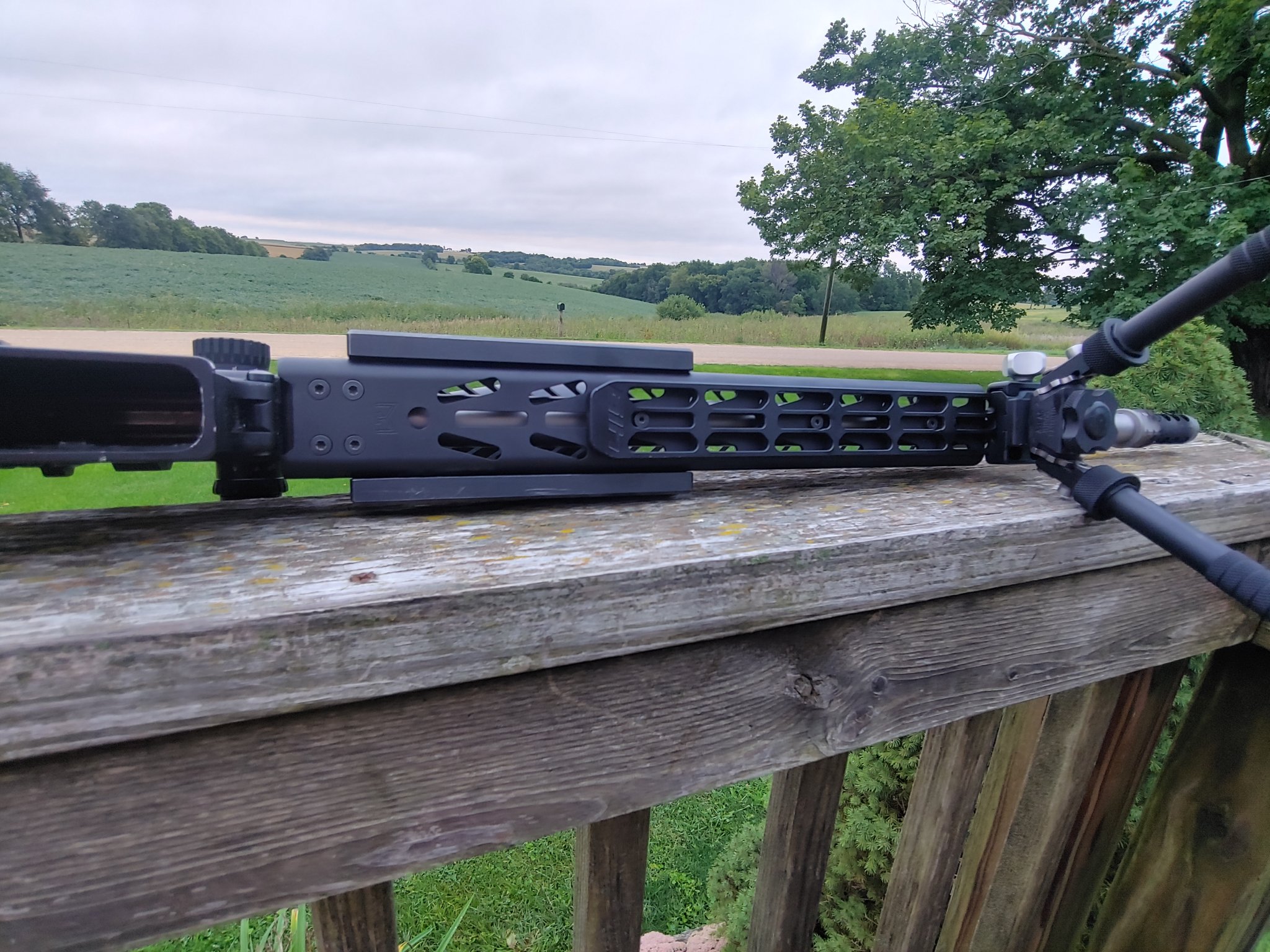

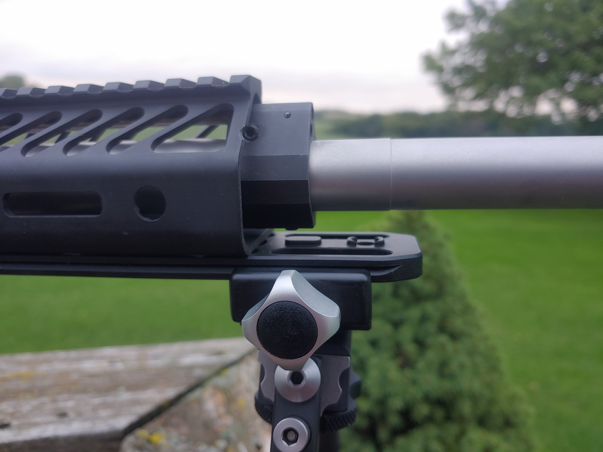

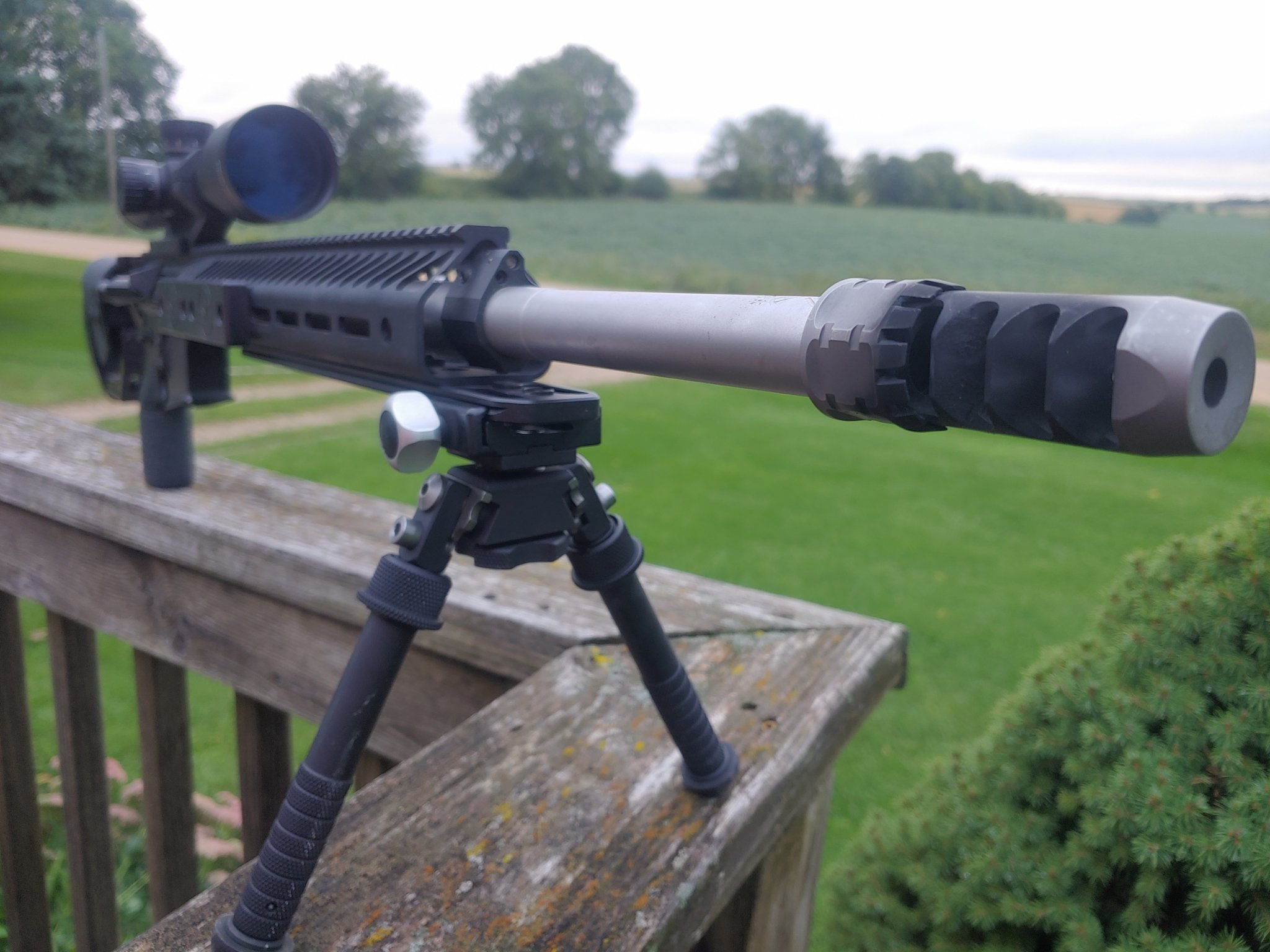

I've got the Seekins handguard on a 22" +2 barrel with an Arca rail cantilevered a couple inches past kinda like a spigot. Works fine, impossible to adjust while in position if that matters to you.
That was one of my thoughts. Do you notice any flex in the acra rail? Any pictures and details on the exact set up?
Just an Area419 rail bolted on, I think I had to shave one of the Mlok tits off of it because it landed at the end of the HG where there wasn't a slot. If I grab the bipod by the feet I can get the Arca rail to flex, but that's a lot of force/leverage and I can't see a shooting scenario that would impart that much weight into it.
