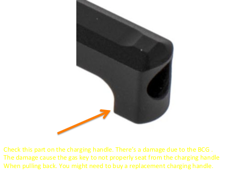

Check the pics below. Hope this help
7088051
Reactions: Tnc and jab00
