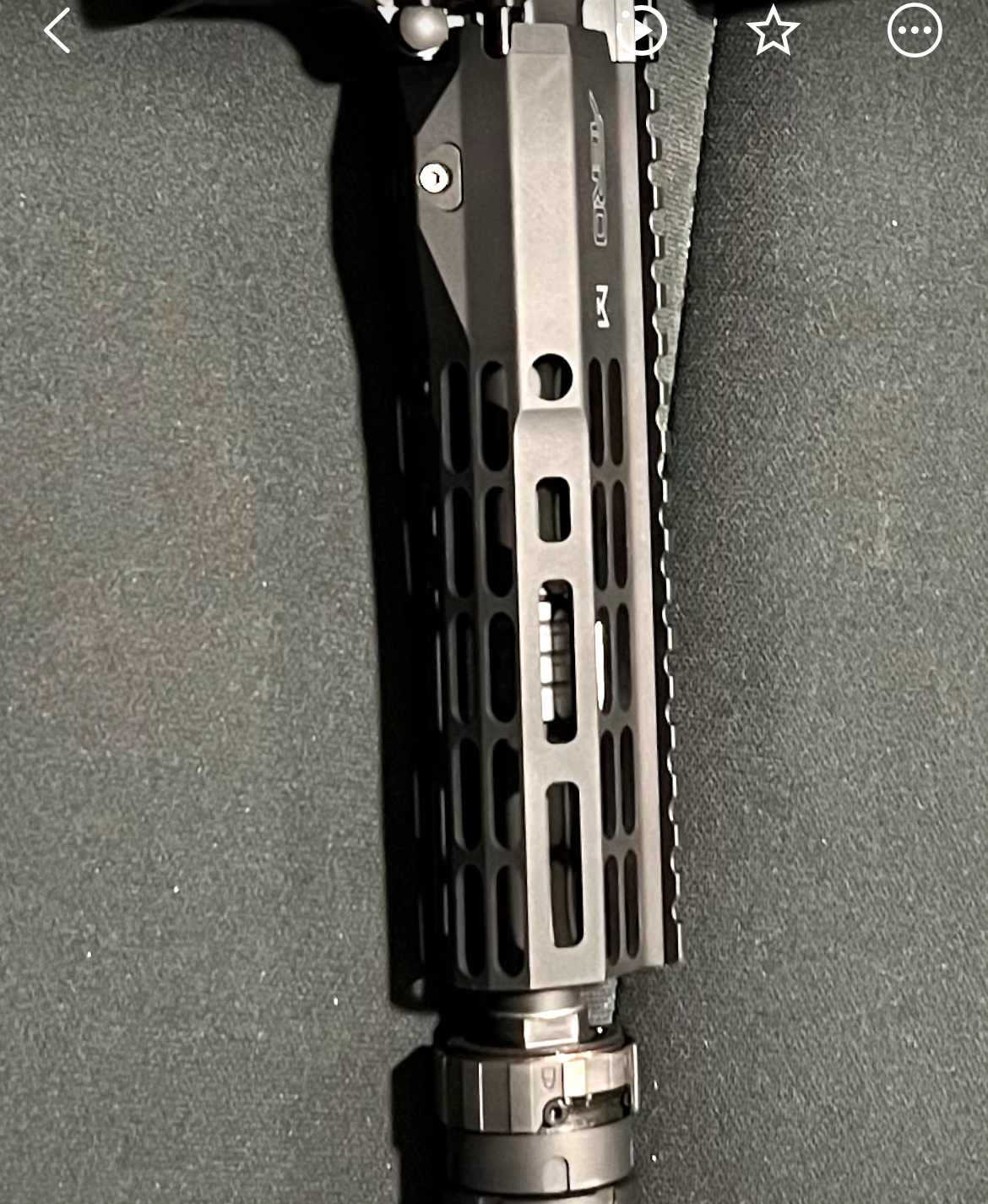

I bought a Atlas S-1 handguard. Go to install it and it does not fit over my superlative gas block (gas block groove too narrow on the atlas). Well during the install it got scratched due to it not fitting so I can not return it to the retailer. The superlative is a low profile gas block. Nowhere on the Aero Precision webpage does it say it won't fit. So I called them up and the guy tells me it will not fit and there is nothing he can do and tells me to sell it on ebay or armslist at a loss.
You would think they would support their product and try to keep a customer happy. I asked if they would take this one back and send me a regular handguard. The atlas costs more so this would be to their advantage as they could sell it as a blem for the same money the enhanced handguard costs.
Buyer Beware the atlas will not fit all gas blocks.
Aero Web Site tells you the ID
  • Front and rear picatinny rail
  • Eliminated center of top rail for weight reduction
  • Indexing grooves in 12:00 position for positive grip control
  • Quick disconnect sling socket at the 3, 6 and 9 o'clock positions
  • Compatible with low profile gas blocks
  • 1.3" Inside diameter
  • 1.5" Outside diameter

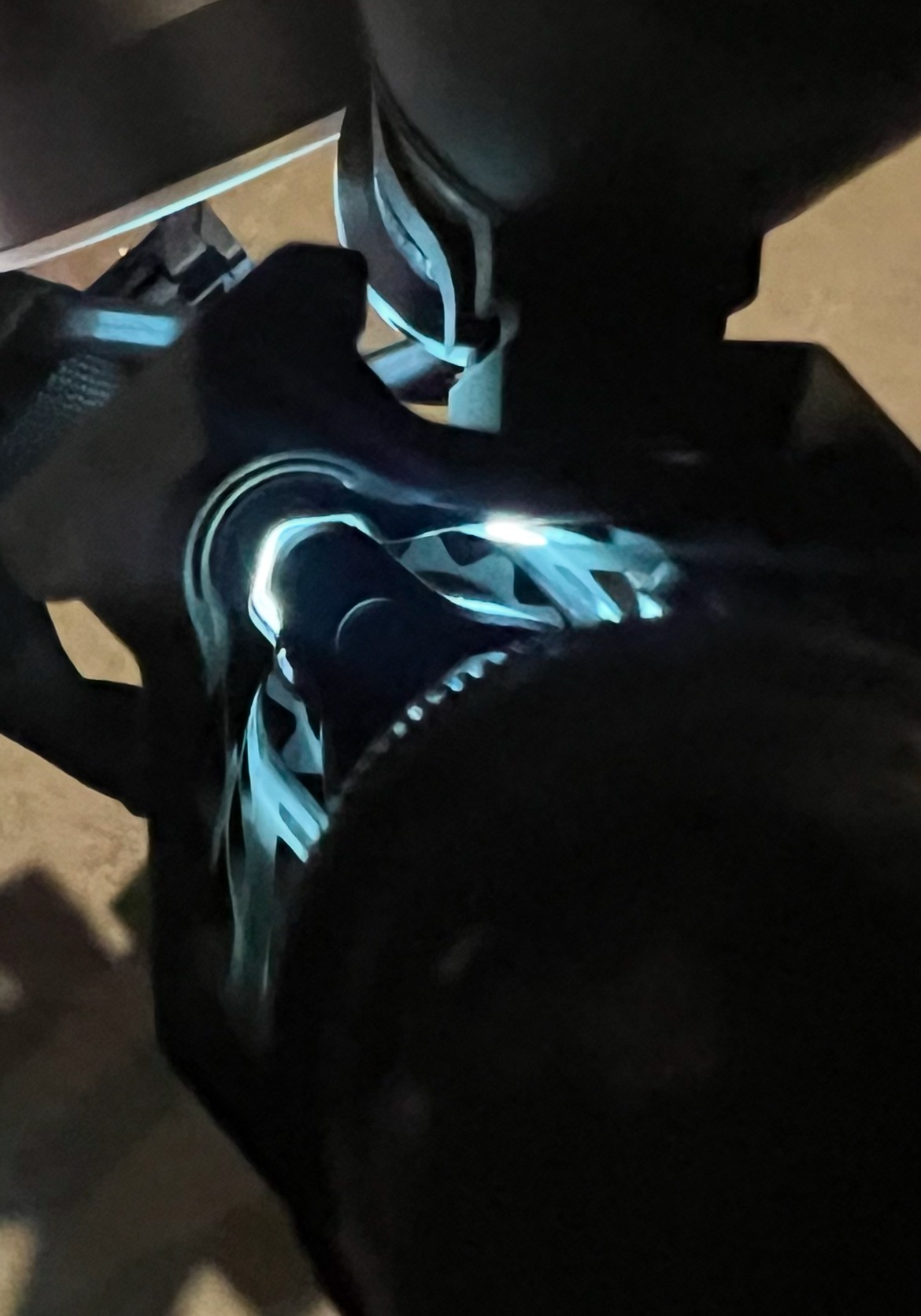

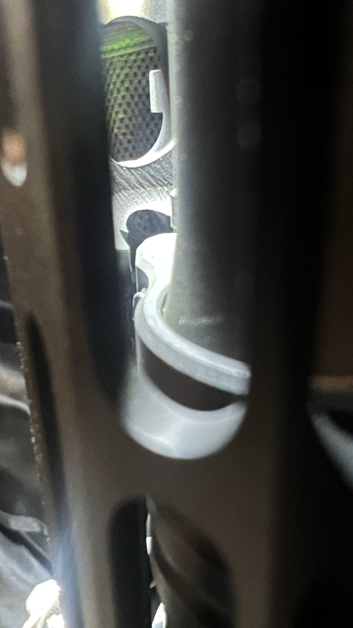

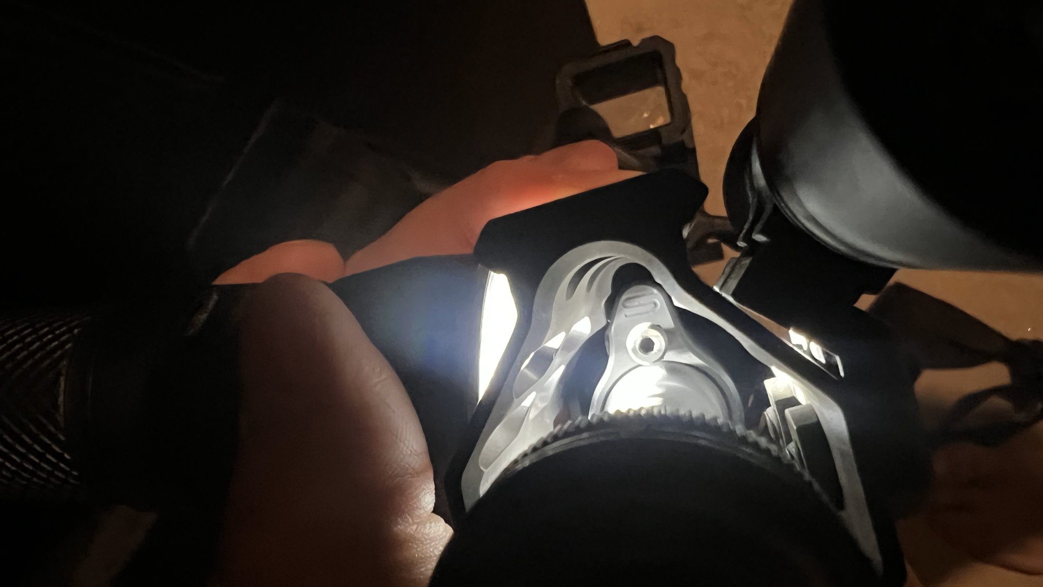

Another thing to be aware of is that not all gas blocks work well with M Lok either, at least not if you want to install things right under the block. With some hand guards when you put an accessory directly under the gas block the screws will protrude enough to make contact with the gas block.
OP, you learned a valuable lesson the hard way unfortunately, but by posting the problem you've helped remind all of us to always confirm things will fit and function properly. Thank you for that.
Reactions: jinxx4ever
I waited 3-4 months for an SA gas block, it doesn’t seem to work any better thana normal one on my 10.5. Talk about disappointment.
I’d like to try their piston system still, because I’m stupid apparently
Reactions: Stoweit
You just need a bigger ball peen hammer.
My first one is beat to shit from letting someone else assemble it because I was lazy. They hit it on the front edge with a hammer. Luckily I got it half price or I’d been pissed. Just makes you less worried about dinging it shooting.
You just trim the screw.
SLR gas blocks are low profile, but only with respect to gas blocks intentionally designed not to fit under hand guards. They are huge by comparison to an actual low-pro gas block.

I do realize you can't base it off the 1.3" - its all about channel at the top. What i wanted to communicate is that i believe the internal diam or profile is the same between the two models.
I don't mean to argue it - I'm just trying to be helpful for the OP to understand his options... but my gas block is not in front in the clearance pocket where you're describing it. I took a few photos, and tried backlighting it to illustrate. Again this is an SLR gas block, not an SA.
I'm glad you commented, because looking at it tonight again....it fits alot closer than I would like. I was definitely wrong thinking "decent room to spare". I'll likely try to clearance it a little. In hindsight, i would have chosen a different rail. Cheers.
I'm not trying to argue either. The SA AGB is about the same profile as your generic low-profile set-screw gas block, it is quite svelte with only a few mm extra meat on one corner of the gas tube area and less mm in the other side. Hard to explain in words, however that few mm makes a big difference inside a tight rail channel.
In your photo, that gas block has insufficient clearance for proper free-floating. I had the same issue running the carbine-length SA AGB under the 12.7" Atlas (R/S-One) since it did not fit into that pocket I described earlier. McMillan stocks has said you need 0.050" of clearance around the barrel to prevent interference during barrel whip/harmonics. The thickness of a medium zip-tie is about 0.048"-0.050" so I just run the zip tie and prod it around the tight spots to ensure everything clears. I bet if you gently bent your barrel against the rail you might get contact, but then again you have a very short 300BLK setup so it may not be as prevalent. But from your photos it looks to be too tight, same issue I had with the 12.7" Atlas. On my 16" Criterion w/ SA AGB or Aero low-pro Non-Adj carbine-length gas blocks and the 12.7" Atlas, I didn't have to bend the barrel much at all and I could hear the click of the gas block against the HG.
My carbine-length SA AGB fits perfectly with the 9" Atlas R-One because that rail has a bigger pocket to clear the gas block and it is about 2 M-LOK width from the front of the rail. I observed the same "pocket" on my 12.7" Atlas. I suspect this was by design for whatever benchmark they were trying to meet.
I suspect the aluminum barrel nut and/or the Atlas HG itself is very flexy. My Midwest Industries Combat Rail is much stiffer. I can barely see any barrel movement with the 13.375" Combat Rail and the same Criterion 16" barrel , but the Combat Rail has more than enough clearance throughout the entire handguard length (it's the same throughout). They make a whole bunch of different length Combat Rails and they use a steel barrel nut. I am not shilling for Midwest Industries, but I've used them since Gen 2 and its been decent. I am sure there are better HG options out there but I've always been concerned about the gas block clearance.
