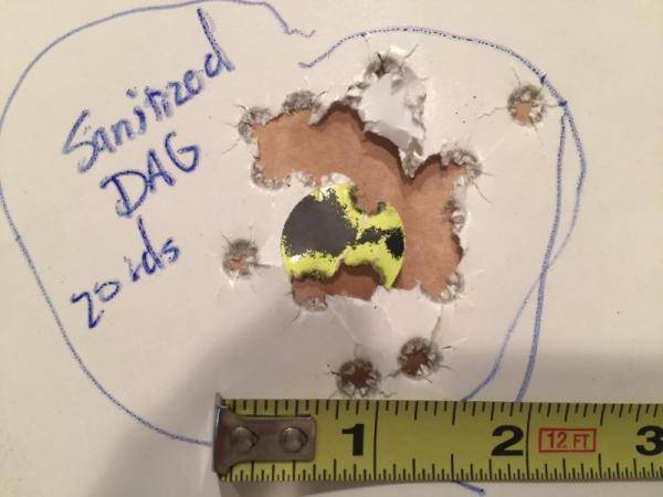

And just to show how much finding a ammo a barrel likes matters...
PSA SS 18" factory barrel...
20rds DAG surplus... ( did great )
!!!!!!!!!!!!!!!!!!!!!!!!!!!!!!!!!!!!!!!!!!!!!!!!!!!!!!!!!!!!!!!!!!!!!!!!!!!!!!!!!!!!!!!!!!!!!!...jpg
But, the same PSA 18" SS barrel would shoot ZQI, like poop.
