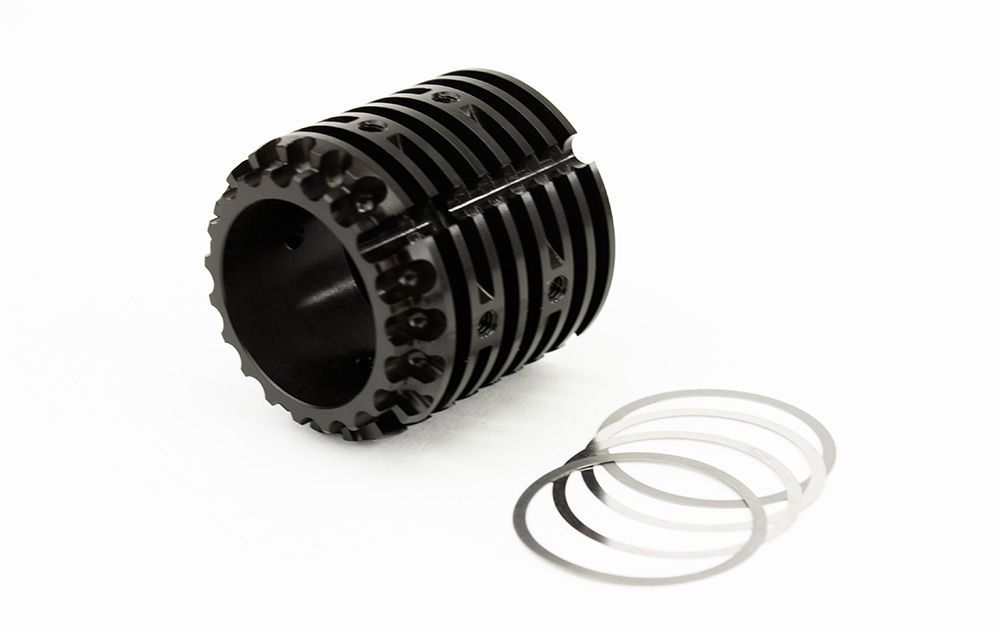

    Shouldn't be an issue.... however, you still need to time the barrel nut for the gas tube.
    Quote...
    "The M5E1 Handguard Barrel Nut is used to connect Aero Precision M5 Enhanced Handgaurds to DMPS pattern threaded upper receivers. This product comes with 5 shims to properly time the gas tube with the upper receiver."
    As for the barrel change, just make sure to buy a DPMS pattern barrel.
    Quote...

    I think thats for putting a M5E1 handguard onto a regular receiver.
    The actual Aero M5E1 receiver has that built into it.
    My thought is since the handguard attaches directly to the receiver, the barrel nut can be torqued more consistently as there is no timing for the handguard
    Its similar to any other barrel change. Yeah there's no timing but theres other handguards that dont require timing either. I think M5E1is supposed to be sort of a semi monolithic free float. I have one, its ok. Dont change barrels often.
