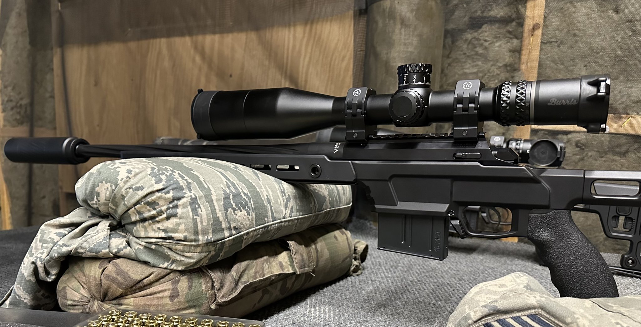

I had a chance to handle one a new shooter student brought to a train up class, and it really wasn’t my cup of tea. For $1300, it’s a good rifle, but it was underweight and balanced far rearward.
Solus barreled action in a Woox chassis. 6 shot group with 6mm Creedmoor hornady match ammo. No complaints.

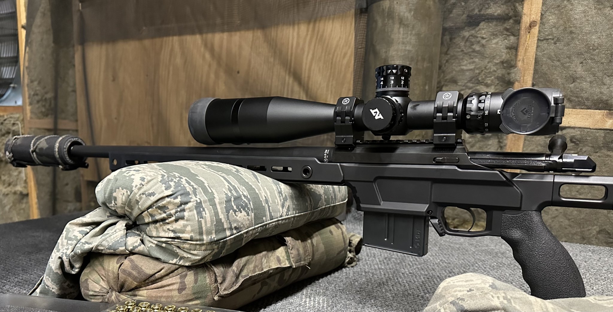

I was originally going to build an ARC Coup de gras. However work is slow money is tight and at 40 y/o I have a new kid. (I’m still learning how it works). So the compromise was a Solus bravo. The purpose was to be a new hunting rifle… holy shit she a heavy bitch. I went with the bravo because of the offered barrel lengths and I lied to myself thinking I was still a tough guy. Aside from the weight I’ve been impressed with the gun especially for what I paid. I agree the balance is slightly rearward but that suits my purpose. Offhand shots with this beast is not ez.
Aero Precision Solus Bravo M24 308 with the 20” barrel.
Is this what would be expected from this rifle?
I recently purchased the Solus Bravo. The only thing I did to the rifle were clean it and mount a Bi-pod and optic. Trying various quality factory ammo there was only one I found so far that shoots okay if 0.91 MOA is okay.

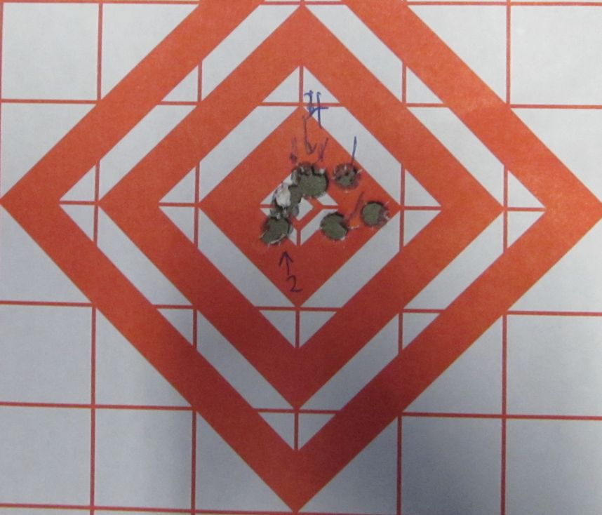

These are all 10 shot slow fire groups from a bench at 100 yards.
0.91 MOA, Federal 175 gr Gold Medal Sierra Matchking (picture attached)
1.23 MOA, Federal 168 gr Gold Medal Center Strike OTM
1.51 MOA, Hornady 168 gr BTHP Match
2.14 MOA, Hornady 168 gr ELD Match
Anyone have suggestions for other quality factory ammo I should try? I shot some other stuff but the above is the only match ammo tried so far. I want to get into reloading but haven’t gone there yet. My goal is to get good enough to compete with others so I can learn from people who know what they are doing.

The .308 Win barrels are known to have issues. Mine did, as well as about 5 other people I personally know. The 6.5CM factory barrels, however, will absolutely hammer…

@FuhQ After reading through the forums I thought there might be a problem with the 308 barrel. Wish I read that before getting the rifle. That barrel is a great suggestion and I do like stainless. Guess I would need a barrel vise and a receiver tool? That is a 'prefit' barrel that just screws in?
Problem is I already have a Tikka 6.5 Creedmoor in stainless that shoots better than the solus. Something about 308 appeals to me so I wanted to work with 308 also.

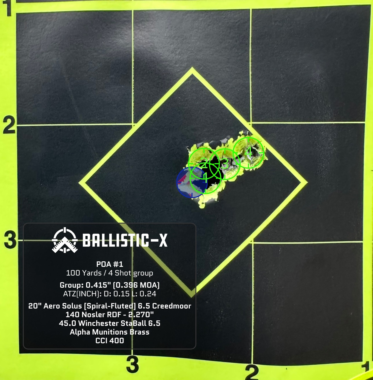

Same here…I bought mine last year, and found it the hard way after about 300 rounds of lead development trying different bullets and powders… It was expensive experiment. 🤦🏼
Yes, that is a shouldered prefit, that screws right in, and torques on @ 75 ft.lbs. You will need a good barrel vise, and one of the Aero Solus action wrenches. I do a lot of swapping things and build my own rifles, so I have an SAC Modular vise. It’s expensive, but worth it, if you plan on doing your own barrel swaps in the future. The action wrench is pretty inexpensive, about $90. You will also need a torque wrench that goes up to 75 ft. Lbs. and you will need a big 24” handle 1/2” breaker bar to pop the old barrels loose. Good thing about tools like this, you can use them forever, and for other things, other than just guns.
I get it, I refused to own a 6.5CM this long, until this deal came about, now I have 2 of them, and I’m quite happy with the results. My take, is 2 sub-1/2 MOA 6.5CM’s sure beats an inaccurate .308 in my book, and I’ve been a lifelong .308 Win fan/shooter. 😂 Still got several, just not a Solus .308 anymore.

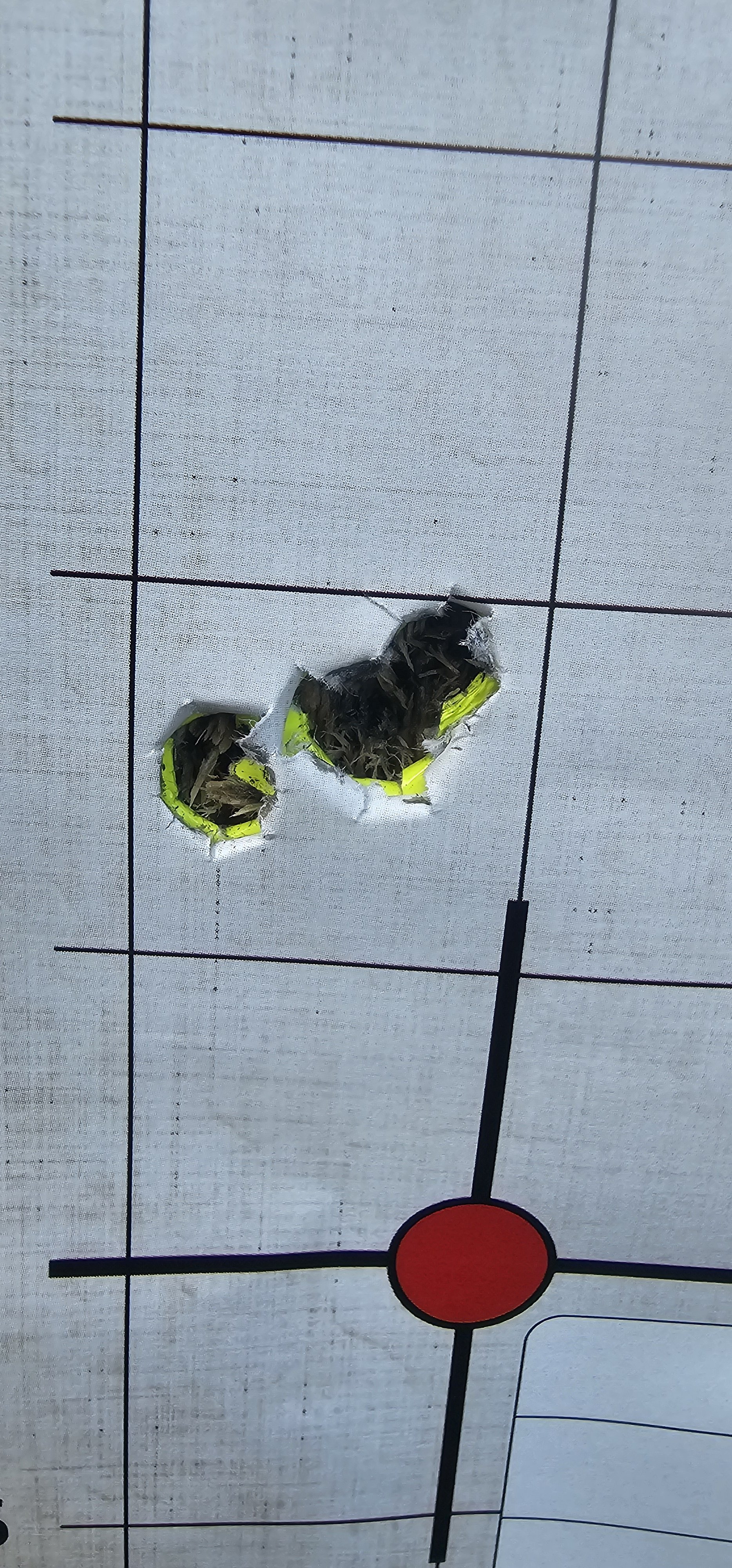

Man, I was a little worried about what to expect with my Solus Bravo M24 .308
But, it actually turned out pretty good.
Ive only got 20 rounds thru her but, after getting on paper from 50 yards I thought I would see how she grouped at 100 yards using FGMM 168gr
If I hadn't messed up that very first shot but, fellas I haven't shot a bolt rifle since before Helene last year and besides that im just a novice to begin with
Had I not threw that very first shot I would've had pretty dang good grouping (well that very last round I threw a little too- i know 3 went thru the same hole basically and lol, i was really hoping to get that last 5th round in there as well but, I got too nervous lol)
This was 5 rounds fgmm 168gr from 100 yards -

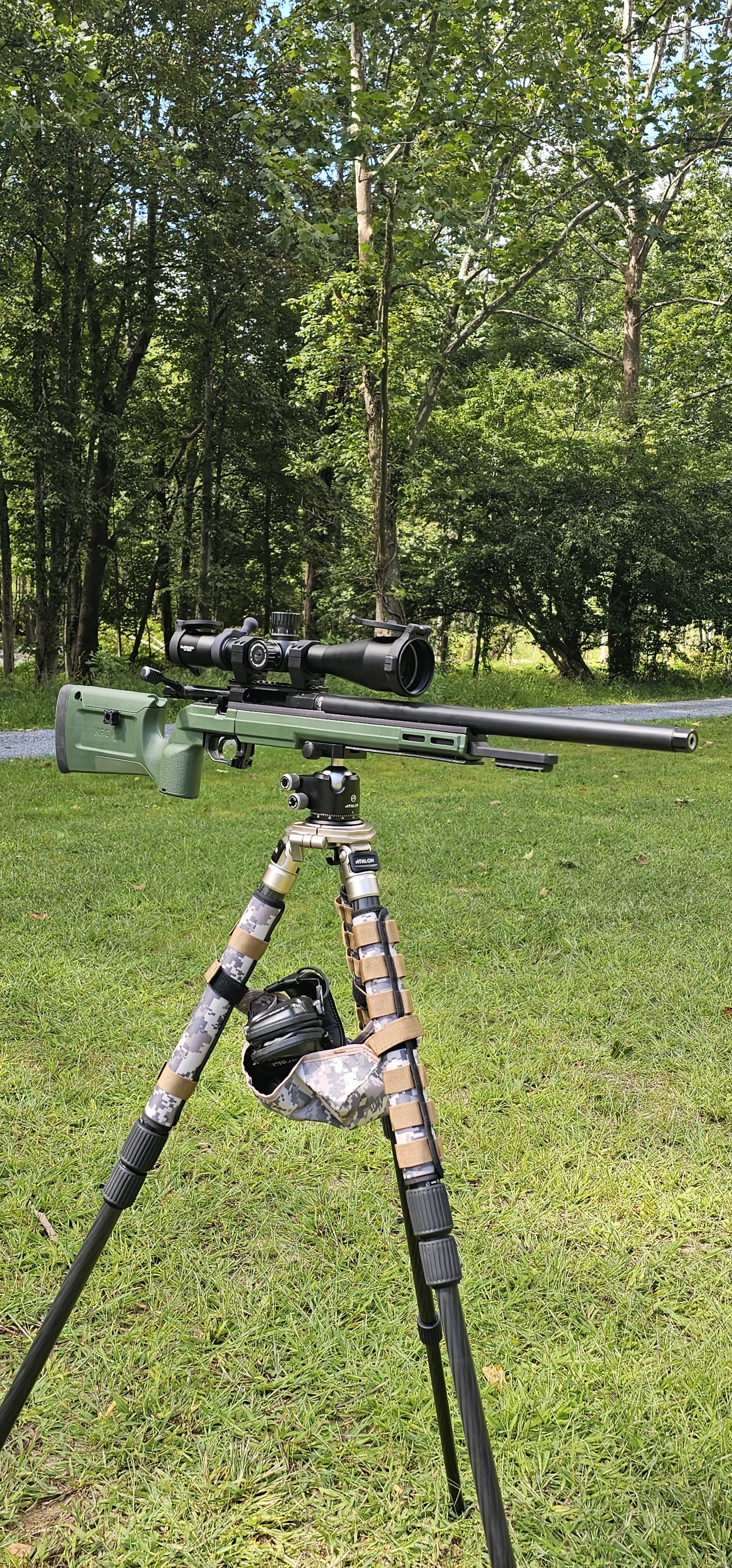

Oh, and here's a pic of it on my new tripod i got- i used it for the 50 yard shots and used mu accu-tac bipod and a bag for the 100 yard shots - i LOVE that ACCU-TAC!)
