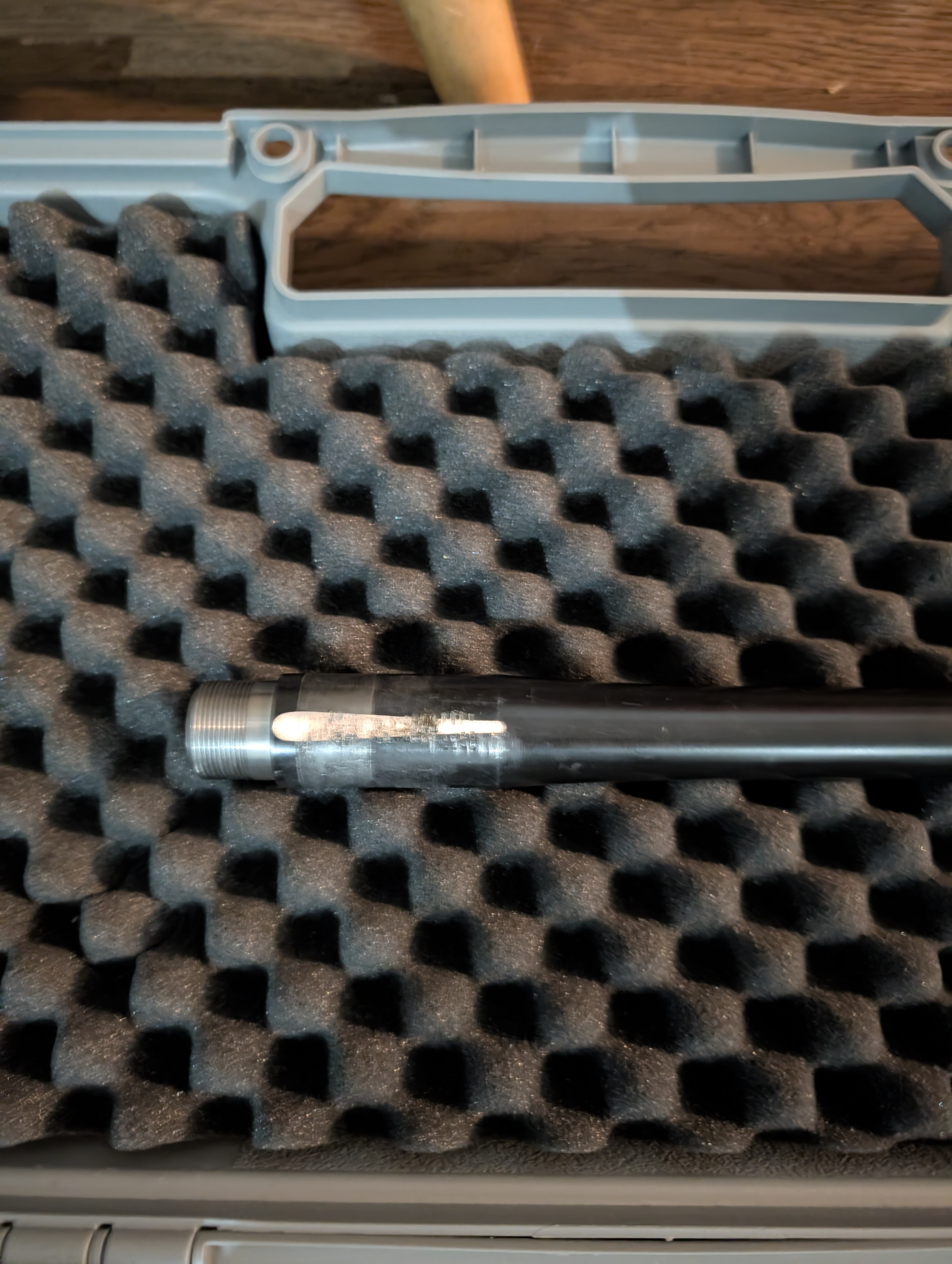

Question: How much do you care about the stock barrel? Answer: I'd like it to shoot, but it already looks like hell I can't sell it.
- She takes it over to a belt sander, and I shit you not, sands two flat spots in the barrel.
- The barrel goes back in the giant vise block, this time raw, at 90 degrees, with the 26'' breaker bar.
IT FINALLY FUCKING GIVES WAY!!!!!

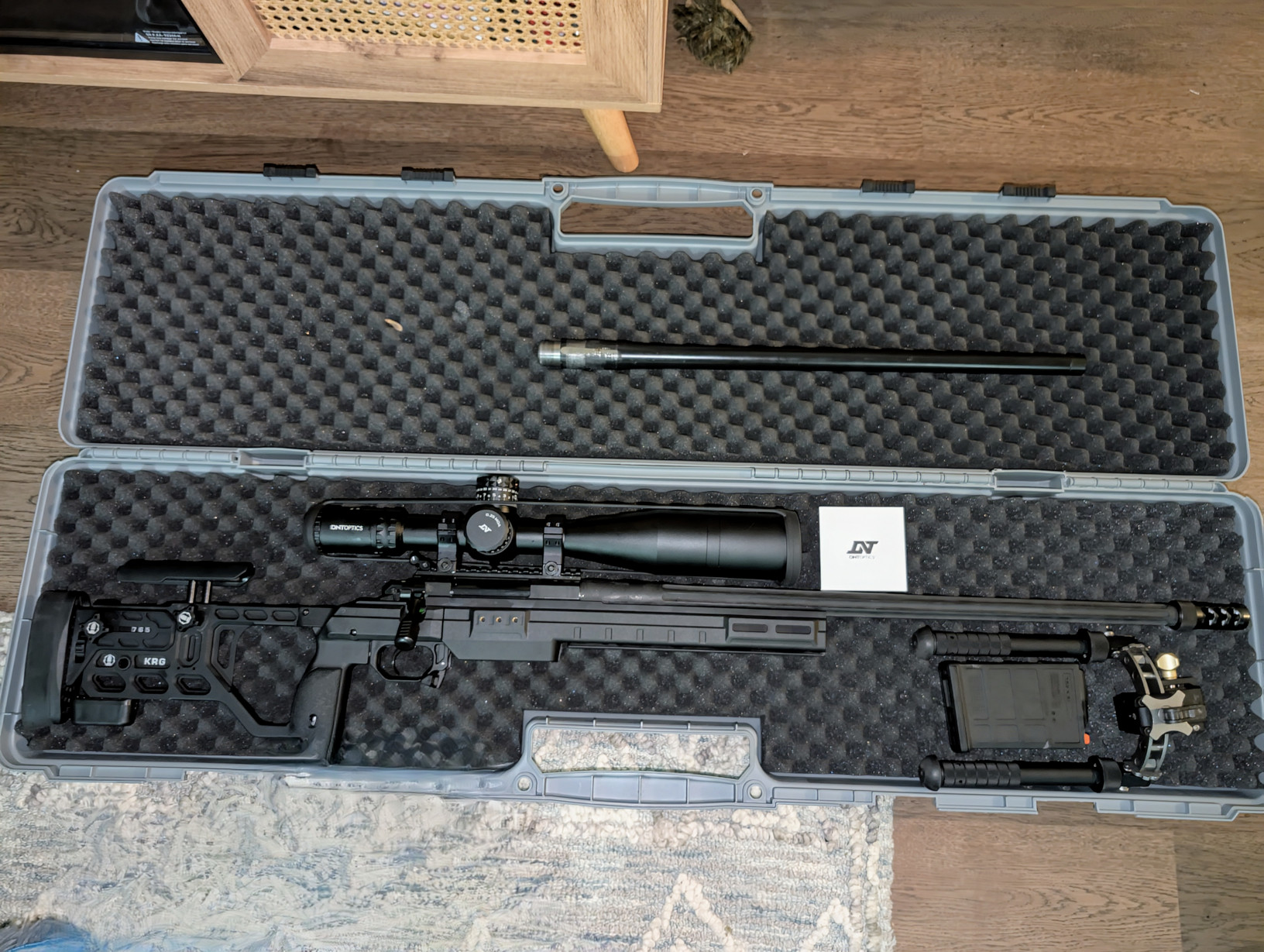

In the end the stock barrel looked like this.

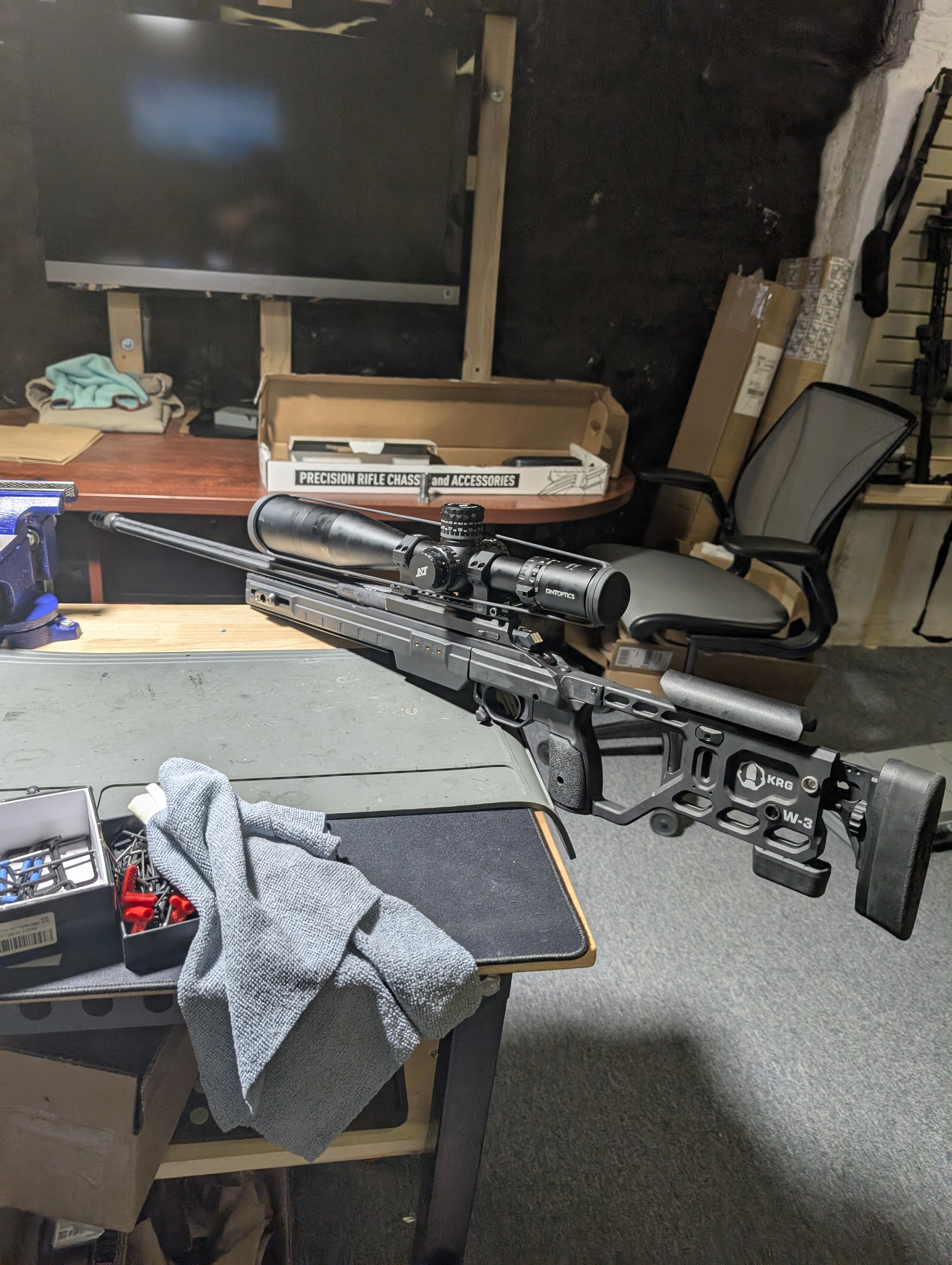

Putting the new barrel in was shockingly easy. Swab some antiseize, put barrel in barrel vise, hand tighten action, use action wrench + torque wrench set at 75 ft/lbs, add chassis and optic and poof!
But my dark lady looked ready for the range tomorrow.
24'' Bartlien barrel + muzzle break.
If anyone asks you to help them change your aero solus barrel, and it came from the factory as a barreled action? Laugh at them.

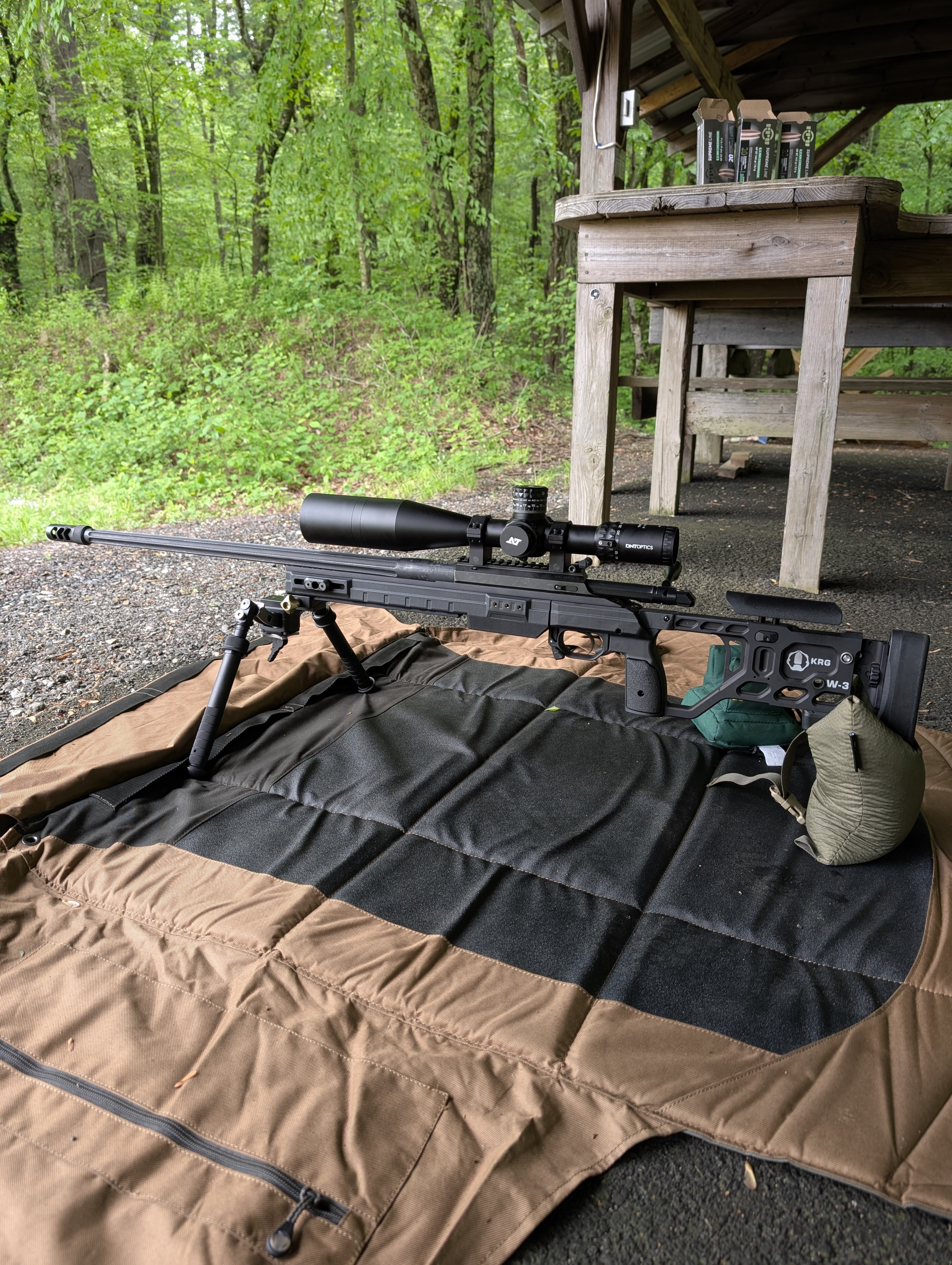

It was lightly raining today but I loaded up and hit the local range to sight her back in. I admit I was a little lazy with it because I have a Element Theos 6-36 coming in later today that I'm super looking forward to. No shade to the DNT - this thing has been a tank and is def amazing. I'll probably move it to my Mars-h and sell the viper that's on that.
I got all setup in my normal position

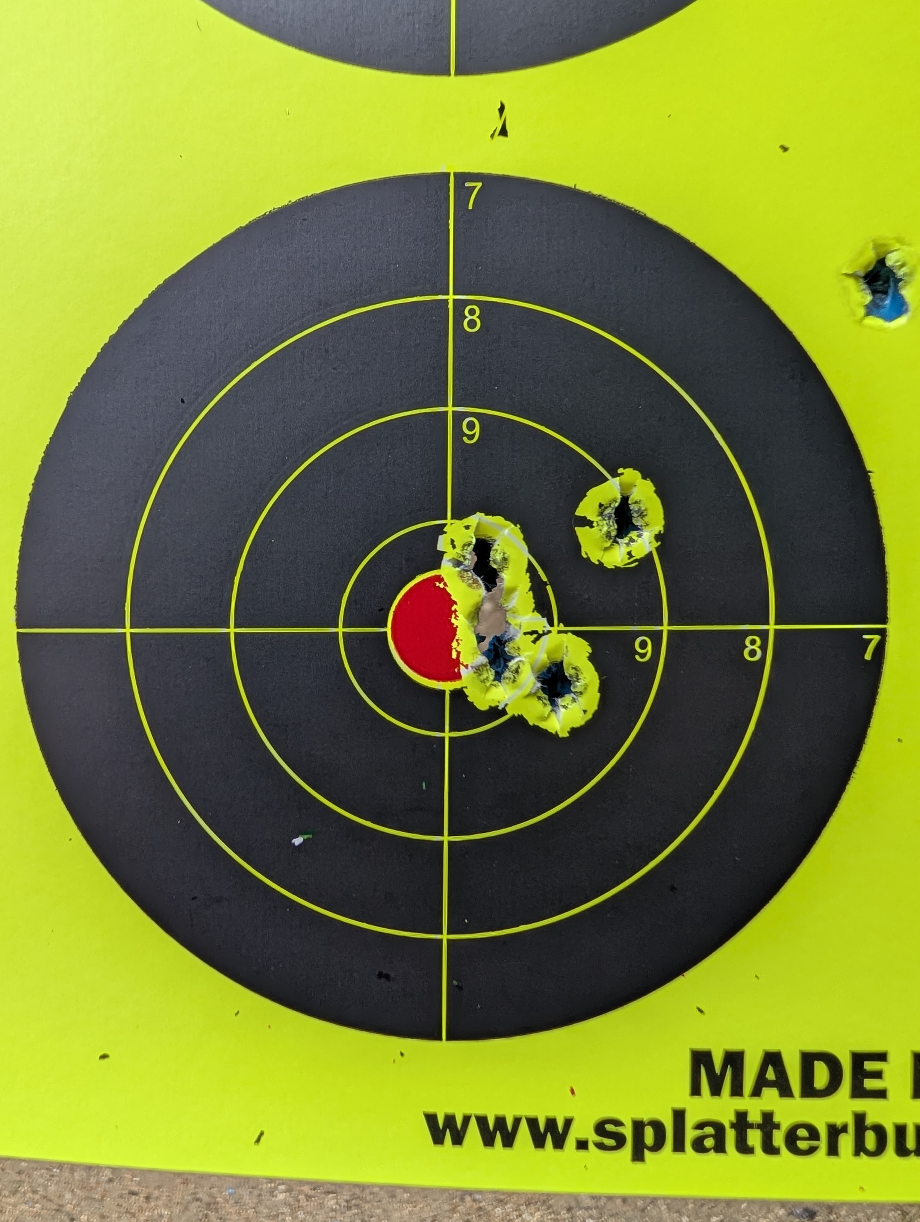

I wasn't shooting my best but she had some flashes of brilliance.
4 inch target 1/8th inch bull, 4 rounds to zero and then she started stacking up.
I put ~80 rounds of 140 gr smk through her then brought her home and cleaned her out (bristle, clp patches, dry patches till clean, then 2 oil patches)

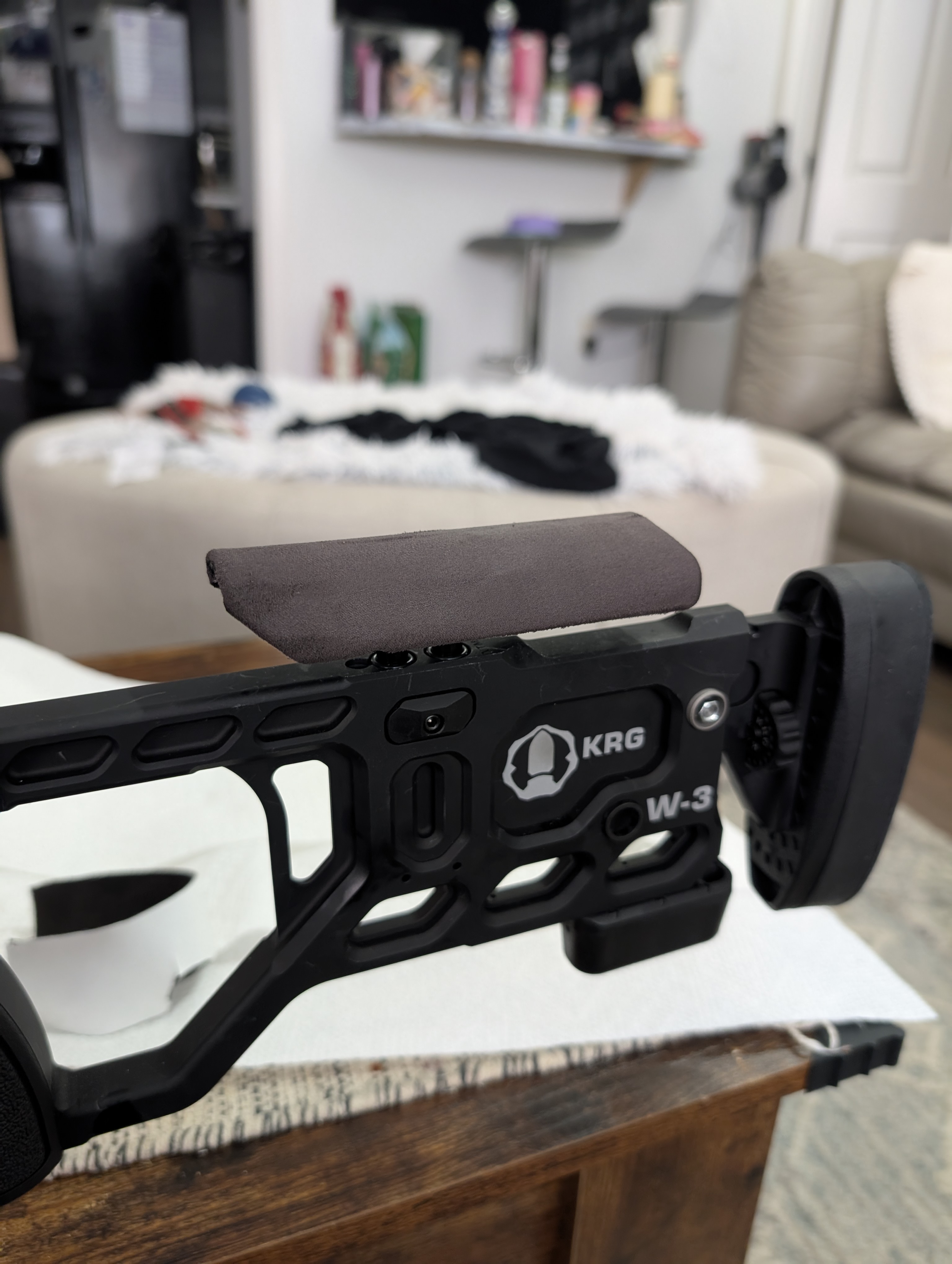

I thought she still needed something, so I grabbed a section of automotive suede (alcantara?) and applied it to the cheek rest.
