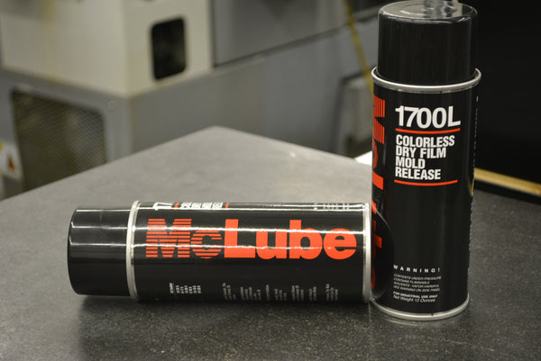

I have been doing some rifle bedding. I saw this old thread and wanted to post a correction. This is directly from McLube. Sailkote is not the same as McLube 1700L. I saw an old thread and used Sailkote. I had very bad results.
I contacted McLube to ask is Sailkote the same as 1700L. Here is what they said.
I have been told Sailkote is the exact same product. Is that correct?
No. McLube 1700L is silicone-free. McLube Sailkote and McLube 1700L are similar in that they both form a dry-film coating. Other than that, the active ingredients are not the same. Sailkote may be suitable for some basic molding operations. We cannot say for sure if you will have success switching from McLube 1700L to Sailkote. This will depend on the molded material and processes involved. Sailkote was not designed to be used as a mold release agent.
Let us know if you have any other questions -
That is straight from McLube. I would repeat,I had a rifle action pretty well bonded in a stock using Sailkote. What a PITA. I WOULD USE paste wax before Sailkote. I just did a stock with 1700L and it worked well. Night and day from the Sailkote near disaster.
I get that now. An old thread on here stated they had spoken with McLube and was told Sailkote is the same as 1700L.
I posted in that old thread and this one that is not what I heard directly from McLube. Sailkote is not 1700L.
