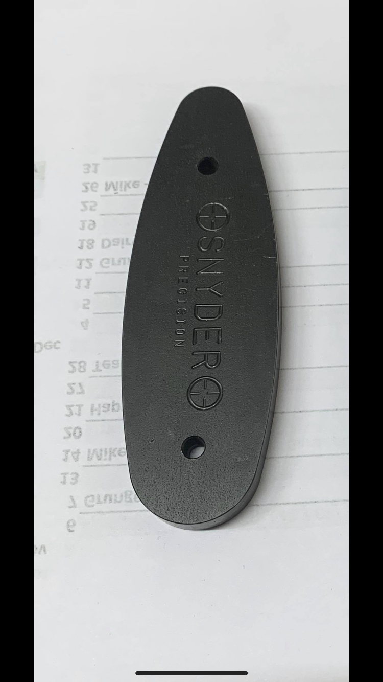

We are now making these KRG butt stock length of pull spacers out of steel. Cheaper than others, but just as good. Let me know if you’re interested! These are 3/8" thick and weigh 0.65 lbs.
On another note, has anyone tried filling in the open space inside the butt stock on the bravo, when you remove the bottom piece? Seems like an ideal way to add weight. Just considering what to put in there, like pack in BBs or something?
@cattleman99 are your spacers the same thickness as the KRG plastic spacers? How are they finished (black oxide, Rust-oleum, cerakote)?
3/8” thick. I’ll have a specific weight this afternoon, but I believe they will be comparable to KRG’s offering.
Black oxide finish. I may be able to arrange cerakote if folks want different colors, but price will go up.
Perfect.

Perfect.
Nitriding them (what KRG does) is stupid overkill that does nothing to improve functionality or durability and just makes them more expensive.
Those were my exact thoughts. The butt stock spacers are a low wear area. Folks want to add weight without spending an arm and a leg, and that's what we have come up with.
