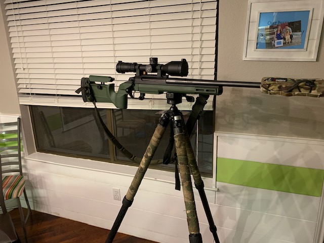

I went with the KRG. I love it. I use the AICS variant. Ordered two MDT steel mags for it. The magpul mags won't fit the Tikka receiver.
I use mine for general shooting fun and hunting.
