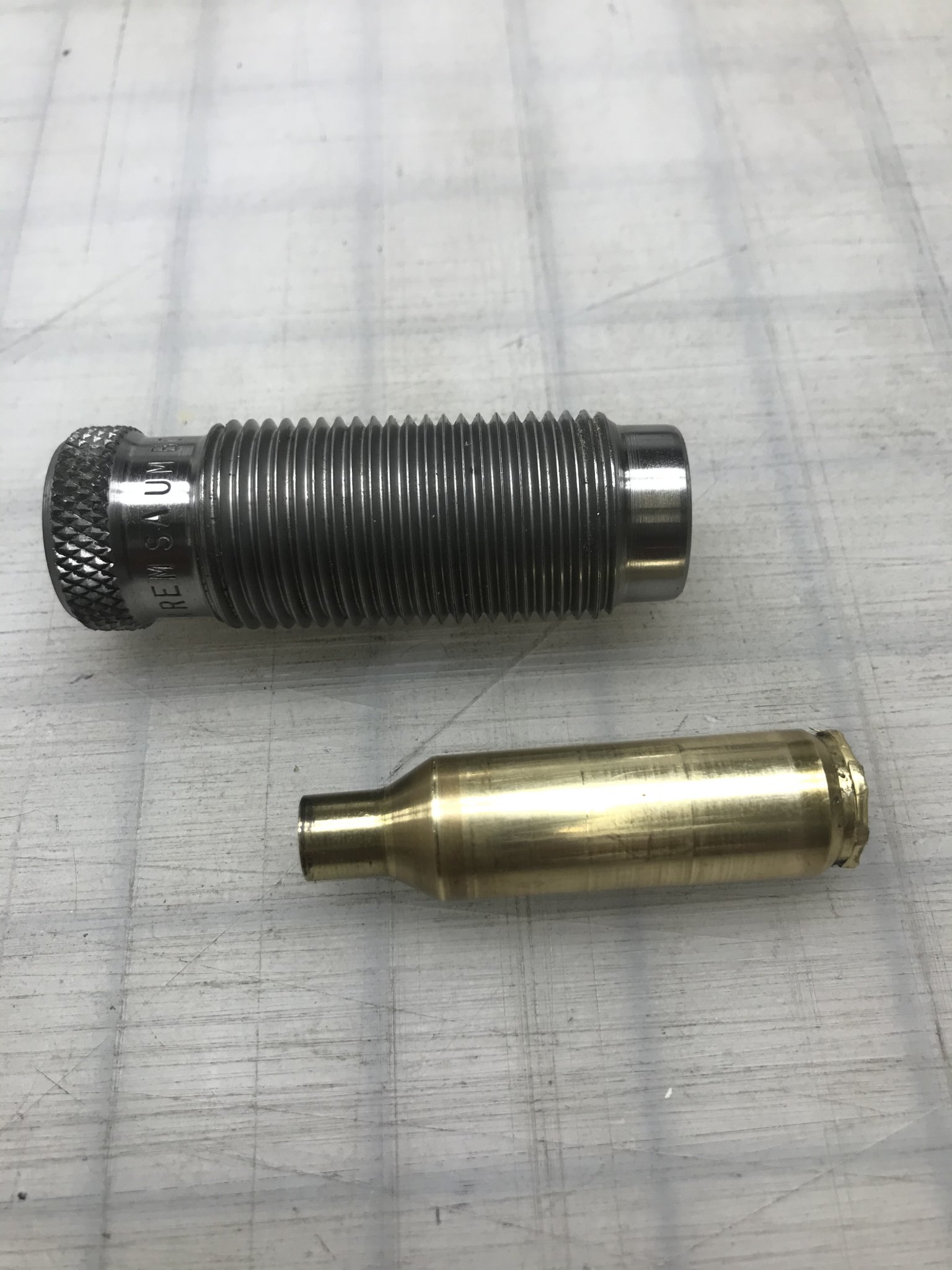

    I stuck a case:(
    unfortunately it was my precious 7 saum brass.
    Guess I’ll make a seating gauge out of it now.

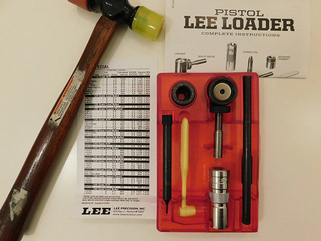

    Dad used a lee loader and so I used a lee loader for the first decade of my loading and shooting, no lube, no press, just a hard rubber mallet and a block of wood so you didnt ding the counter was all that you needed to make fired brass shootable again.

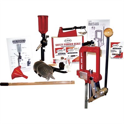

    But as I started to shoot more and got into trying to maximize accuracy with my loads I figured that everyone was using a press so I should too. So I made a trip to cabelas and grabbed myself a lee anniversary breech lock challenger kit.
    Mounted it to a board I clamped on the counter top and got to work. I figured that I didnt need any stinking calipers, I dont care to get that scientific and I sure as hell didnt need to bother lubing the brass as it would just make a mess to clean up and I never had to do it with the hand kit.

    After I pulled the case I gave the die a thorough cleaning.
    just now sized the rest of the cases and press effort was a bit lower so die was probably pretty cruddy possibly exacerbating the situation.

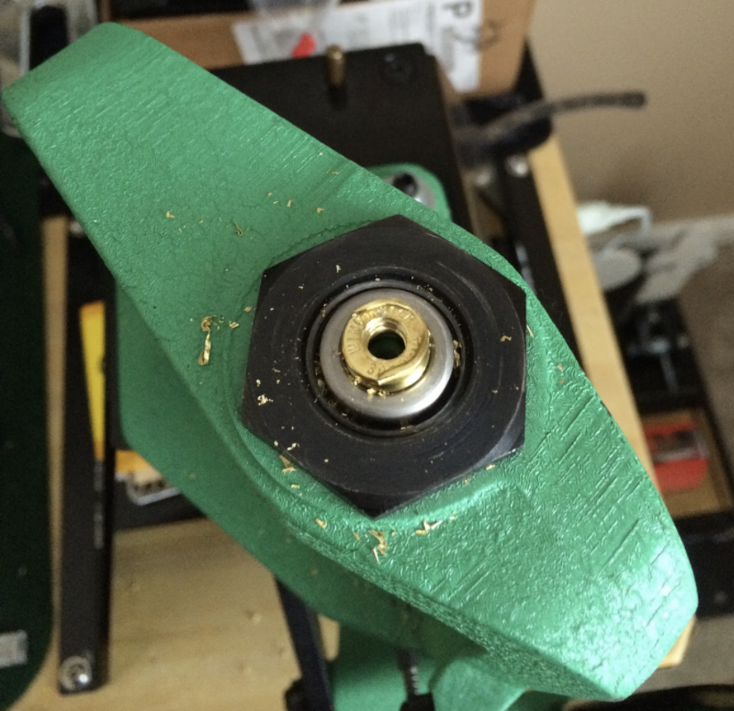

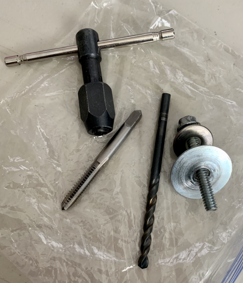

    Apparently, my stuck case was due to the mouth of the case wrapping itself around the collet that holds the decapping pin in my Redding die. It was so jammed that I had to unscrew the collet while it was jammed in the brass, even though the brass was out of the die. I don't know how that brass got a neck so narrow. Anyone else experience this?
