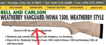

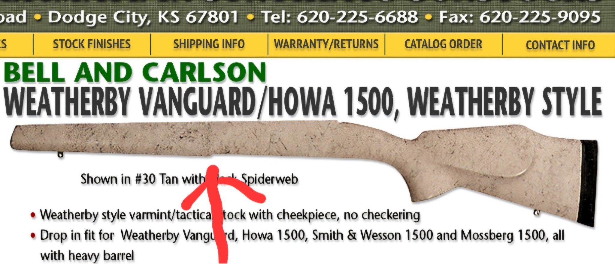

I ordered the barreled action that I posted a few posts up. I want the style stock of the model #6644 but that is a long action. Model #6550 is listed as short action, but the forend seems to be slightly different. Almost seems like it bumps out a bit half way down. Does anyone know if that is actually the case or if it just appears that way due to the design in the photo?
Is there any purpose to that bump out other than just different grip feeling? Added stability for heavy barrel, recoil, etc?
My other alternative is to maybe see if anything from McMillan goes on sale for the 4th. This is a budget build, trying to keep the stock under 500.

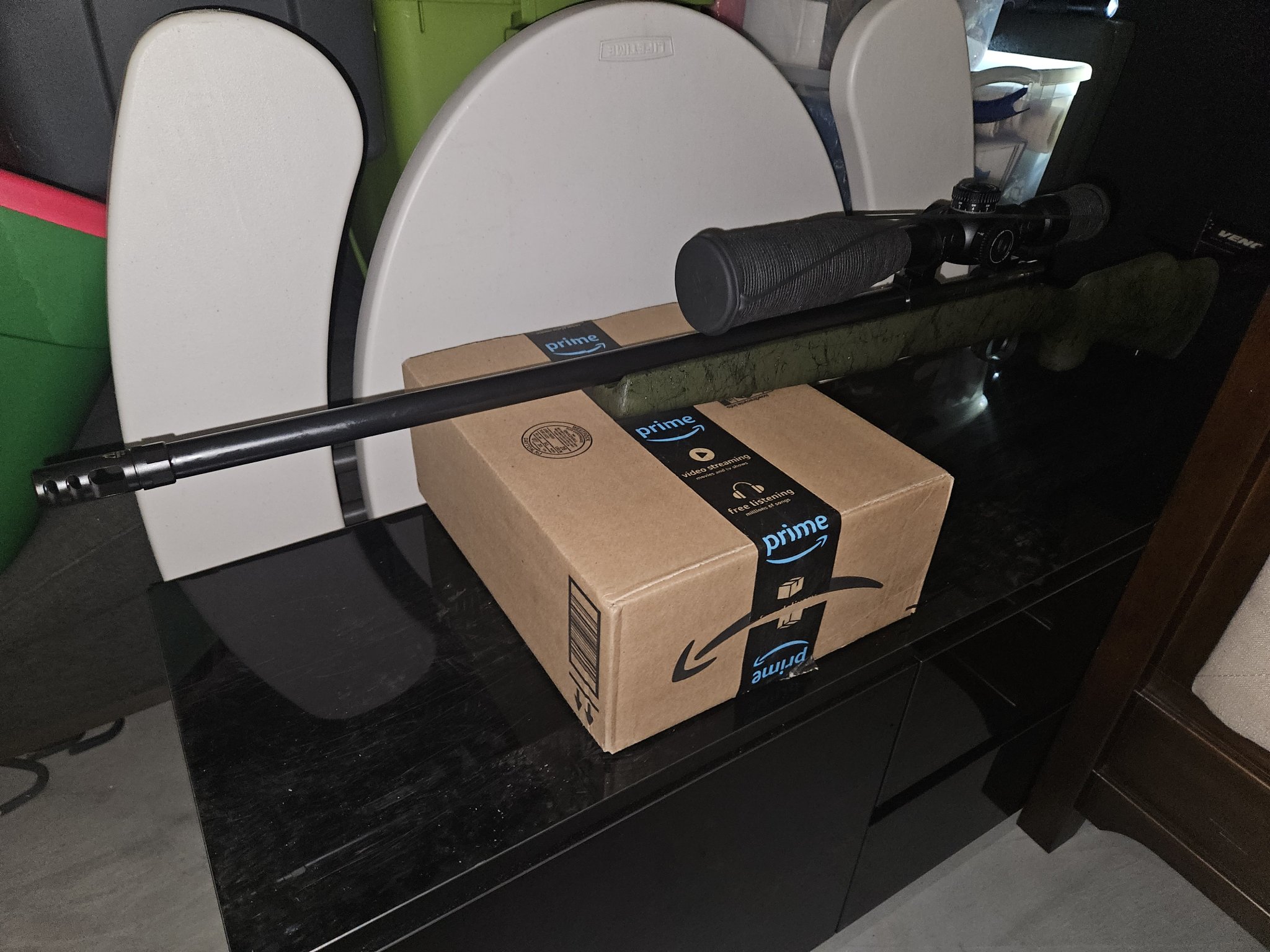

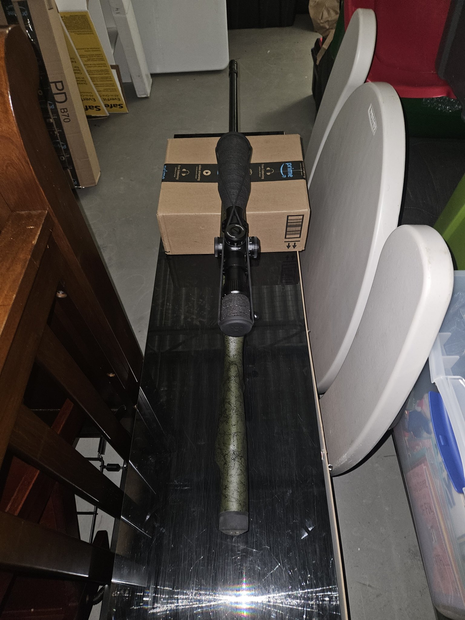

Well, here it is. Went with a B&C Weatherby style stock with a Howa Barreled Action, heavy varmint in 308. Shitty pics but I'll be at range Sunday so will take one of it on the bench outside.
It's exactly what I wanted, a budget build with a classic hunting style stock. Perfect for my 300yd home range. I know it's not as sophisticated or as expensive as most of the taste on this board, but it's fine by me : )

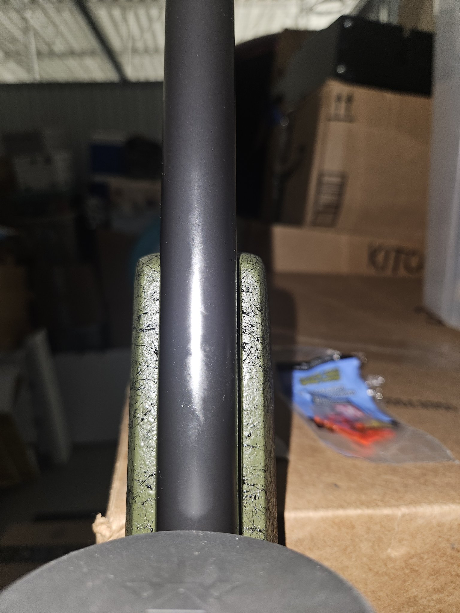

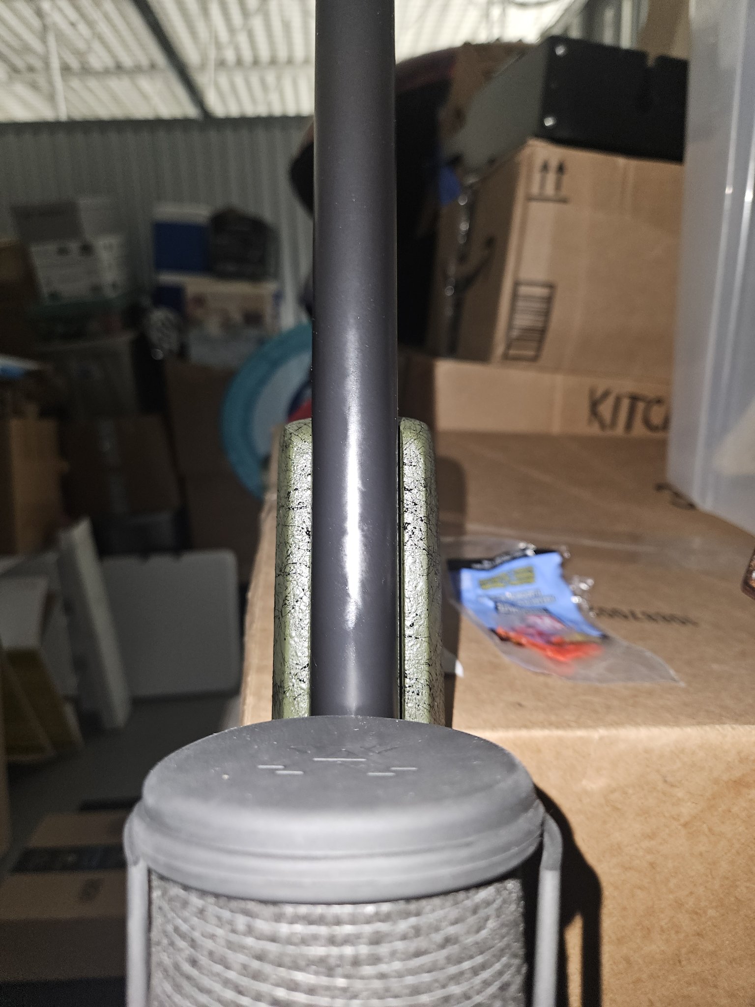

I do have a question though, as this is my first barreled action/stock build.
The barrel seems to sit a bit tighter on the left side, leaving more gap on the right. Is this normal/acceptable or is there an easy fix to it? A little hard to see in the Pic but it is more noticeable in person.
If it is just a bit bigger of a gap but doesn't actually touch, I would just consider that acceptable for a more budget friendly stock. You could loosen the screws and see if it can be centered better before tightening again, but it might just end up in the same spot once tight. If it touches then that's not acceptable.

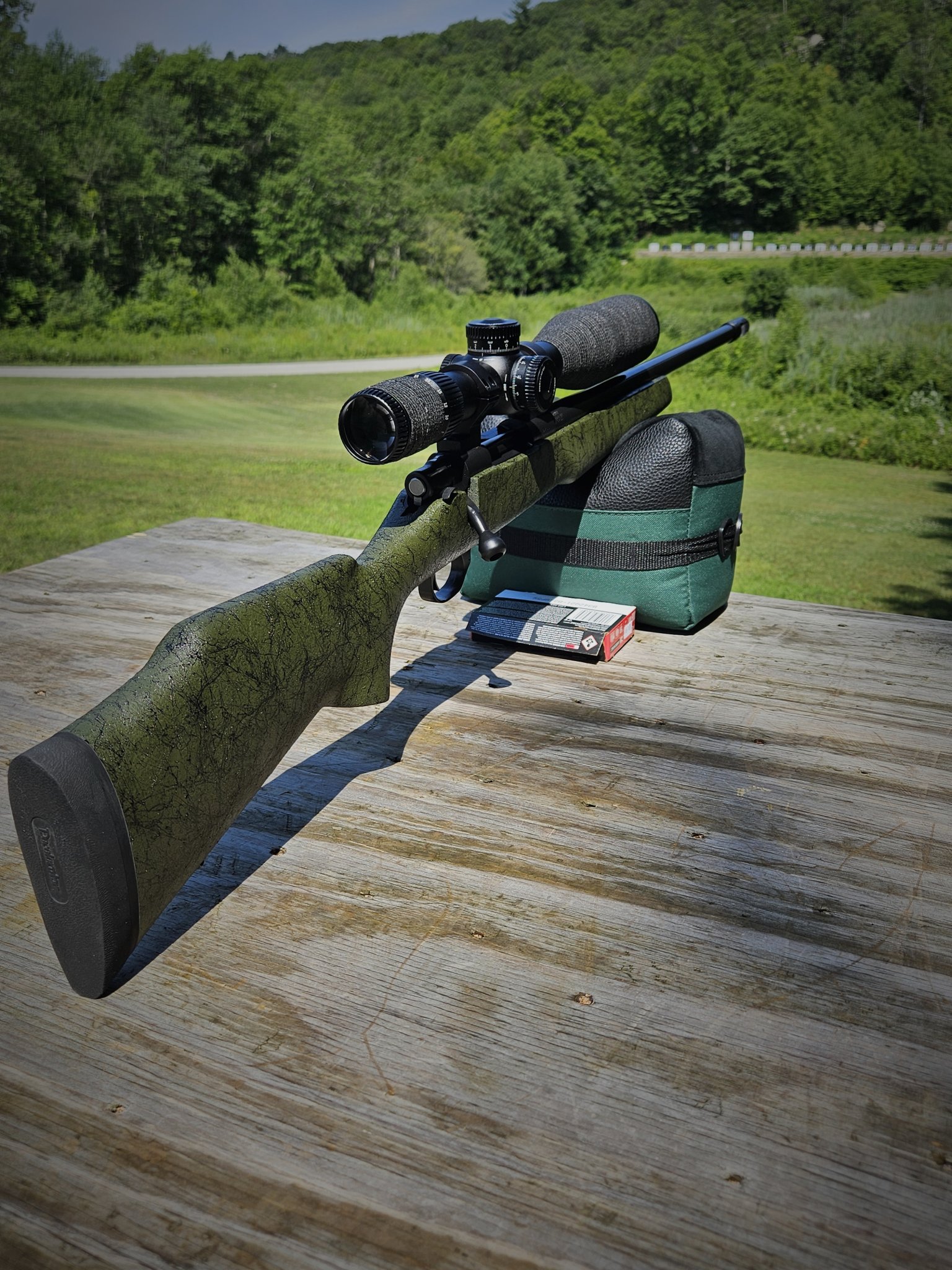

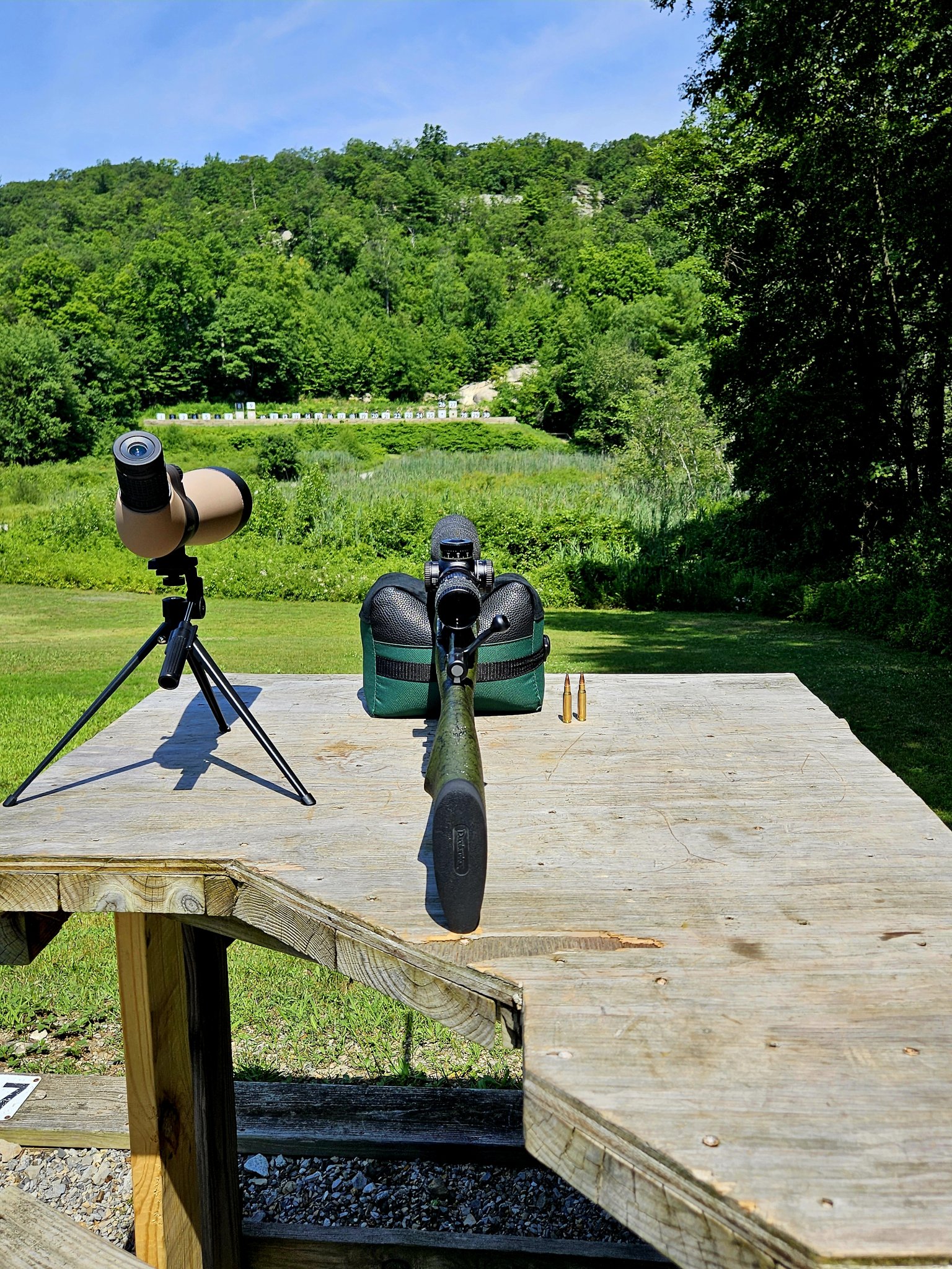

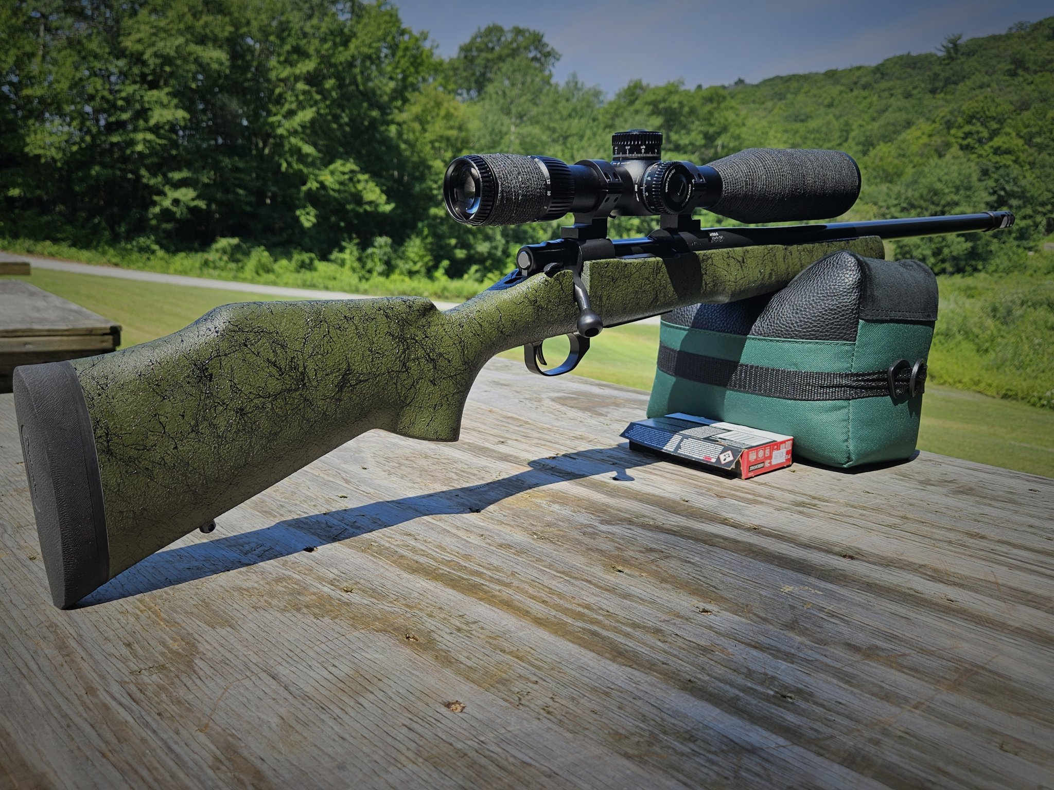

Here are some better pics from the range today. Also, loosened up the action screws and realigned the barrel, tightened it back up, and fits perfectly in between the stock now. Problem solved

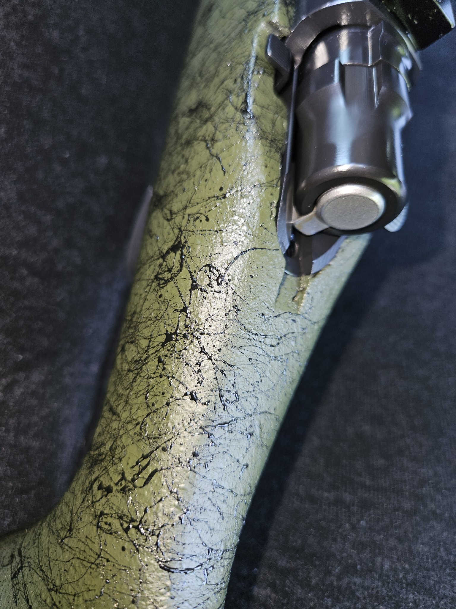

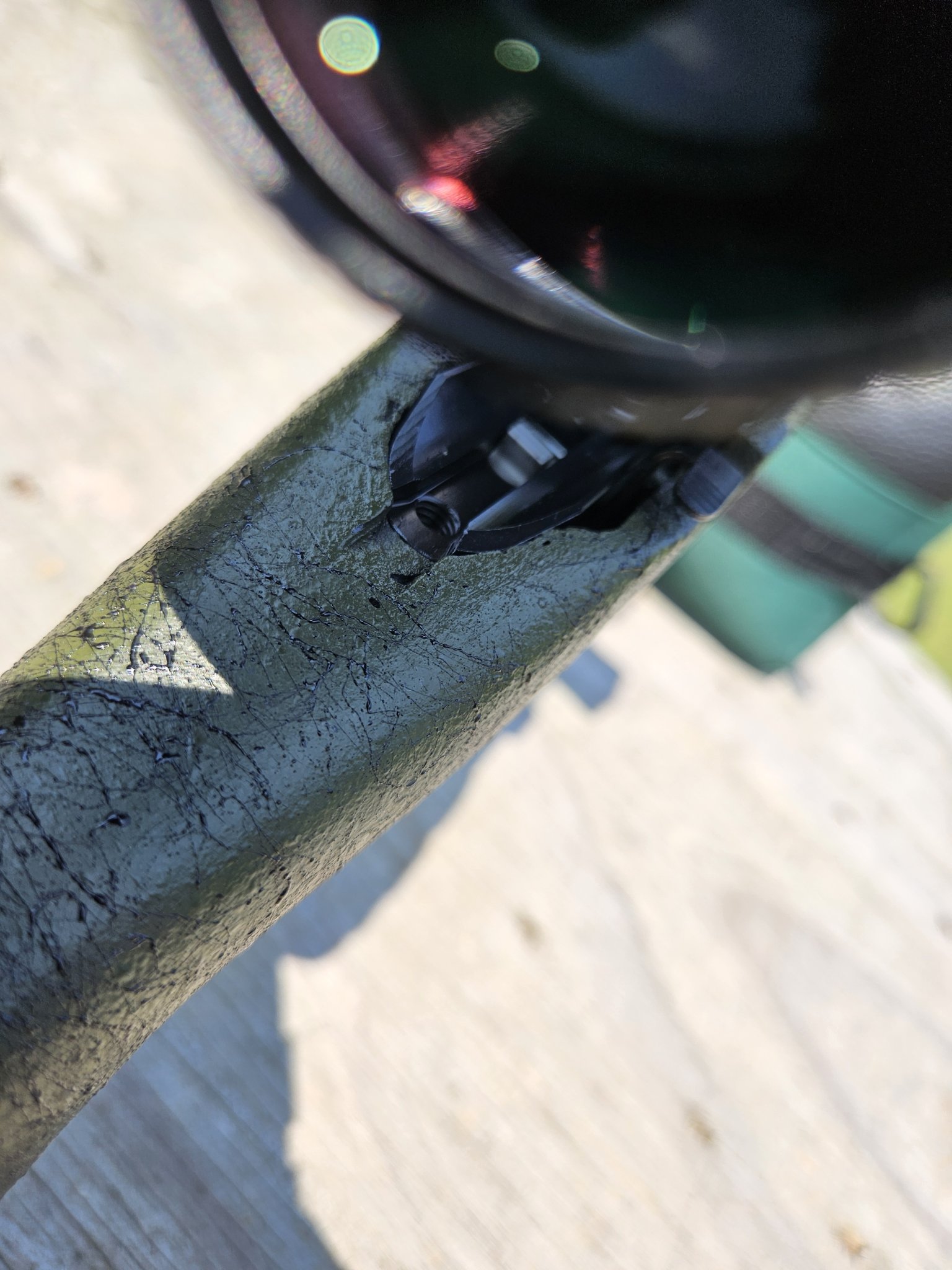

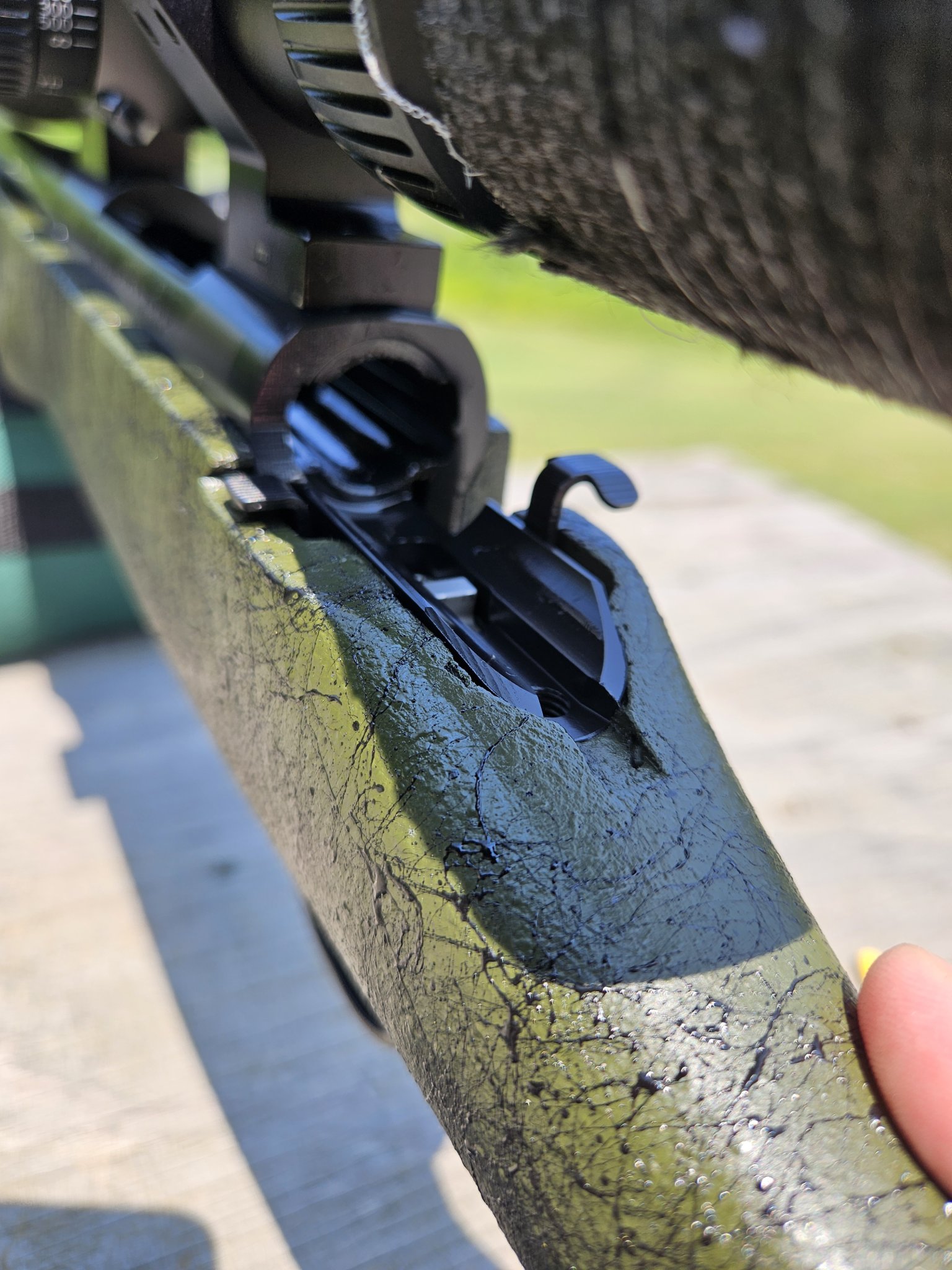

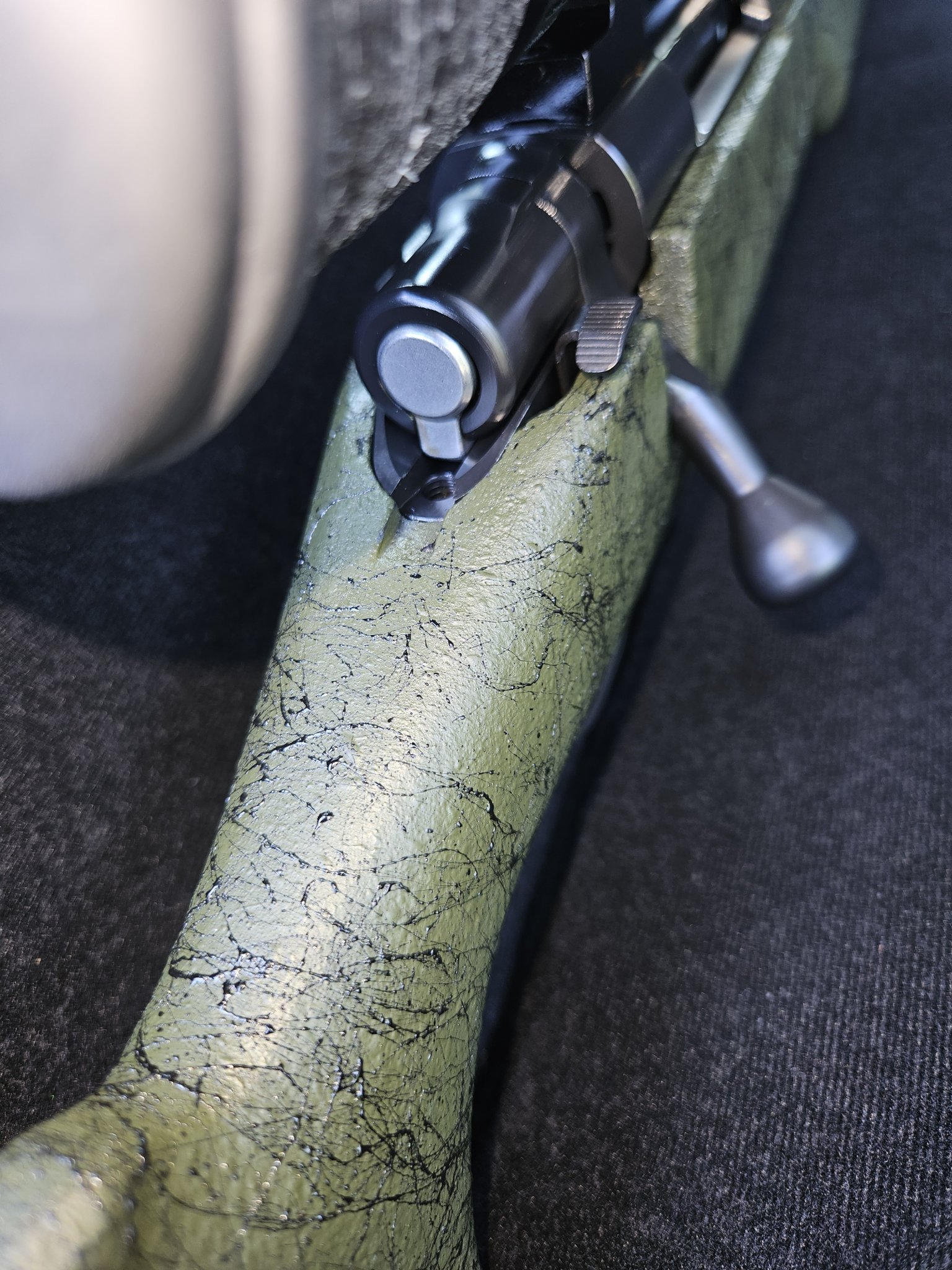

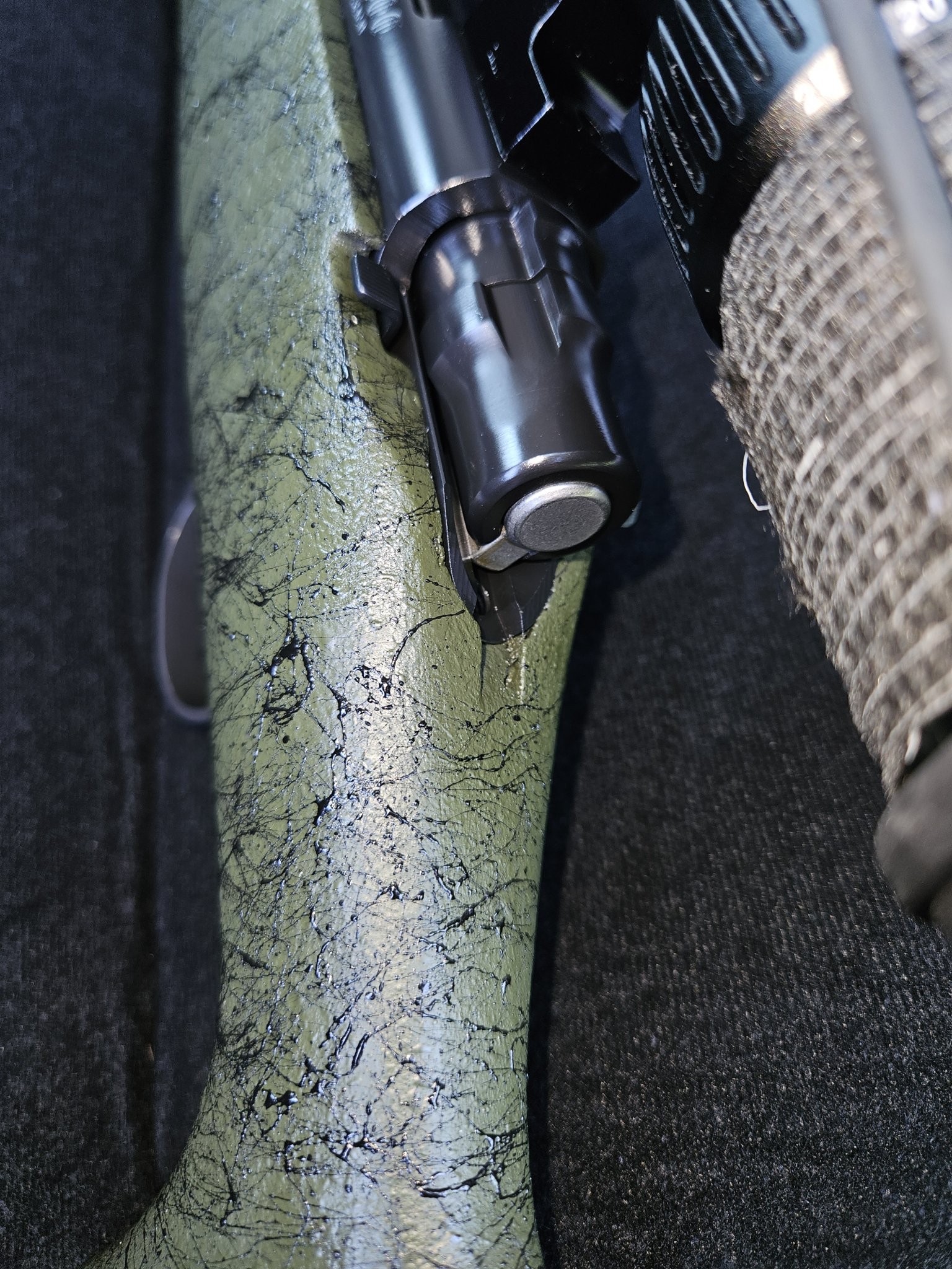

Another question for you all - Does it appear the the end of the action is seated correctly within the stock? Not sure if it's supposed to appear more like it's sitting on top of the edges of the stock or if it looks like it's pulled too deep inside? Sorry if I am not using correct terminology.
I'd shoot it as is but just a few times because I am always impatient to get some powder burned in a new rifle. However, I'd also end up bedding it because my OCD would never allow all those little inconsistent lines where the action meets the stock.
