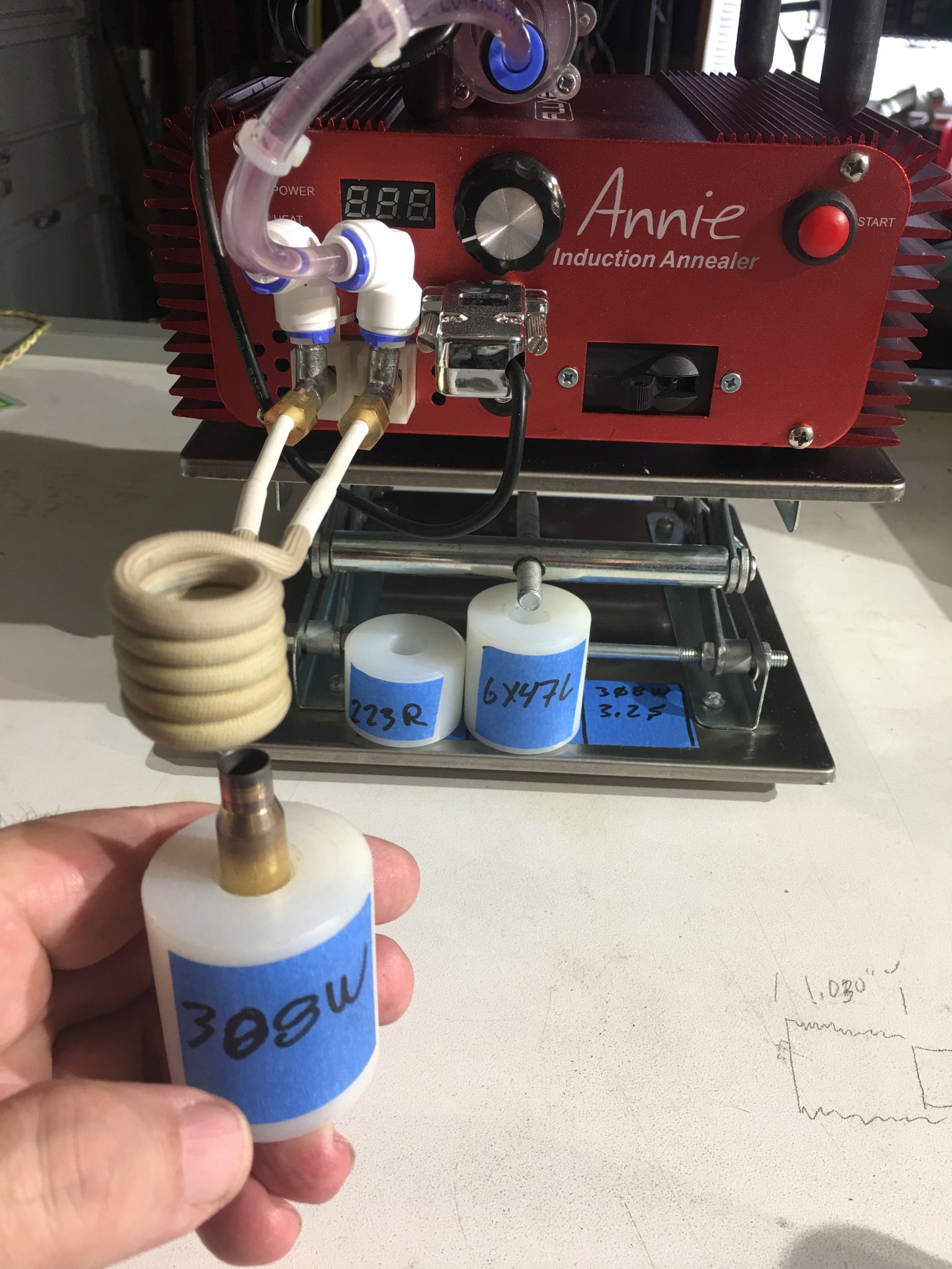

I have an “Annie” Induction Annealer. I tried the flame type and salt bath type, which in my opinion are too inconsistent/temperamental/error prone and in the wrong hands, dangerous (by comparison to the Annie). The Annie is Induction and works like a champ.
That is a nice setup. I just don't have that kind of money to spend on a annealer. But it does look great
Reactions: Threadcutter308
Tell you what.....Save your money, buy an Annie and I will make you the same caseholders and send them to you for free/no charge for any of it. Otherwise, you're going to spend three times what the Annie costs and ultimately arrive there anyway.....
