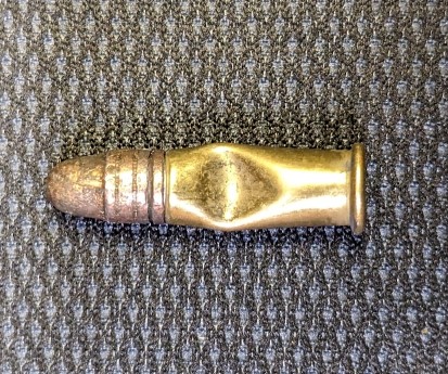

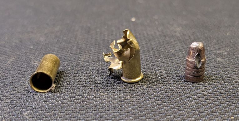

It was more of a loud poof than a kaboom. The rear of the case blew out of the chambered round & the heat ignited the top round in the mag (I think it was heat unless somebody has a better idea). The indent in the mag round looks like it was pressed against the feed ramp of the collar. The bullet in the pic must be from the mag round; I found it on the bench after I pulled the upper off.

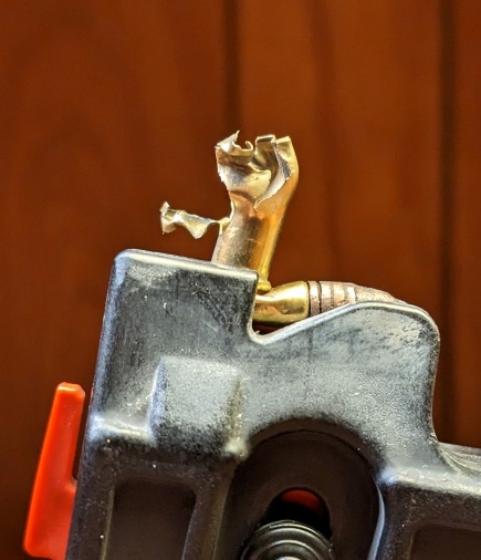

The mag looked something like this when I pulled it out. The shredded case was angled forward more & there were about 15 more rounds in it. The front of the left feed lip broke off, there's a small crack at the left rear that extends about 1/2" from the top, & the halves separated at the top rear.

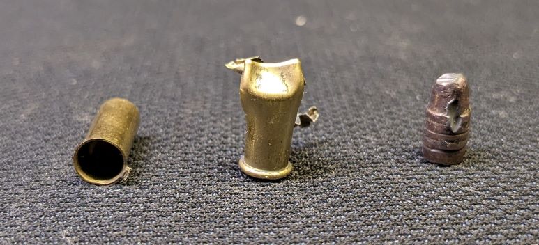

The next round in the mag.

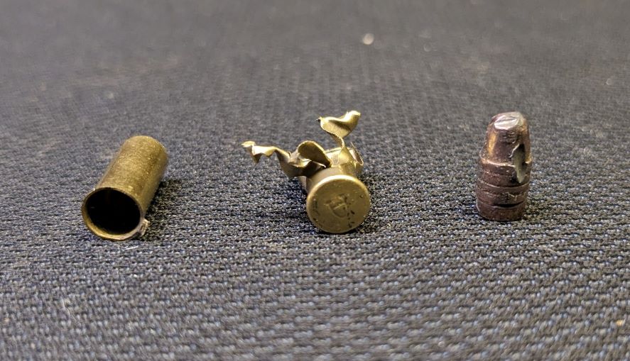

The offending ammo.
The only damage to the gun was a broken extractor spring. Replaced the spring & fired about 35 rds of the same lot number without issue. Two days later the rear of another case blew out (7th round of the day). Broke another extractor spring. I don't think I'll be firing anymore rounds from this lot again. On the day of the first kaboom/poof I fired between 160 to 165 rds without issue. 200 rounds prior to that without issue. So 2 rear of case blowouts out of about 400 of the same lot. Previously I've put about 1,000 rounds of 2 different lots of Super Extra through this rifle without issue.
