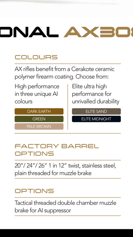

your AX308 comes with a 1:10 twist so it should do better with the heavies. The AT comes with a 1:12 twist. Why? I have no idea. Its pretty dumb. The barrels are interchangeable but I not sure any retailer is going to be willing to swap barrels off 2 new guns in their inventory to satisfy a customer. If there is, please let me know and I will buy it from them all other things being equal!
Not exactly. Mine has a 1:11.25 twist.
There is nothing wrong with a 12 twist, and AI uses them for a reason. That article is specifically discussing long range applications (1,000+ yards or so), and he's really splitting hairs with the twist rate. Yeah, when you look at F Class rifles (for example), your'e going to see some faster twists, heavier bullets, and the like. But you'll also see 30" barrels and longer than mag length rounds - because a .308 is mandated by the rules and practicality doesn't matter. The 12" twist makes a lot of sense when you consider a primary use of under 1,000 yards with magazine fed rounds. You're not going to be shooting 200 grainers in that case, and if you're really concerned about a dedicated long range rifle, you've chosen the wrong cartridge to begin with.
And for a little more context, there are a hundred things that matter more than an inch of twist. Buy with confidence and forget about it. Just don't try to feed it any 215 grain bullets.
My AI factory Lothar barrels are both cut at 18" and are 12 twists... i can say that i get faster velocities than the 10 twist Aina Bartleins and i have shot up to 190s and 200 Berger hybrids with 2000mr powder no problem. Dont waste $400 to get a 10 twist.

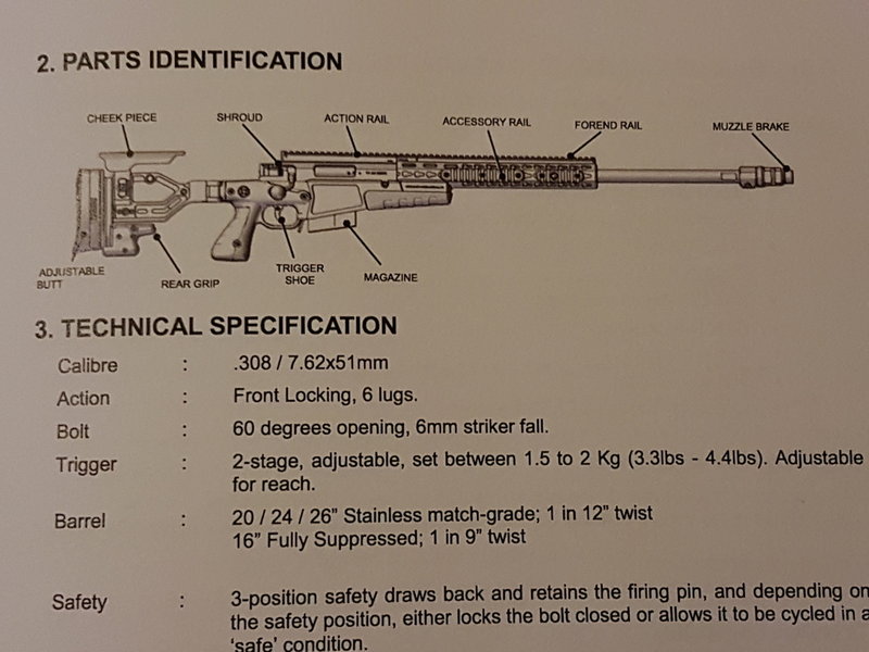

My AX308 arrived last month, and according to the owner's manual it has a 1:12 twist.
interesting. One thing I have learned is that anything is possible with AI. Unless im crazy i swear their catalog states the AX comes with a 10 twist. Who did you order yours from? Is it a current production rifle or old stock? Either way it will be a shooter. Find what it likes, feed it that and be happy.

The AX308 data sheet from both UK and US AI sites list barrel options as 1:12, along with the new colour options. Mine came from the UK, 20" with the new model fluted bolt and SFP (small firing pin). I also prior to purchase thought AX's had the 1:10 twist Screenshot_20170319-063212_zps9yytuafx.png . I'm not too concerned, its a AI, it'll shoot...
The AX308 data sheet from both UK and US AI sites list barrel options as 1:12, along with the new colour options. Mine came from the UK, 20" with the new model fluted bolt and SFP (small firing pin). I also prior to purchase thought AX's had the 1:10 twist . I'm not too concerned, its a AI, it'll shoot...
