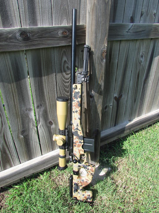

I have an AIAE MKIII and love it. I don't have any regrets, only that I should have bought one sooner. Accurate as hell, solid as it gets, and I believe it to be a value when compared to everything else custom or factory. I sold all of my customs and now only have the AI. I will likely end up with an AX also at some point.
Who did that camo? Is it a skin, dip, paint?
