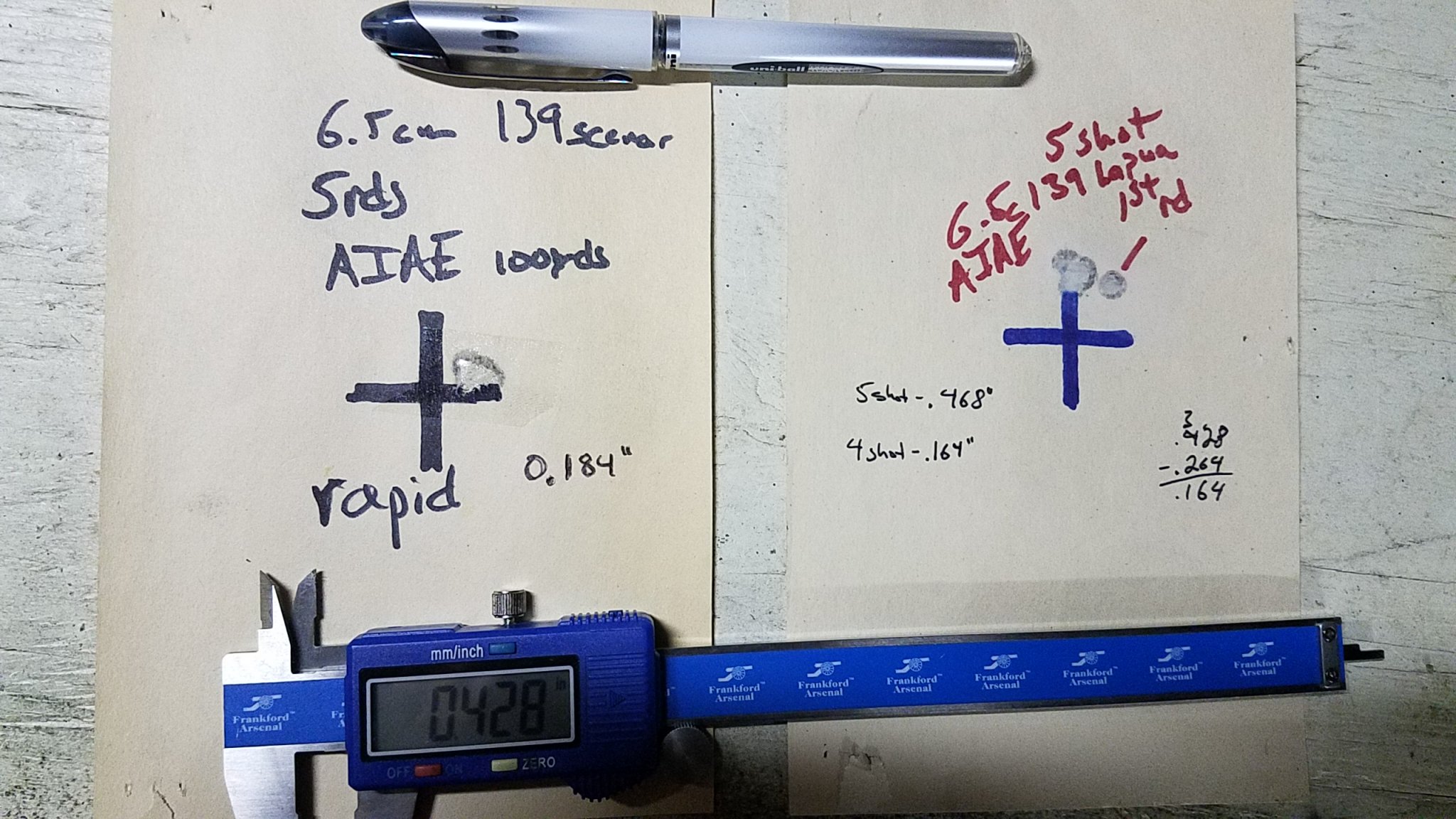

Just an FYI on running 6 Dasher in the AE, since I did that for about 2 years-- I had the best luck with PVA mag spacer kits, but still had to do a little feed lip tweaking on a couple of the magazines for the most reliable feeding. The MPA feedlip adjustment tool makes the job easy.
