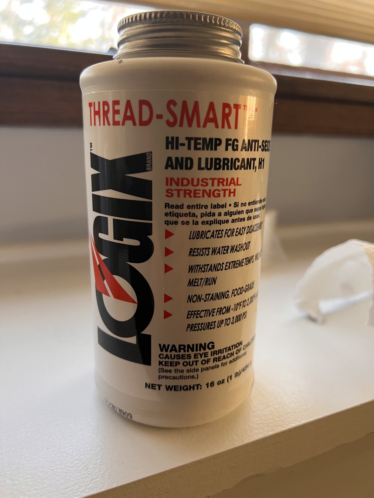

I had bought two little contains of it and when I ran out I found the stuff at McMaster, part 9438K1. To Griffin’s credit, they don’t hide the fact that they sell repacked tiny containers of the stuff, which is Lok-Cease 20/20. The stuff from McMaster has a slightly different name but it seems the same, and has the same specs.
Here is the stuff from McMaster.
