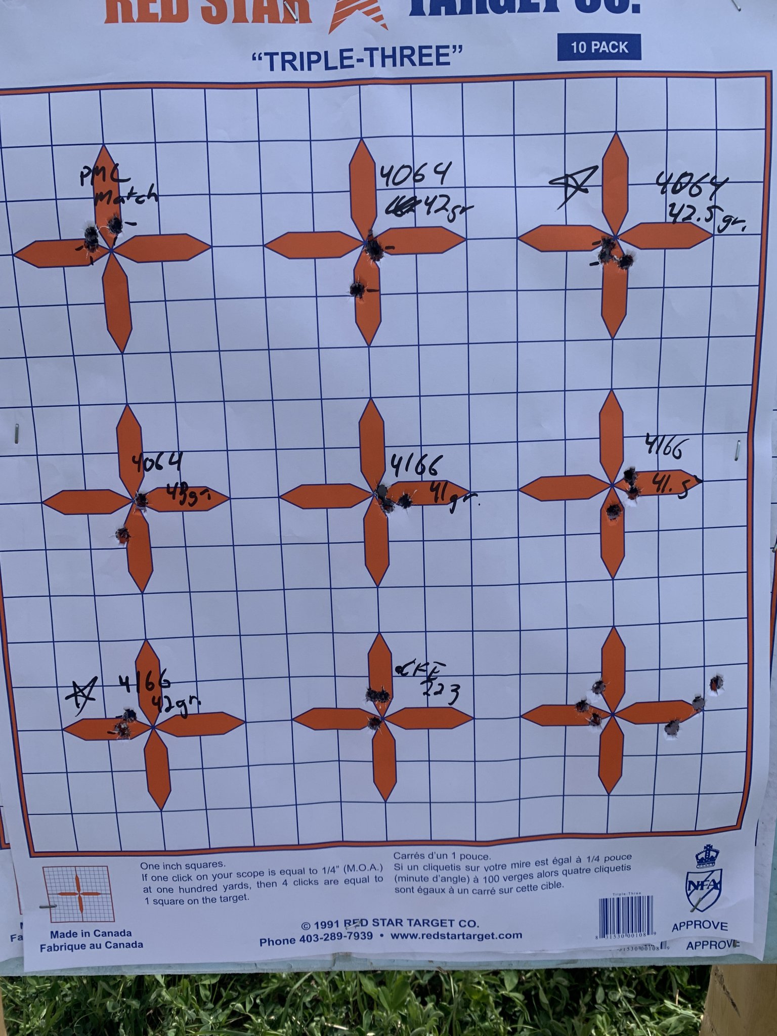

I had a 10 kmh diagonal wind while doing these so not ideal but I couldn't wait to try. Looks like they all did really well with the 4166 42 gr showing the most promise. CFE 223 was meh so I didn't even label it. I'll try some 5 round groups next. Needless to say I'm pretty happy with the result so far.
I did a couple 5 shot groups at 200 yds with 185 gr GMM and was shooting clover leafs so for back up I'll just buy a couple boxes of that as well.

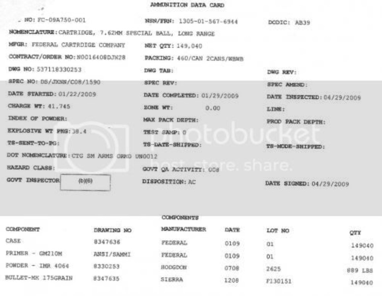

Just an FYI ... Federal Gold Medal Match GM308M2 that I have measures 2.790" COAL and a Base-to-ogive of 2.220". For my AIAX barrel, that's about 0.050" of jump. It shoots light-out. SMKs are notoriously jump-tolerant, which is why Uncle Sam uses the crap out of them for Match and sniper ammo. Every barrel is different and every chamber is cut a little differently. The SMK design is the most forgiving to these differences for DoDs purposes.
